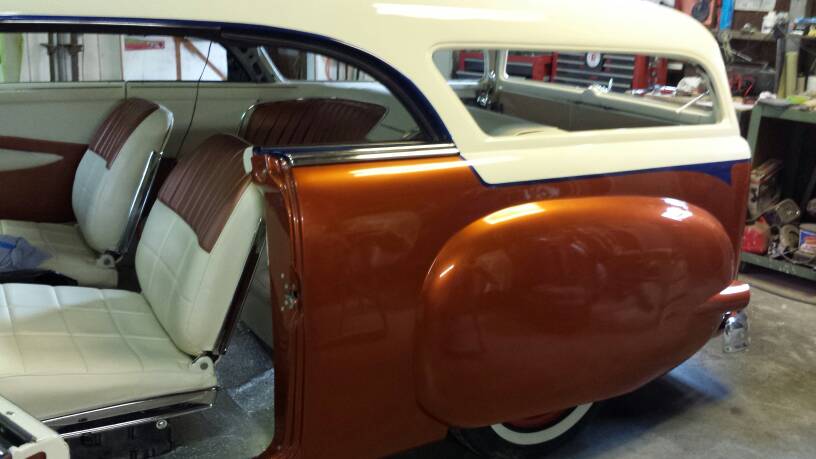

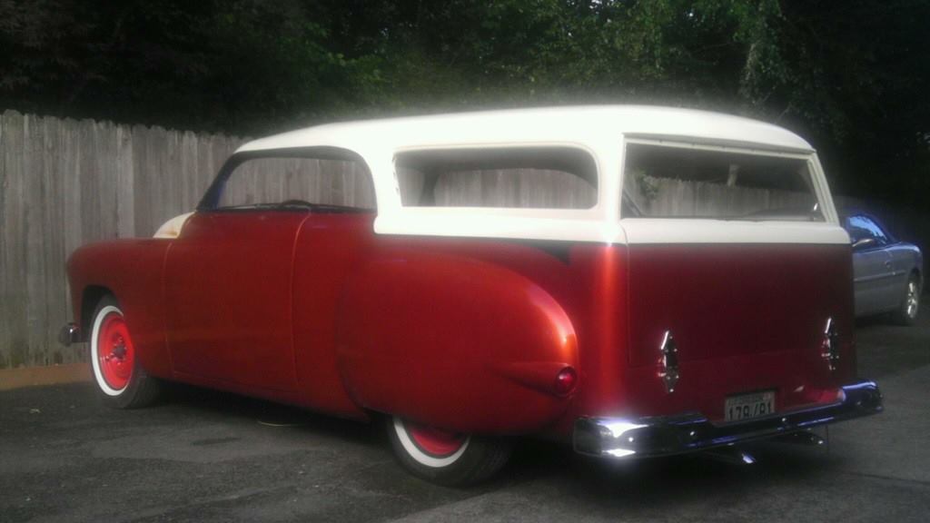

    I'll help you out and post a teaser photo since I stole them from your facebook post...

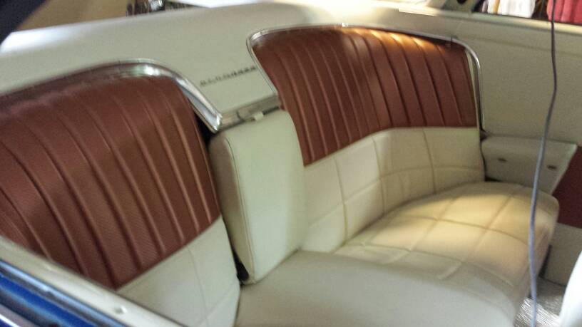

  3. Thanks sinister I was going for the new interior

    Make it work, he did!
    So did you, apparently. Great lines!

    LOVE IT!!...but how do the rear wheels come off/on? I really like the interior. What's it running?

    @ fleet-master; Jack it up, let air out of the tires, remove lug bolts and take them off. Have done this a couple times now, work well. Being a one off car I wanted to use a mopar running gear.. V-8's are overused in customs, and I am not a "More HP" type so I bought a 65 Dart, with a 225 slant six & small torque-flight even used the matching rear axle, (narrow enough to make the rear tires removable)

  11. What's the story on the front seats? HRP

    They also came from the Dart, still working on interior... need carpet, seat base, (added 2" in height so I could see out the windshield)trim, console... Bob
