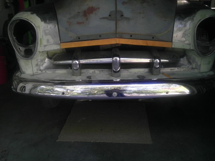

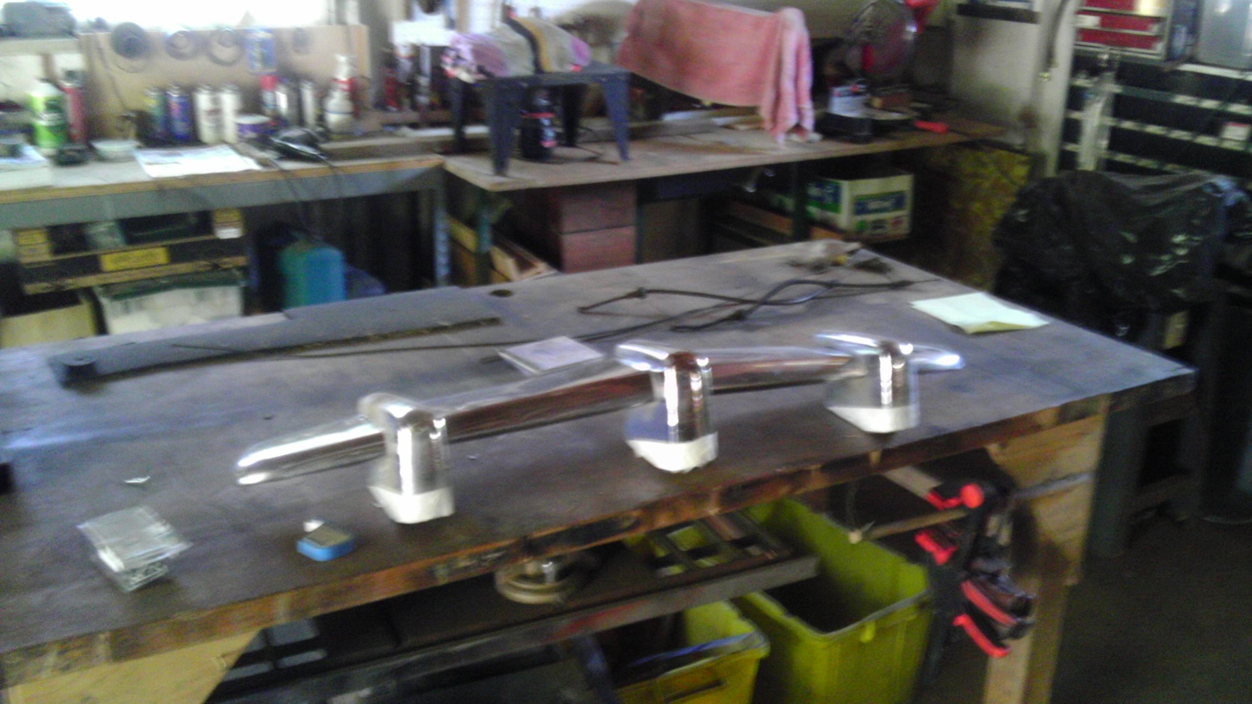

    Got the pieces for the Buick headlights made today, changing my mind on the grill opening, narrowing and recessing the 52 grill. I also decided to use the bumpers front and rear, I think it will make the car look longer and lower, which is the look I am going for. Keep you posted.
    Bob

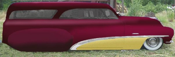

    The rendering is so dam great. Hope the finished project will be close.
    Now, the metalwork on the roof seems flawless, and im liking the front end....basically loving this :)

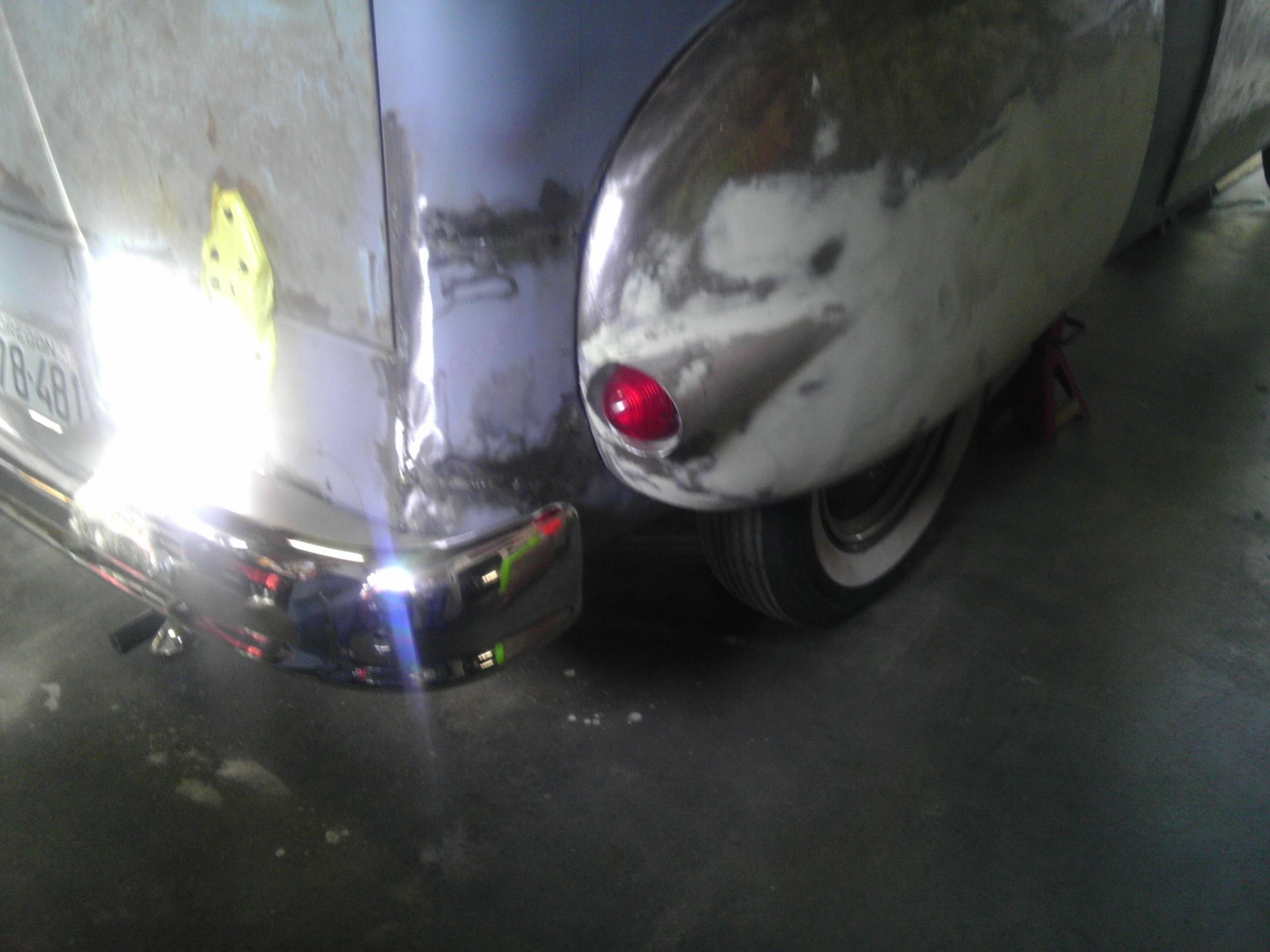

  22. just got another visit with Bob's Bevedere wagon. narrowed grill, frenched head and tail lights. bumpers moved in tight. grave shields
  23. What tail lights are they? That wagon is too cool.

    Not sure, but from that angle, they look like the taillights on my '53 Buick...which would match the '53 Buick headlight rings.
    Maybe the owner/P.O. can verify that.
    Jonnie www.legends.thewwbc.net
  25. I think you are right
  26. close but no cigars! 1956 chevrolet. Bob went thru hell deciding. in the end just made his own
  27. I started this project by using parts from three cars. Just fitting pieces together that almost fit. Bob is going thru sheet metal and making stuff from scratch. Spending very little compared to what most builds cost. I appreciate that he considers my original. Vision for the car. While adding his personal touches.

    The tail lights are 56 Chevy lenses with housings that I made from sheet metal and generic light sockets. The rear bumper is tucked to the body 2" then I formed sheet metal gravel pan to fit. The license plate is recessed 1 1/2".
