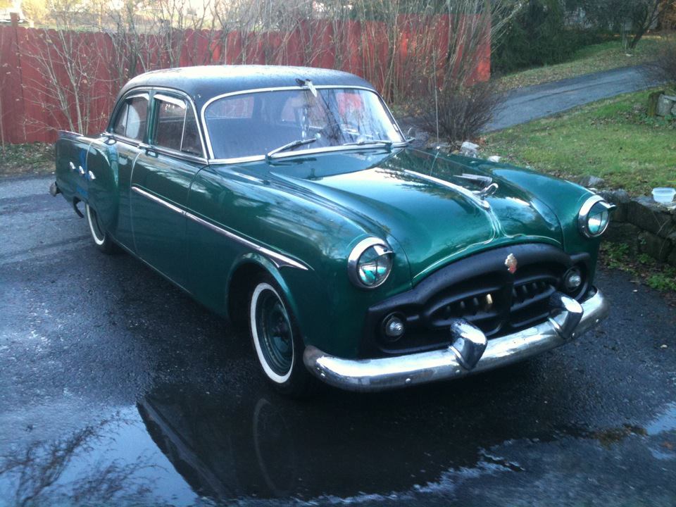

    Has anyone ever messed around with the Thunderbolt and Ultra Glide transmission? As of yesterday while she is in drive and at idle she makes a rattle noise .... I have a mechanics shop manual for her . After looking the whole transmission section over. No where does it tell you where to fill or check the transmission . Weird part about it is the noise goes away once you hit the gas . I was thinking loose exhaust . Any help would be appreciated.....

    That Packard is sweet man. These are so seldom seen and are really interesting cars. Proud of you for keepin it out there among the citizens. Good luck on your mystery noise. ~sololobo~
