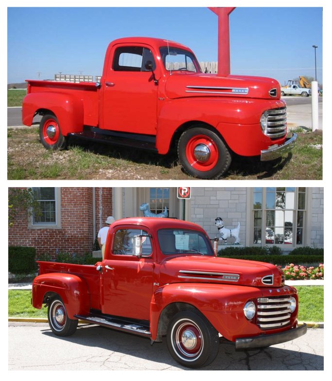

  8. Here they are side by side, you will need a large profile tile to fill the hole, 70 or 75 aspect ratio tire. the larger hole is over five (5) inches wider and the peak of the radius is taller. Don't forget 'free hats seldom fit'.

    Awesome response H.A.M.B. guys - comparison side by side is exactly what I needed to see ... appreciate the guidance.
