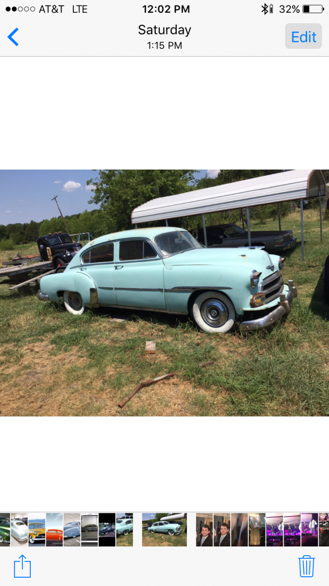

  1. Hello I have a few questions about my 1952 fleetline 4 door.
    Will a 250 inline 6 bolt right up? What about drive shaft?
    Also I bought some white walls and I think they're a bit big for the back, any suggestions on where to cut to be able to slam the back?

    When you say the driveshaft, can I assume that the whole center section is gone from the rear end? If not, does it have a rear end like, say, a Camaro, where there's a yoke for a universal joint? If so, someone has already swapped torque tube rear end for an open rear end. Confirm exactly what type of rear end you have and go from there.
    Pics would be a huge help.

    Maybe check the title and numbers ... there's no such thing as a '52 Chev 4dr Fleetline. The gravel shields are '49 -'50, grille & side trim '51.
    Show us the dash ...

    This one I came across from a fellow club member for real cheap and it is in decent condition but missing everything except for the rear end.
    What I have: I have a 250 motor with a 350 tranny, I want to know what I'll need to get this in? (Driveshaft other that torque tube?) (different rear end?)

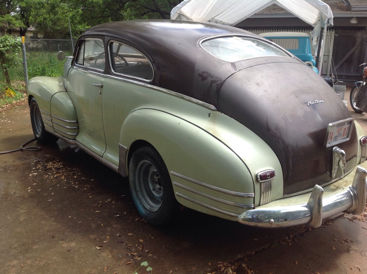

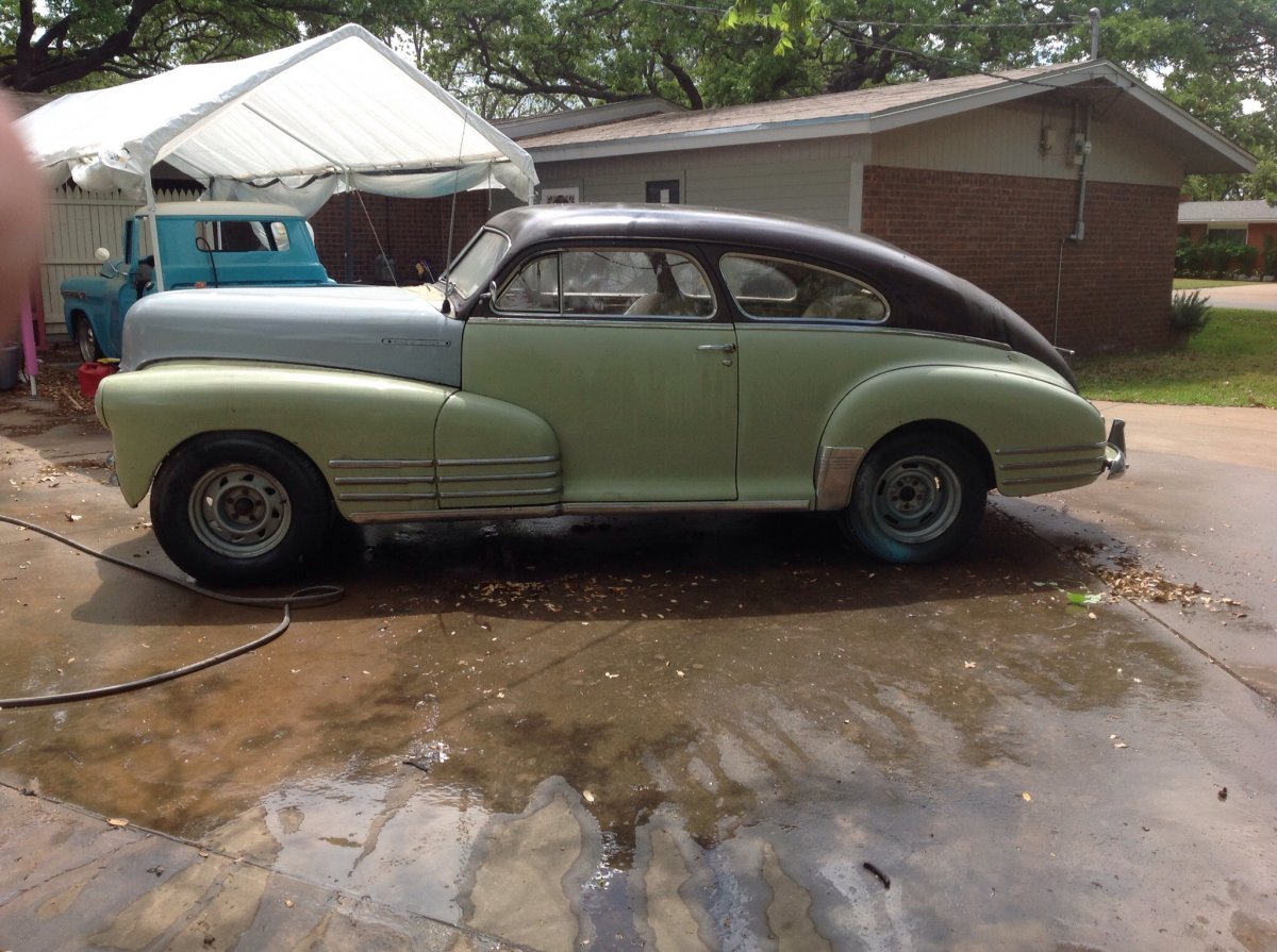

    I have a 48 Fleetline. I put a 250 and a th350 in it, along with a 57 chevy rear end. It was super easy, I did it by myself in the driveway. I don't know what reared will work best for your car, maybe a 55-57 chevy. Measure and see what fits. Some one here will know. If you go with an open driveshaft, you will have to have one cut to length, (easy), might even find one that fits. I used an early 70s chevy 6 cyl. motor mounts and made my own rear trans mount. Again, it was very straight-forward. Don't be afraid to ask questions. This place is a warehouse of knowledge. Good luck.
  21. You pretty much just described exactly what I want to do.
    Your 48 sounds like what I want.
    My buddy let me have a 3rd generation Camaro rear end and drive shaft. Wondering if that'll work, I'll just have to measure.
    Post pics of your 48, I love those the trim looks like it can cost a good penny brand new, so much of it lol

    Look it up in the for sale section. Has a 46 grille in it. 7k, in Texas.
