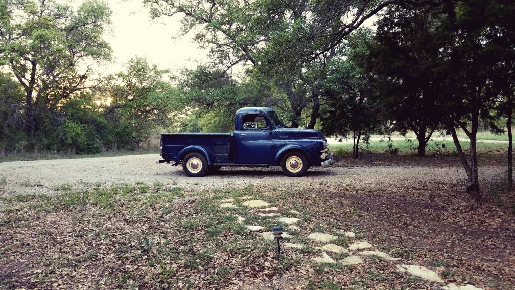

    Well, I'm diving back in...after selling my chevy a couple of years ago, I really missed it.
    I found this dodge truck, mostly orignal/older resto it appears. Going to drive it while I try to do some period correct mods/customizing...
    First up was fabbing up some brackets for the desoto tail lights i had laying around...
    Ill add more as I do more...hopefully i will end up with a slick custom..
