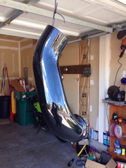

    No major progress lately, but I did get an air intake system made. I had planned to use some metal tubing, but for the size I needed, it was outrageous! So I found some thinner walled ABS tubing at the local Lowe's.
    This would be the "kit". I started by cutting most of the flanges off the pipes, just leaving the tubing itself.
    Next I cut a few straight pieces as needed, used ABS cement to join the pipes, then sanded the joints smooth. A quick coat of filler and then paint, and we have intake!
    It's a tight fit, but plenty of clearance everywhere.
    Any progress is still progress!

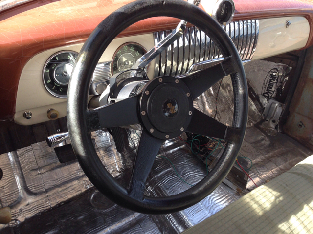

    Getting very close to 1st drive.
    Got the fan mounted.
    Transmission linkage made and working.
    Finally, threw some junk steering wheel on the new column so it can be steered. ImageUploadedByH.A.M.B.1422990374.730500.jpg
    All that's left is a DD steering shaft (on the way) and one rear tire ( have a toy tire on there for rolling around the garage). ImageUploadedByH.A.M.B.1422990465.711915.jpg

    Thanks, and yes, the paint scheme is figured out already. If you look at the dash picture, the car will be the brown on the roof, with the cream from the bottom of the windows down.

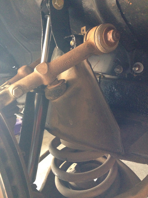

    Been working on front shock mounts. It's one of those things that I've put off for way too long, but I don't know why...
    Anyway, my issue was one of space, so I needed something very compact to fit the inner fender liner. I found some Speedway short shocks, and fabbed up mounts that bolt to the upper control arm mounts. Nice and tight, with just enough clearance.

    Been sick lately, so haven't had much time to work on the car. However, I did rebuild the front suspension with new control arm bushings, ball joints, etc.

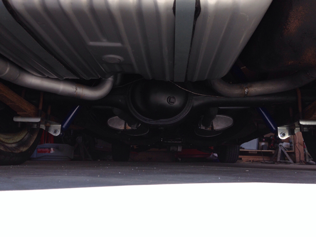

    And, I spent today building an exhaust system! It's quiet at idle, but makes a bit of noise at WOT, exactly what I wanted.
