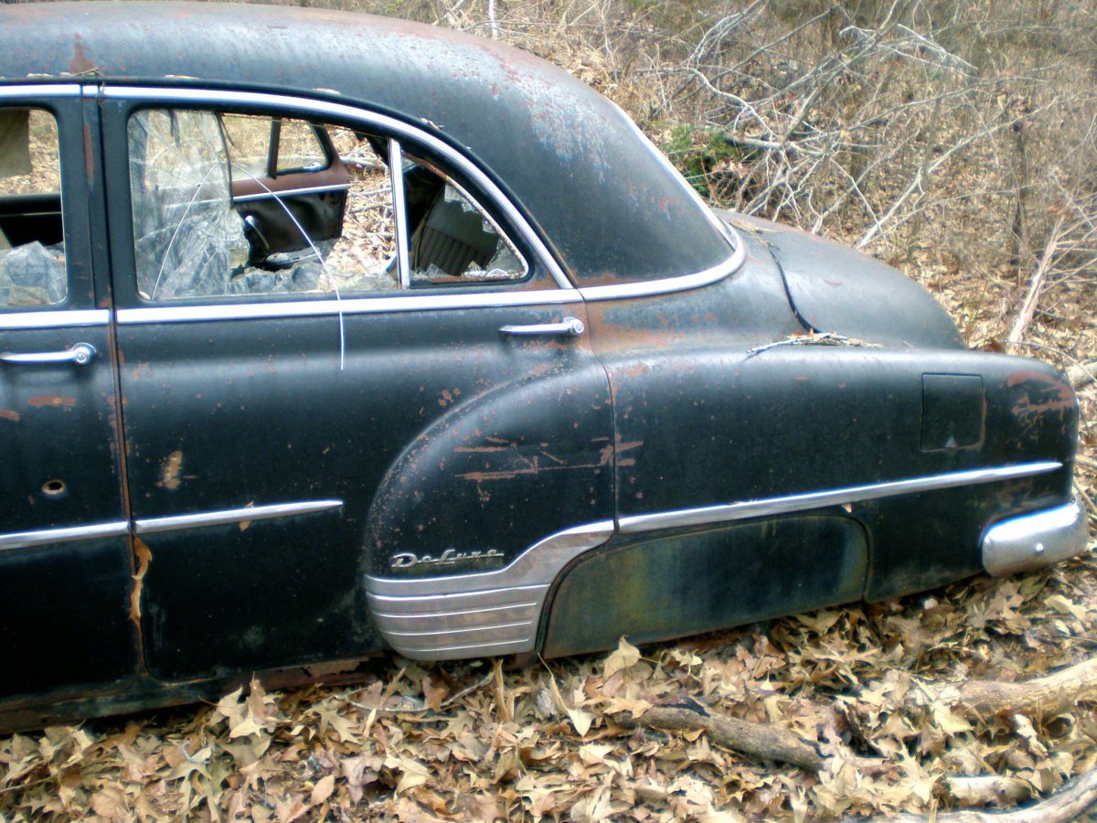

    Here's the scoop. I got a couple years back a 52 Styleline Deluxe that has been in the family since new. It was purchased in 52 by my Great Grandfather, it was the car my mom learned to drive on, and was retired in 66 when they got a "new" 64 Chevy. It was driven all around the Red Banks/Byhalia, MS area and then was used to drive around the pastures of our farm for the next few, until it was parked in Oct 1966 and forgotten.
    When I acquired it in March 2011, it still had the registration wrapped around the steering column, my Great Grandfather's galoshes in the trunk, and an old wool hat on the seat. Most every window had been shot out by various people throughout the years, but it was complete in every regard, so back to Memphis it went.
    Anyway, here are some photos of when it was unearthed:

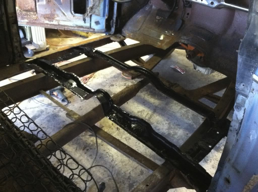

    So it needs some floor work...

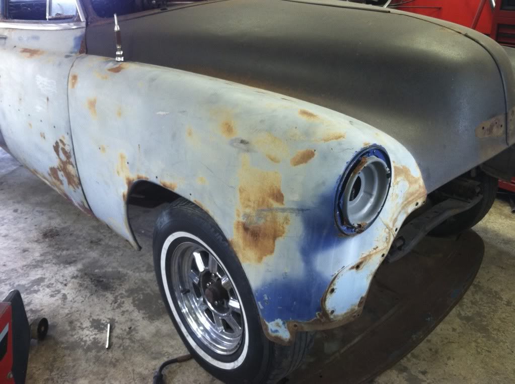

    So, I was lucky enough to find another 52 in the local Pull a Part, and managed to scrounge the doors, fenders, and deck lid from it. All my doors and fenders were rotten at the bottom, and the deck lid was pretty bad, despite the photos.
    Stripping paint from new trunk
    Test fitting new door and fender

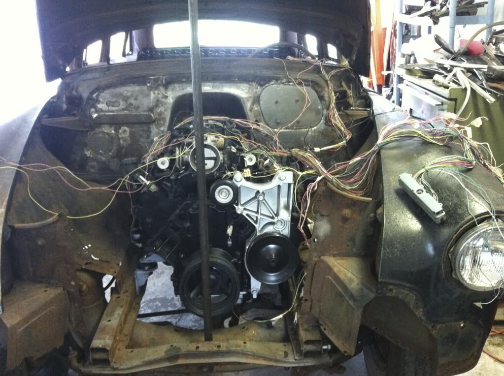

    OK, I know the engine isn't traditional, but my wife and I wanted something newer and economical, so a 2000 Chevy 5.3 was found and is getting mocked up.

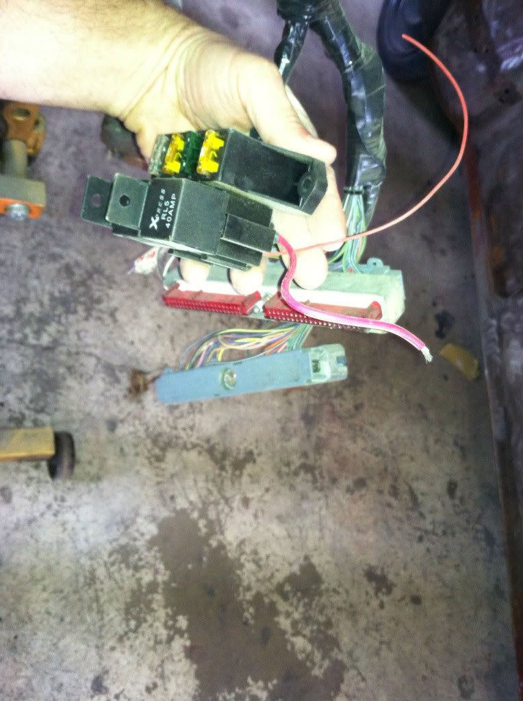

    I worked for 10 years at a company making computer chips for cars, so the fuel injection stuff is a no-brainer to me. Here's stripping out needless wiring from the harness.
    This is part of the pile of unneeded wires.

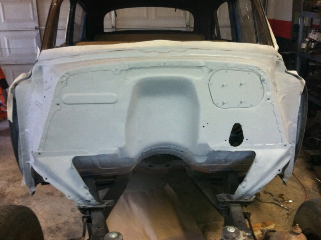

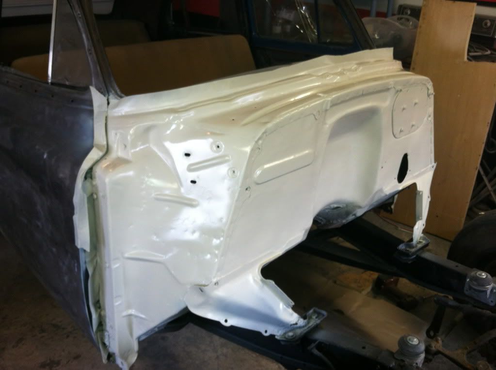

    I did manage to paint the engine in a traditional color
    Been cleaning up the inner fenders and firewall, getting them ready for paint. Once it's painted, then I can mount the engine.
    I'm going with a 2011 Kia Soul paint, color is Dune. It's a nice vintage looking cream. Here's some shots of the base/clear going on.
    I've also been working hard on the floors. From the earlier pics, you can see that it needed complete replacement. From the rockers in, everything but the braces got replaced.

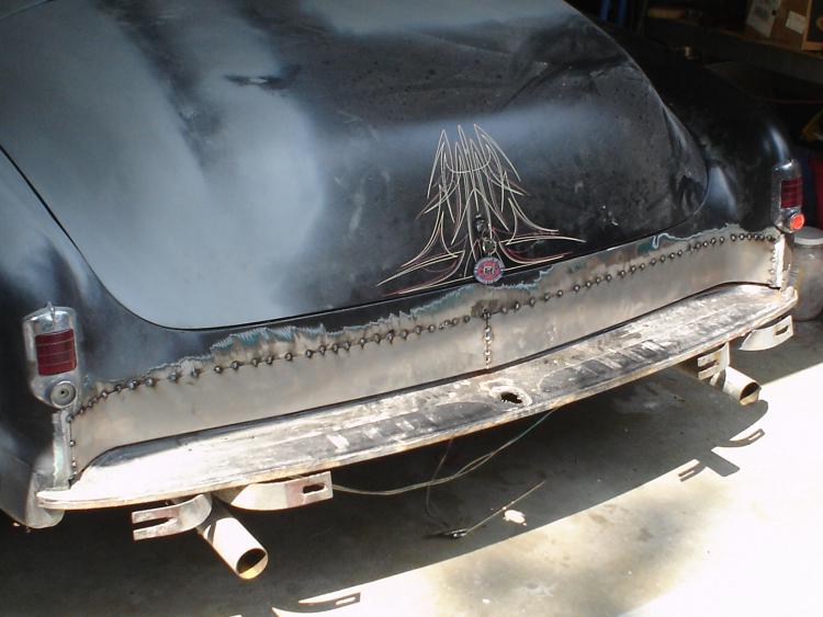

    And I've started on the bodywork a bit. Got one of the lower panels that was rotten.
    Although I don't have any pictures, the trunk floor was completely gone. Replaced with new metal, just need to get the rear step-down where it meets the tail pan fixed.

    I just bought these on ebay this morning. Search item numbers 220513402381 and 220513410102. They're sold by Nat'l Chevy (651) 778-9522. These are listed for 49-50. I think they will work on 52's too. Right side is part # 4681R, left is 4681L.
    Dave

    Engine looks good Sean. Wish I could have used my Corvette headers but they wouldn't clear the frame. Can't wait to see how you wire up the factory harness and ECM without an aftermarket terminal block.

    Thanks for the info on the tail pan pieces. Gonna order them today and see about finishing up the rear of the car.

    There is a site www.lt1swap.com that has complete how-to directions on modifying a stock harness. I added an aftermarket terminal block and relays for PCM power and fuel pump. So when I get ready to wire the car, the large red wire is B+, small red is switched 12v, ground is in harness, and fuel pump output. 4 wires and it's done.

    You make it sound easy! As much time as you've spent deep into EFI wiring, I guess it is for you. Cool.
