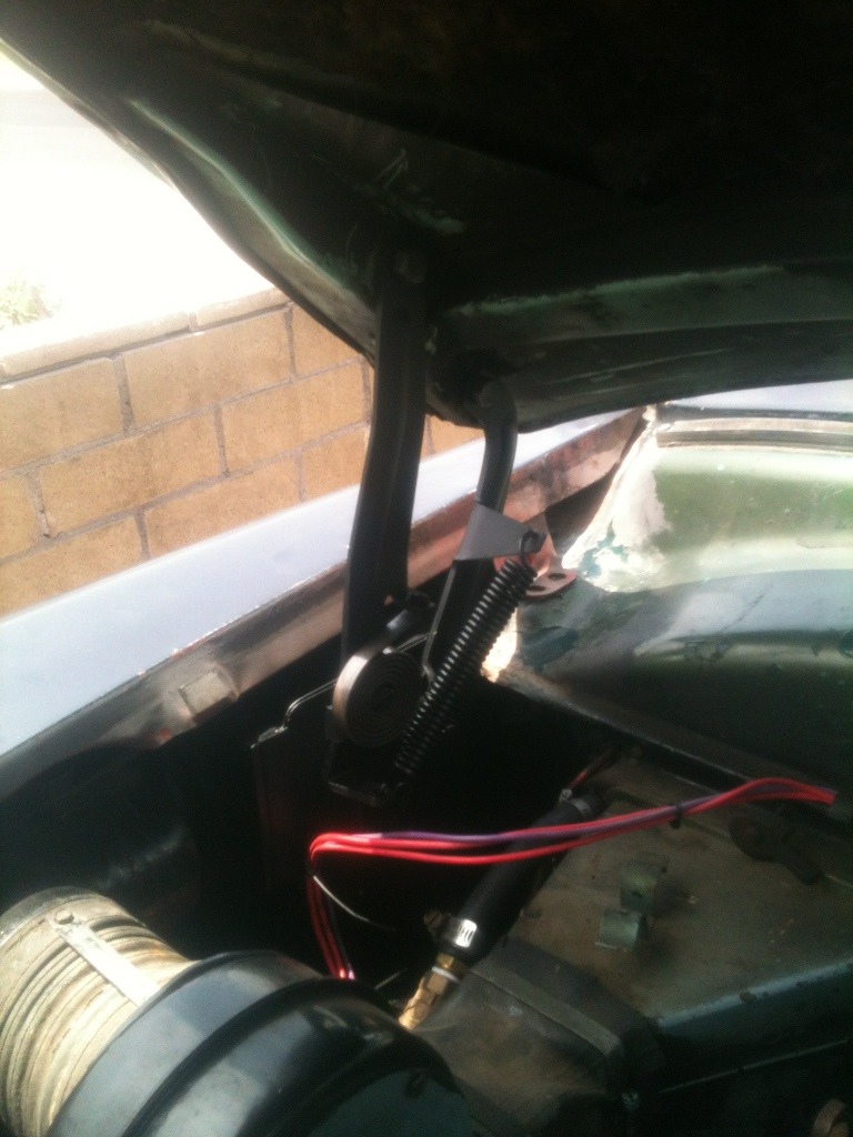

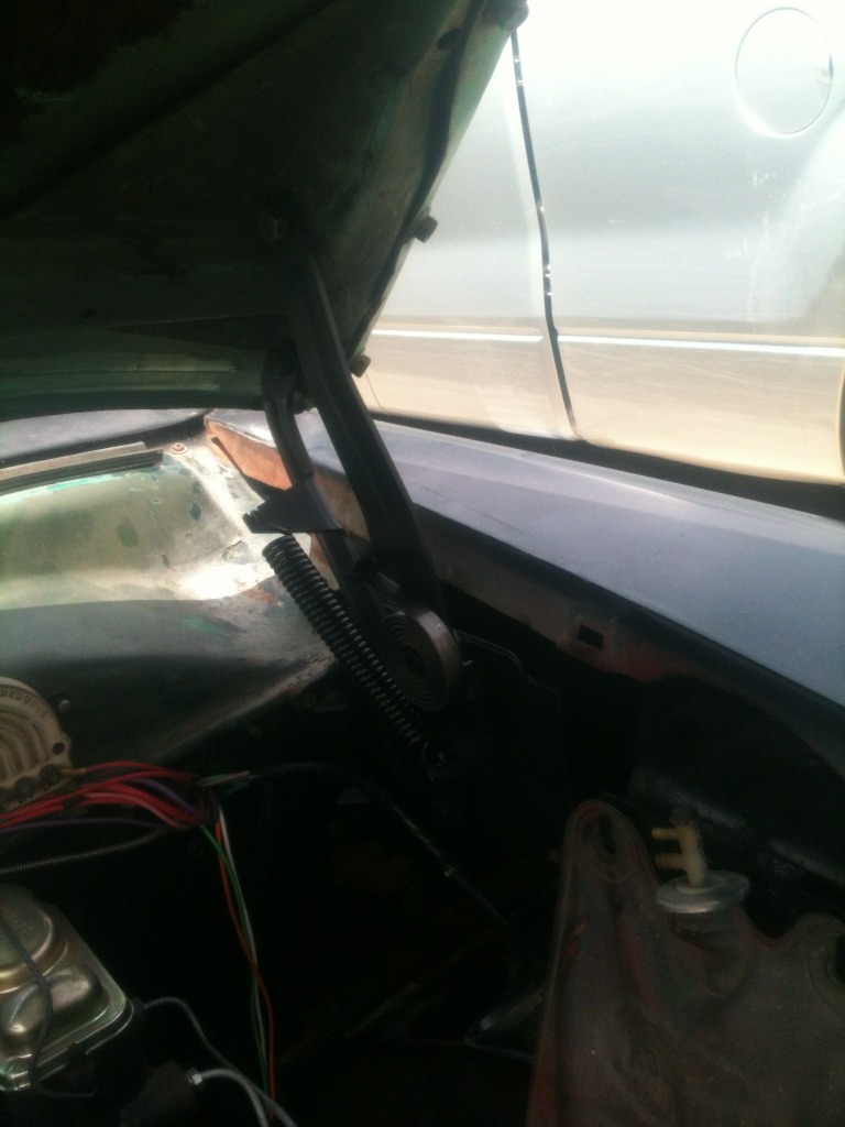

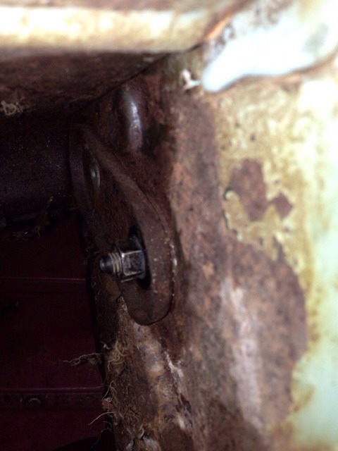

    Okay so I obtained A left and a right hood hinge. Both of them are in excellent condition. I have had a bunch of 53 and 54 Fords, but always lucked out and had spare is laying around. First question I have is comparing them side-by-side it appears that one spring is unwound one rotation. So what is the best method to rewind it. Second question I have is one of the pivot pins on the front hinge appears to be halfway sheared off inside the airbox. So what would be the best method to repair the pin? thanks ImageUploadedByH.A.M.B.1379546231.417734.jpg

    I would just use it if you are wanting to stay original... I think winding springs is one of those things that if you have to ask, you probably shouldn't be doing it.
    That said, if you make a tool that encases the spring on all sides with an opening for the hook end to stick out and put a long enough lever on it-- you could walk around it and hook it again. Make sure its bolted to a tree stump or something. Just an idea???

    As far as the spring winding I got a few ideas floating around. But the pin issue I have yet to figure away out that I am satisfied with. I thought of some fixes but I don't feel welding the pin from the inside or using some type of shoulder bolt would please me. I like things done right lol

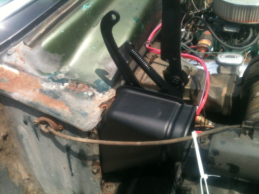

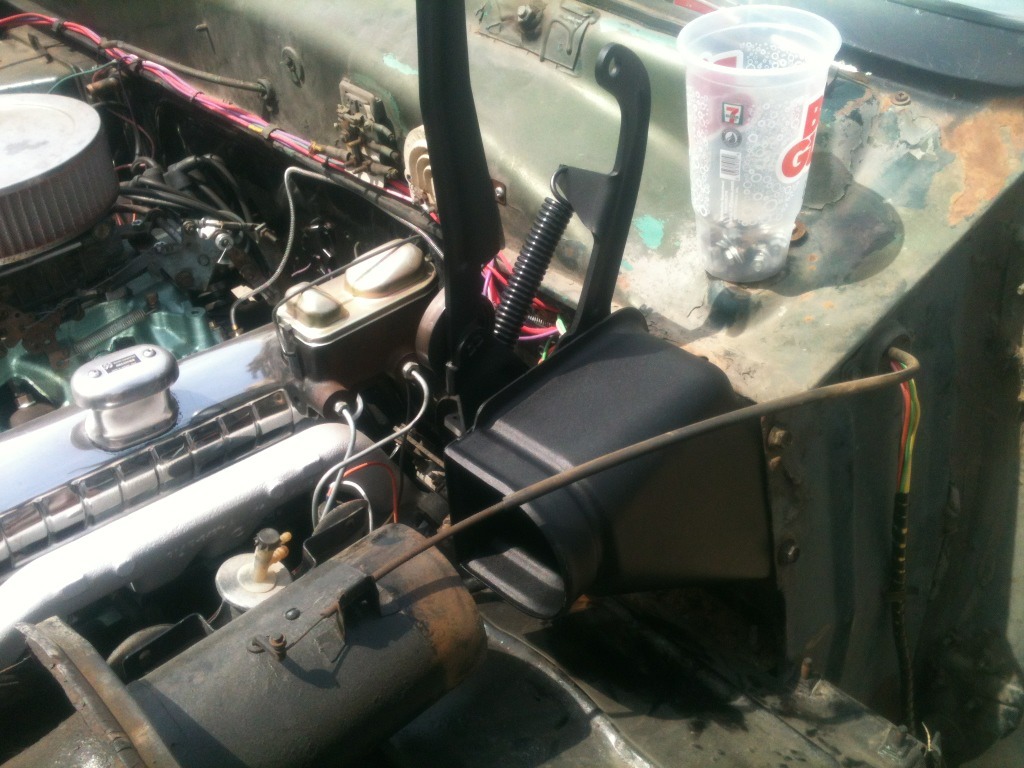

    Well here's what I ended up doing about the hinge pin. ImageUploadedByH.A.M.B.1379863755.764466.jpg ImageUploadedByH.A.M.B.1379863771.197615.jpg
    I found this carriage style bolt at work. But the shoulder on it is round instead of square. And fit perfect in the pin hole.
    Still trying to figure out how to wind this spring
