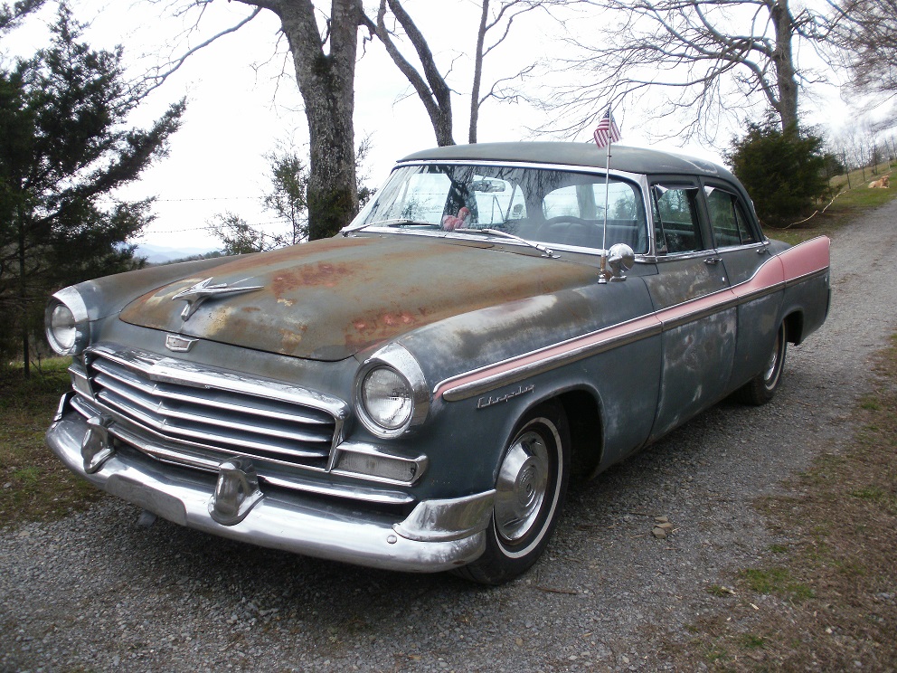

  2. I like the 4 door Chrysler Windsor too!My other one came with a visor.This one didn't. Bruce. 001.JPG
    bobss396, MyCrustyVW and OGWindsor like this.
    OGWindsor likes this.
