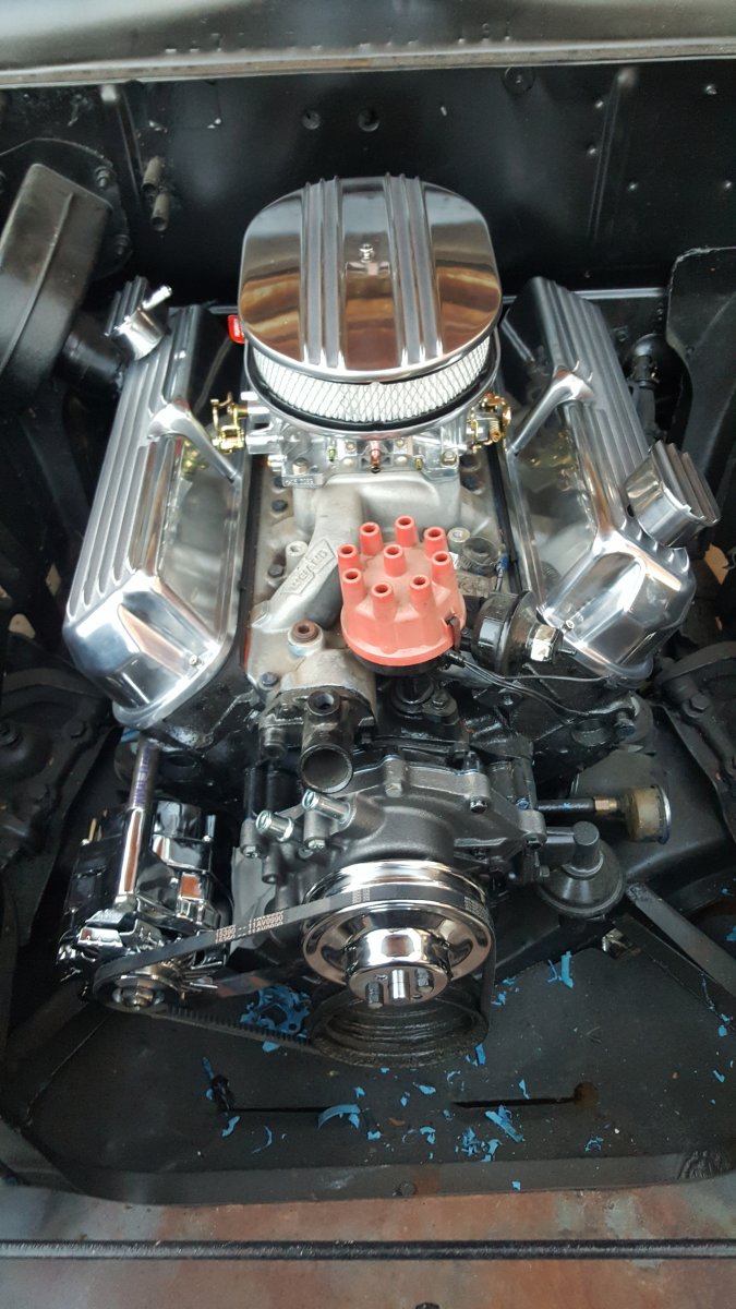

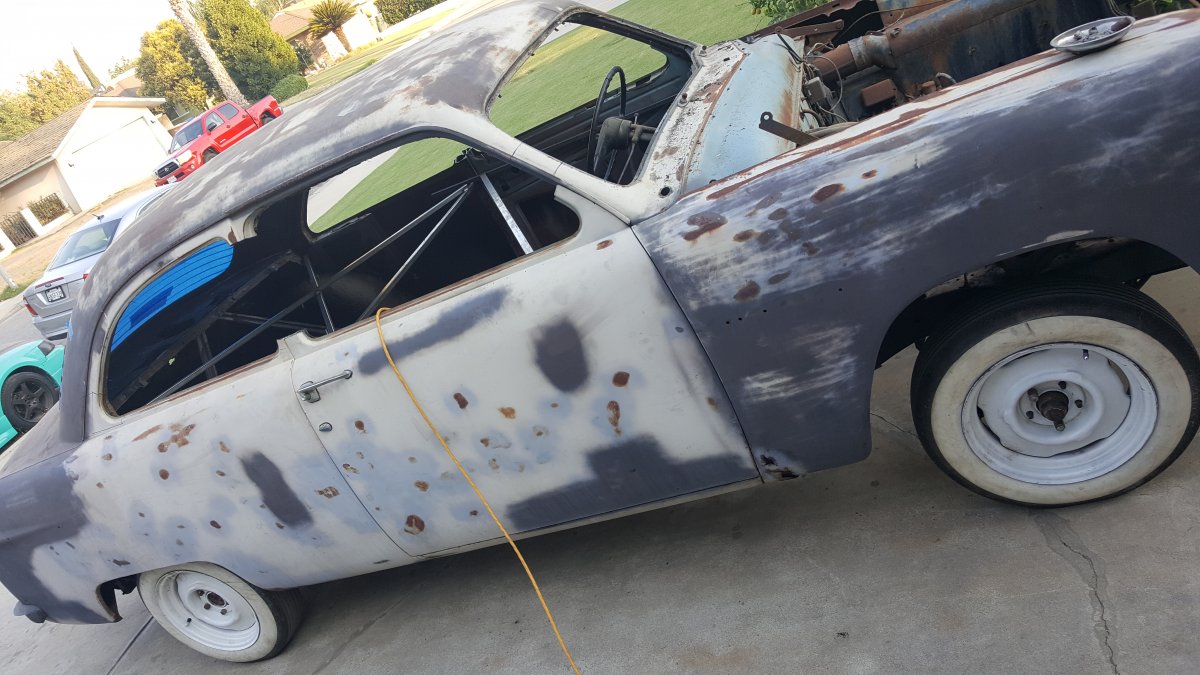

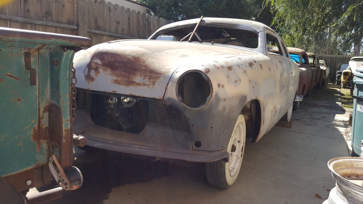

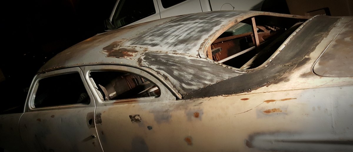

    Been away a while. Been working on my barbers 51 ford shoebox. Chopping the top, installing drivetrain, lowering the front and airbagging the rear. 20170621_200340.jpg
    The start
    Pulled the glass
    Fun begins
    Point of no return
    Test fit
    Angled pillar
    A lol different than traditional
    Driver side
    Engine and trans in
    Dropped uprights installed
    Starting the notch
    Notches done
    Aerostar springs in

    Holy Crap, you've been busy. Did you ever set the saws-all down to cool off? Love the chop and especially the amount of "B" pillar slant. Keep the pics coming.

    Haha. It's been a pretty quick project. The pillars were definitely the complicated part. I wanted to keep them thin so I started the angle above the belt line. I'll try to keep up on the posts.

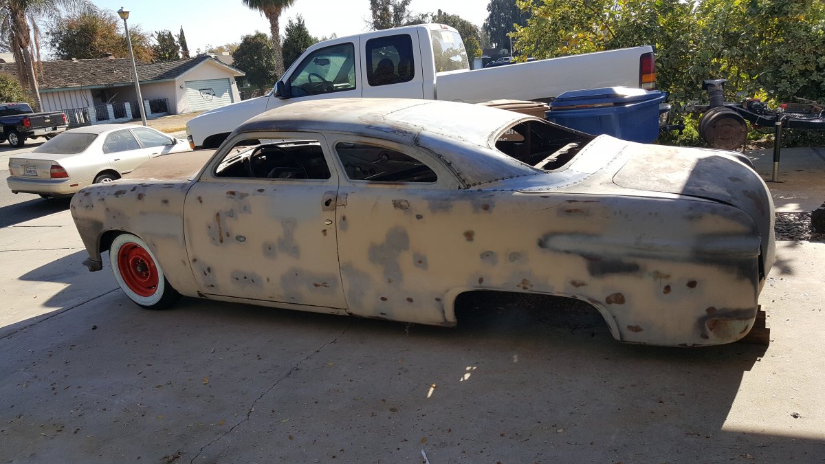

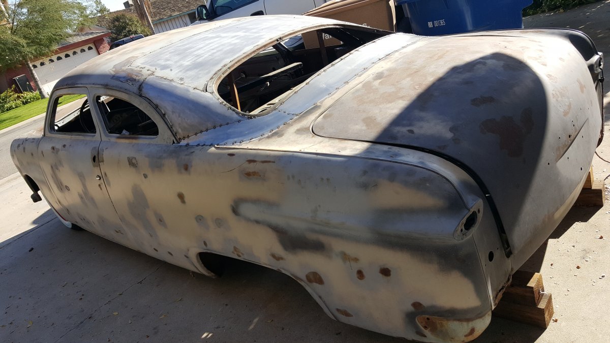

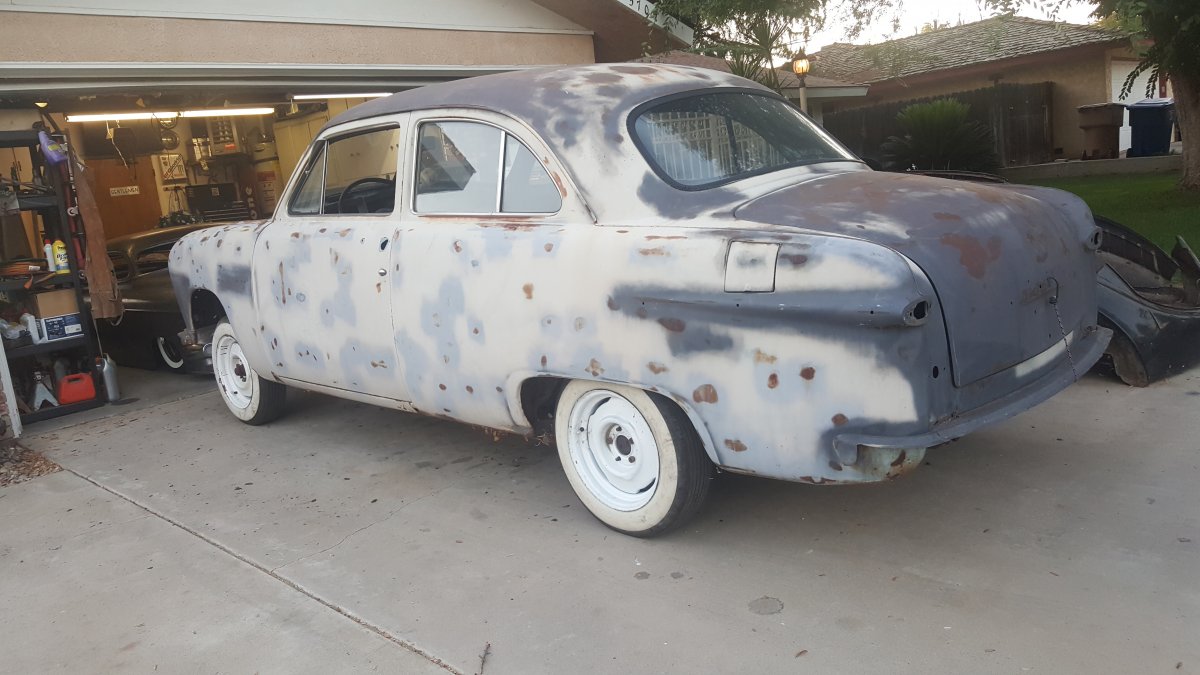

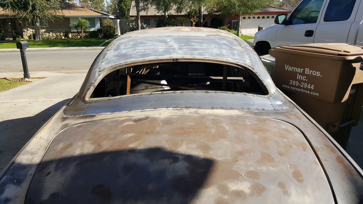

  17. royalflushcustoms
    Joined: Sep 3, 2013
    Posts: 140
    royalflushcustoms

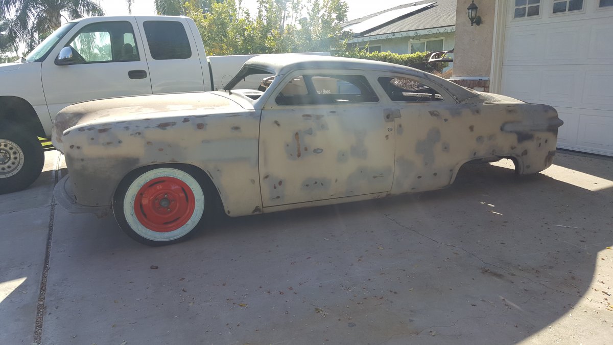

    Was able to get some daylight photos. 20171206_124523.jpg 20171206_124516.jpg 20171206_124509.jpg 20171206_124548.jpg 20171206_124538.jpg

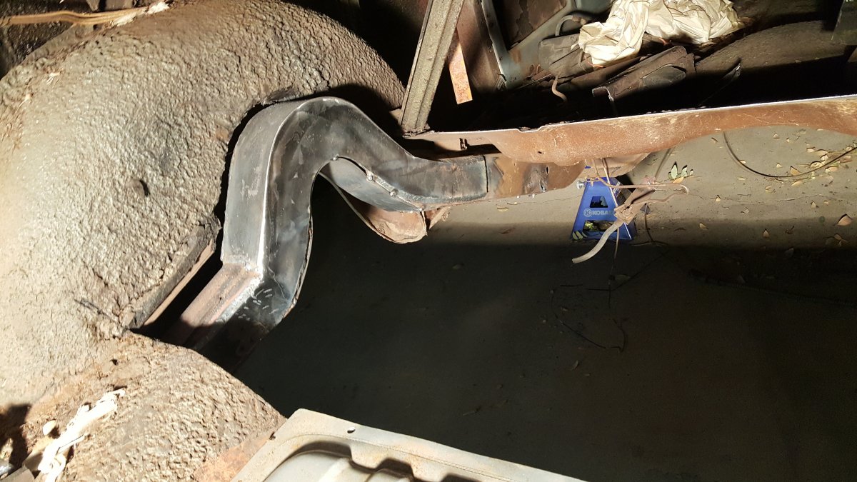

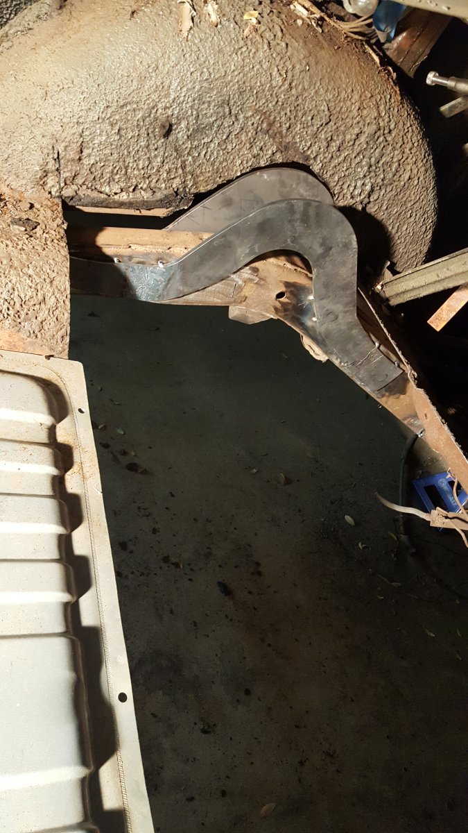

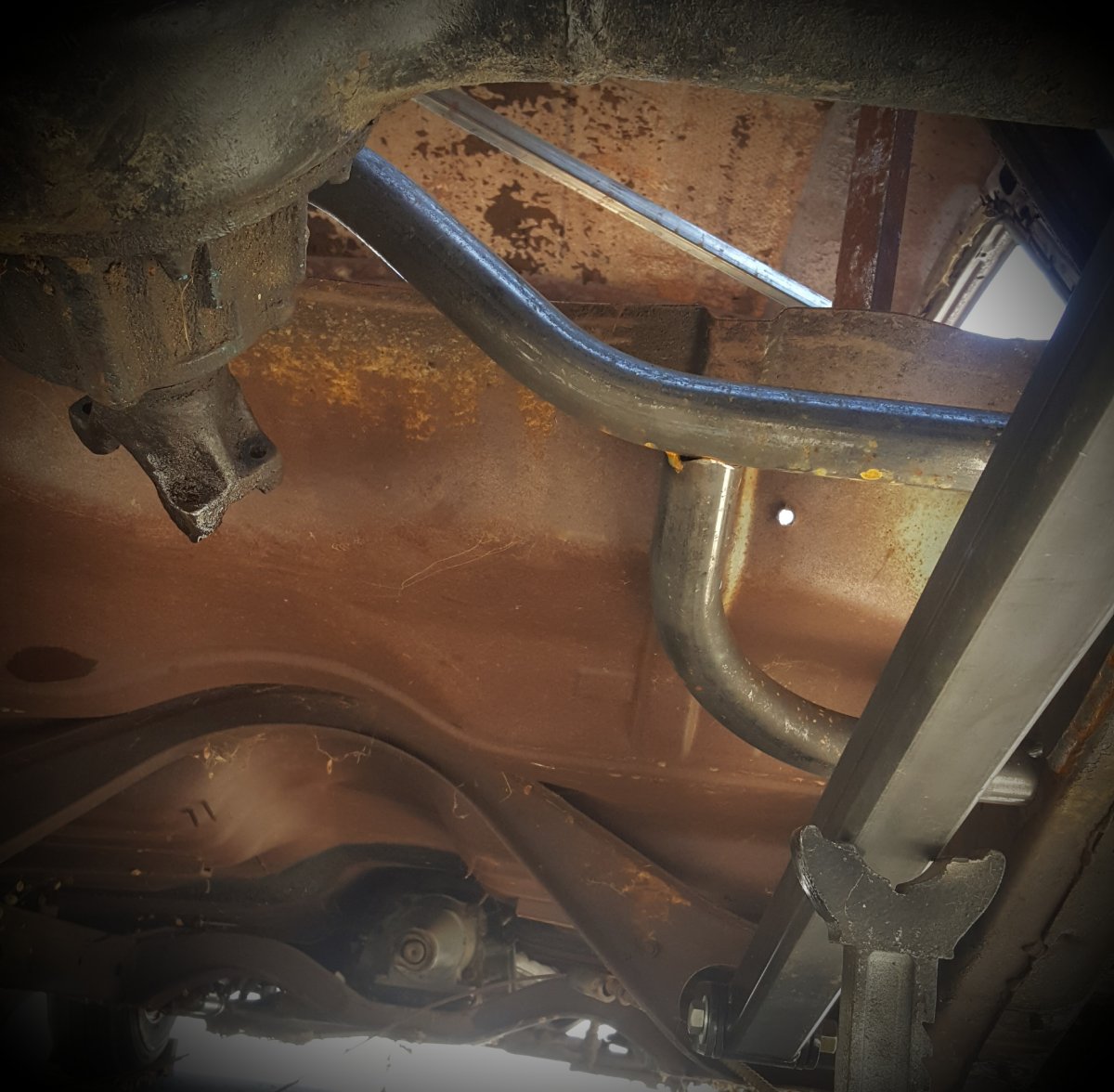

  18. royalflushcustoms
    Joined: Sep 3, 2013
    Posts: 140
    royalflushcustoms
    Getting the 2 link in.
    20171231_201740.jpg 20180403_212713.jpg 20171231_201847.jpg 20180321_205728.jpg

    Your lines are perfect especially the line about 2.5 inches above the drip rail love how that line runs down all the way to the bottom of the back window that takes some creative thinking cheers J

    Looks like a shadow to me?
  21. royalflushcustoms
    Joined: Sep 3, 2013
    Posts: 140
    royalflushcustoms

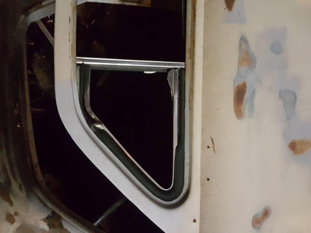

    Got alot done and still much to do. Got the rear 2 link in and convinced lumpy to bag the front. Got the front done and shocks in all corners. Got the wind wings cut down and now working on the garnish mouldings. 20180718_191424.jpeg 20181117_184123.jpeg 20181117_181720.jpeg 20181226_165123.jpeg

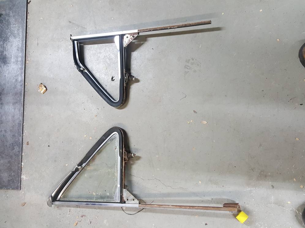

  22. Fat47
    Joined: Nov 10, 2007
    Posts: 1,222
    Fat47

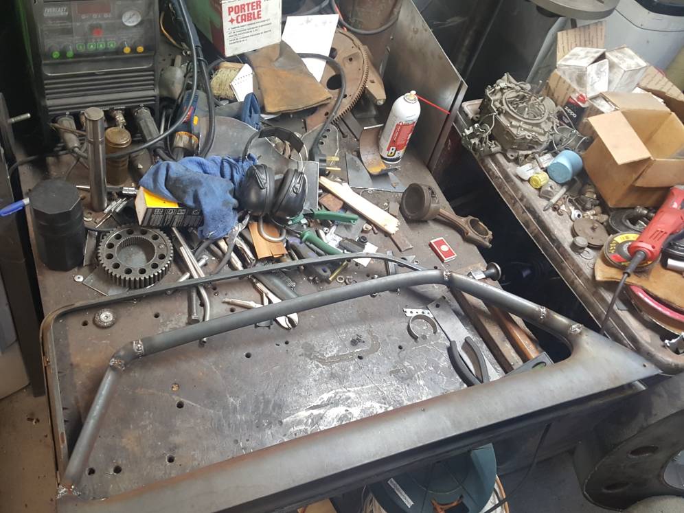

    Could you add some detail on how you did the wing windows?
  23. Great work and pictures. I think it’s just right. Once again, glad to have you back.
  24. royalflushcustoms
    Joined: Sep 3, 2013
    Posts: 140
    royalflushcustoms
    First I stripped it down. Pulled glass and stainless around glass out, pulled the rubber. Cut the top free and test fit. Trimmed the height then test fit again. Cut relief cuts in the perimeter to get new angle. Welded to top back together. I test fit again then mocked up stainless in the cut down frame. Marked where the new bend need to be. Then clamped in a VISE and heated the inside of the stainless to bend it. Lightly hammered the bend as it cooled then test fit and marked the excess. Then trimmed and reinstalled.

    Thanks for the wing window info. Any pictures of process. Great build.
  26. royalflushcustoms
    Joined: Sep 3, 2013
    Posts: 140
    royalflushcustoms
    Unfortunately I did not take process pictures.i was learning as I went. I'll be sure to do step by step the next time.
