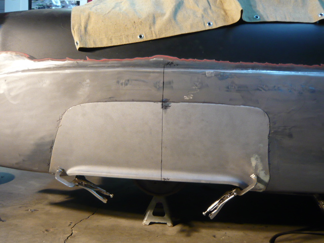

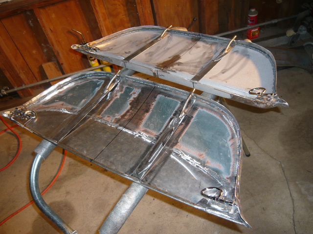

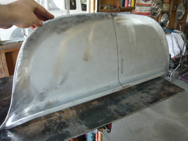

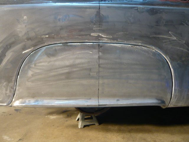

    Wow, thank you guys for all of the kind words! I'm off for the summer and making some great progress. I'm about 90% finished with frenching the skirts...passenger side is completed. Next up is rockers, floors, lower cowl, etc...then chop :)
    Thanks again for following the build,
    Rob

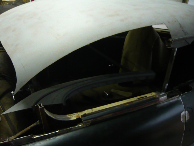

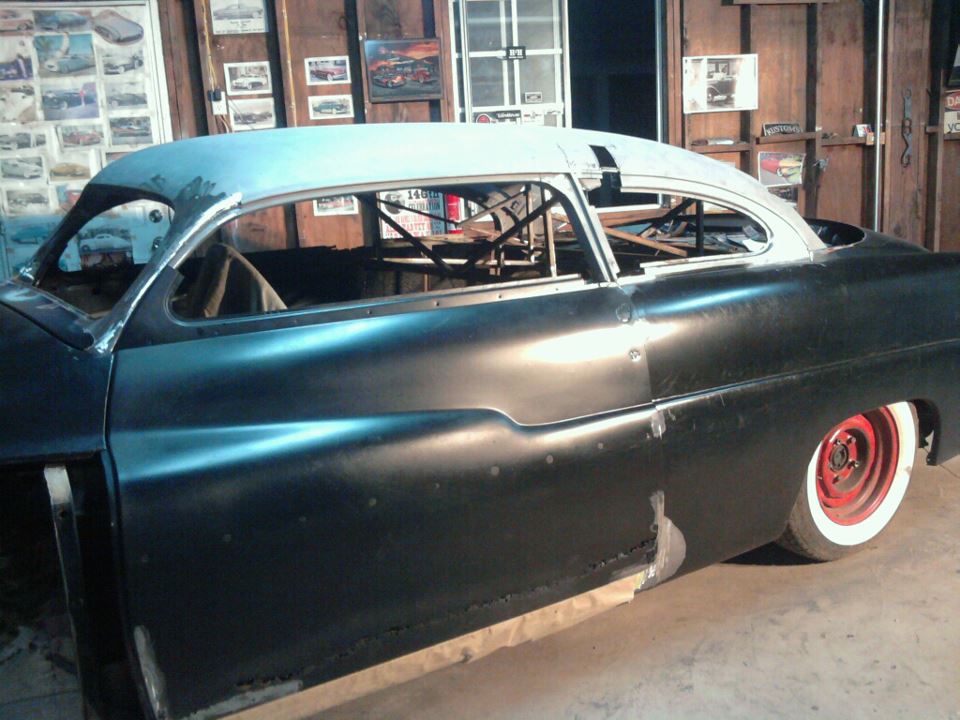

    Been working on the chop...a bit farther along than these pictures show, but here is the look we are after. More pics soon when I fix my compressor and make another big jump in progress :)
    Thanks for looking,
    Rob
  23. SuperFleye
    Joined: Jul 17, 2005
    Posts: 2,053
    SuperFleye
    Alliance Vendor
    Way to go rob! Looking good!!

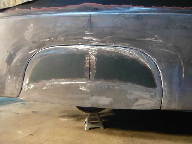

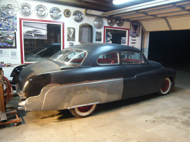

    Compressor fixed, back to work...here are a few more pics...more to come :)
    Thanks for the comments!
    Rob

  29. cretin
    Joined: Oct 10, 2006
    Posts: 3,066
    cretin
    Why did you cut out the top of the 1/4 window frame? Does that help eliminate the need to either relief cut, or replace metal on the roof above it?
  30. shoebox1950
    Joined: Jul 17, 2008
    Posts: 1,216
    shoebox1950
    Thanks guys!
    cretin, the quarter window area was cut separate and slid back to keep the openings their original length.
    Rob
