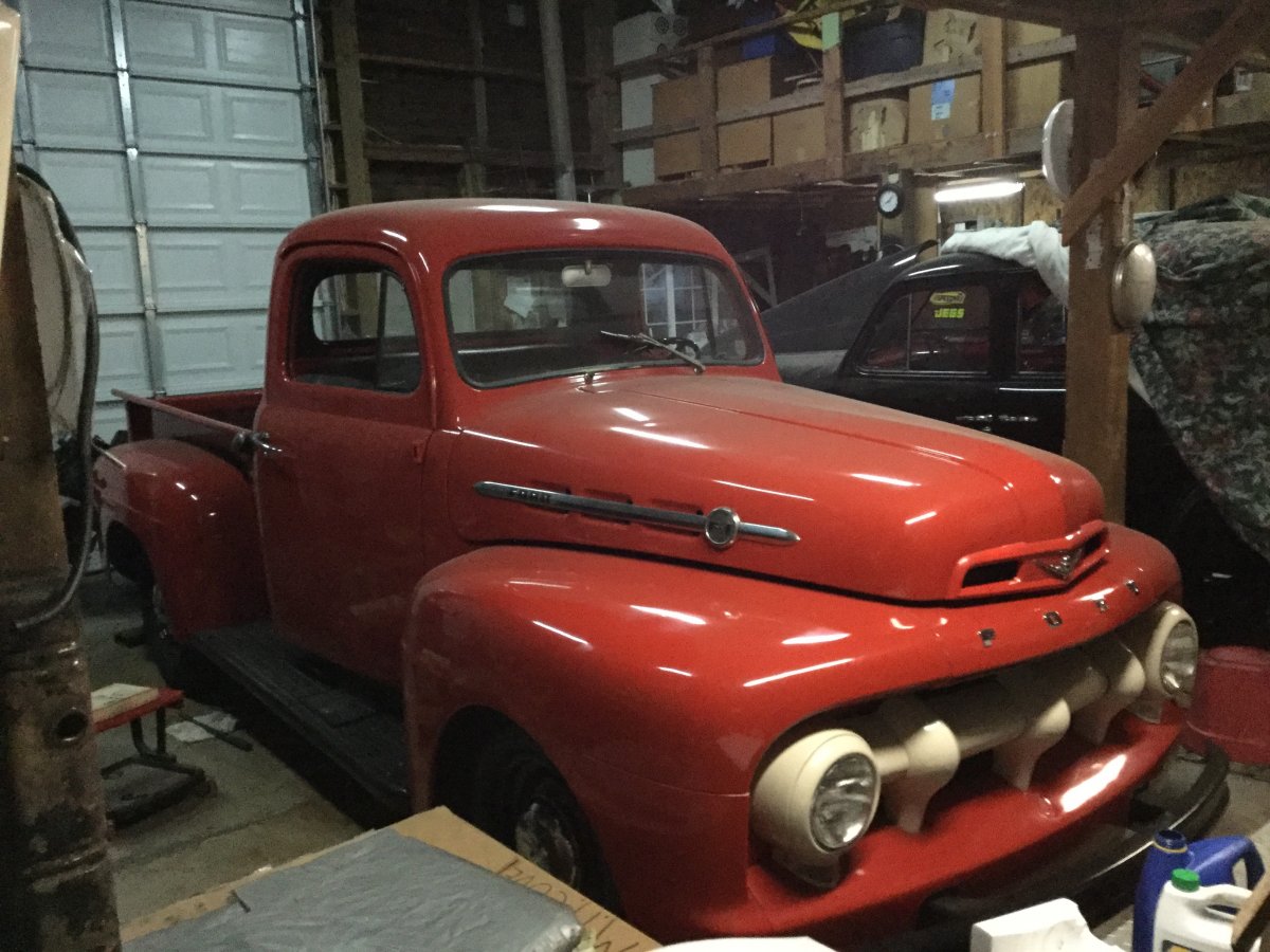

    1266A94C-B41A-4F54-B20B-A99C831060DC.jpeg My 52 uses a 3 inch dropped axle with stock width wheels. 7.50 x16 rear and 6.00x16 front. All clears and has a little rake to it.

    Wow, this is beautiful, great looking truck! Thank you for the info.
    Did you have to make steering modifications to accept the dropped axle?

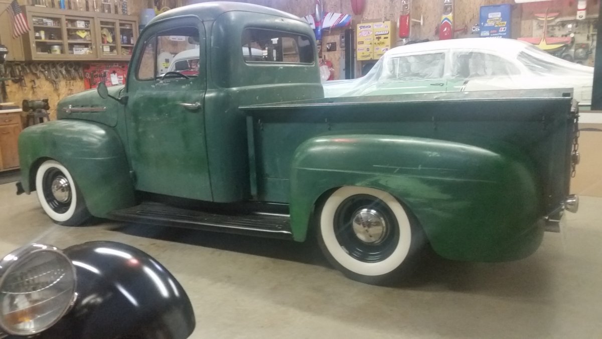

    This is the look I am after!
    What are you running for suspension?

    3” dropped axle on stock springs, posies superslides in the back with a 2” drop. 6.00x16 front 7.50x16 rear. Original 52 wheels power coated black.
