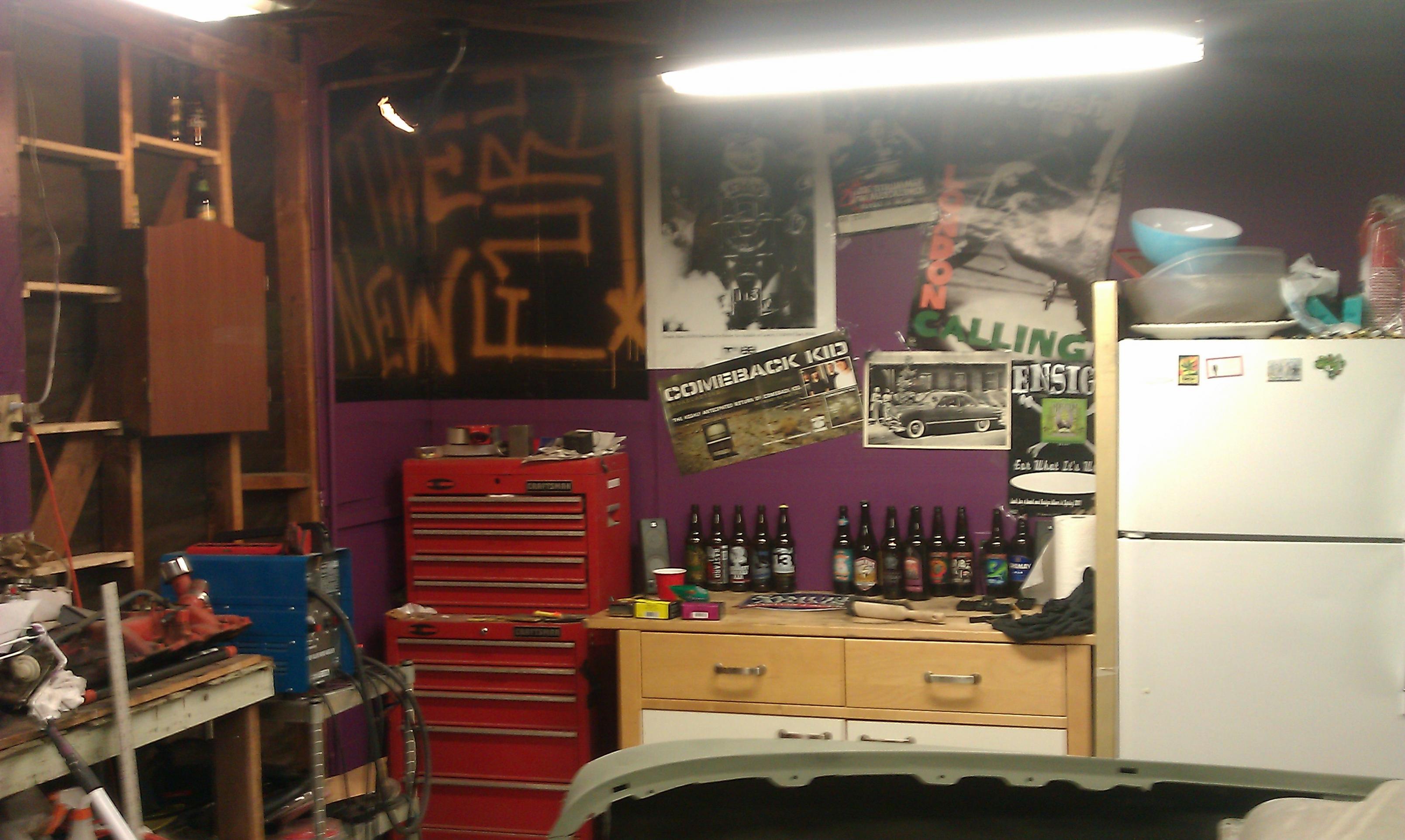

    Do to not working on it for a while and the "waterproof" "lifetime warranty" it was letting water in and trapping it. It has been an outside project do to room problems in the garage. Yesterday I took on sanding allot of it back down, following all rust veins. Treated the metal, and actually got my car in the garage.
    I will get it primed again this week.
    Still have to get more clutter out of there, and build some shelving and storage units. Money has been tight, and its a rental. I open to doing things but it comes out of my pocket.
  12. msalamanca
    Joined: May 25, 2011
    Posts: 526
    msalamanca
    I know its not much.
    But with it in the garage now, things are so much easier. The amount of prep and tear down, as well as making sure things are locked up, and the work isnt left undone or metal showing.
    Removed the windshields, was happy to find no rot.
    Cleaned out the inside, brushed it down, shop vac w/soft brush to see what has been messed up, get re reacquainted with her
    I cant say enough how nice it is to have it in the garage.

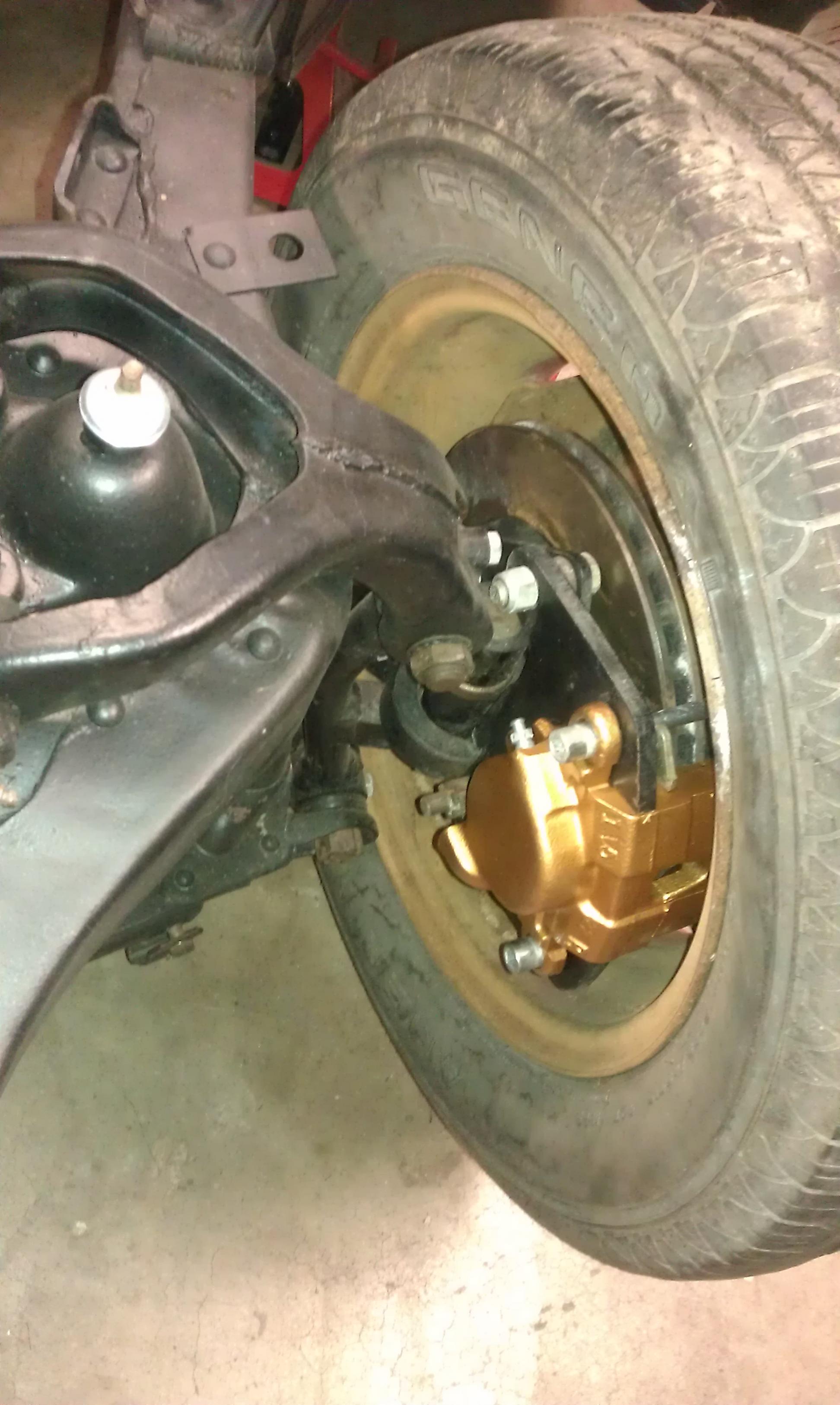

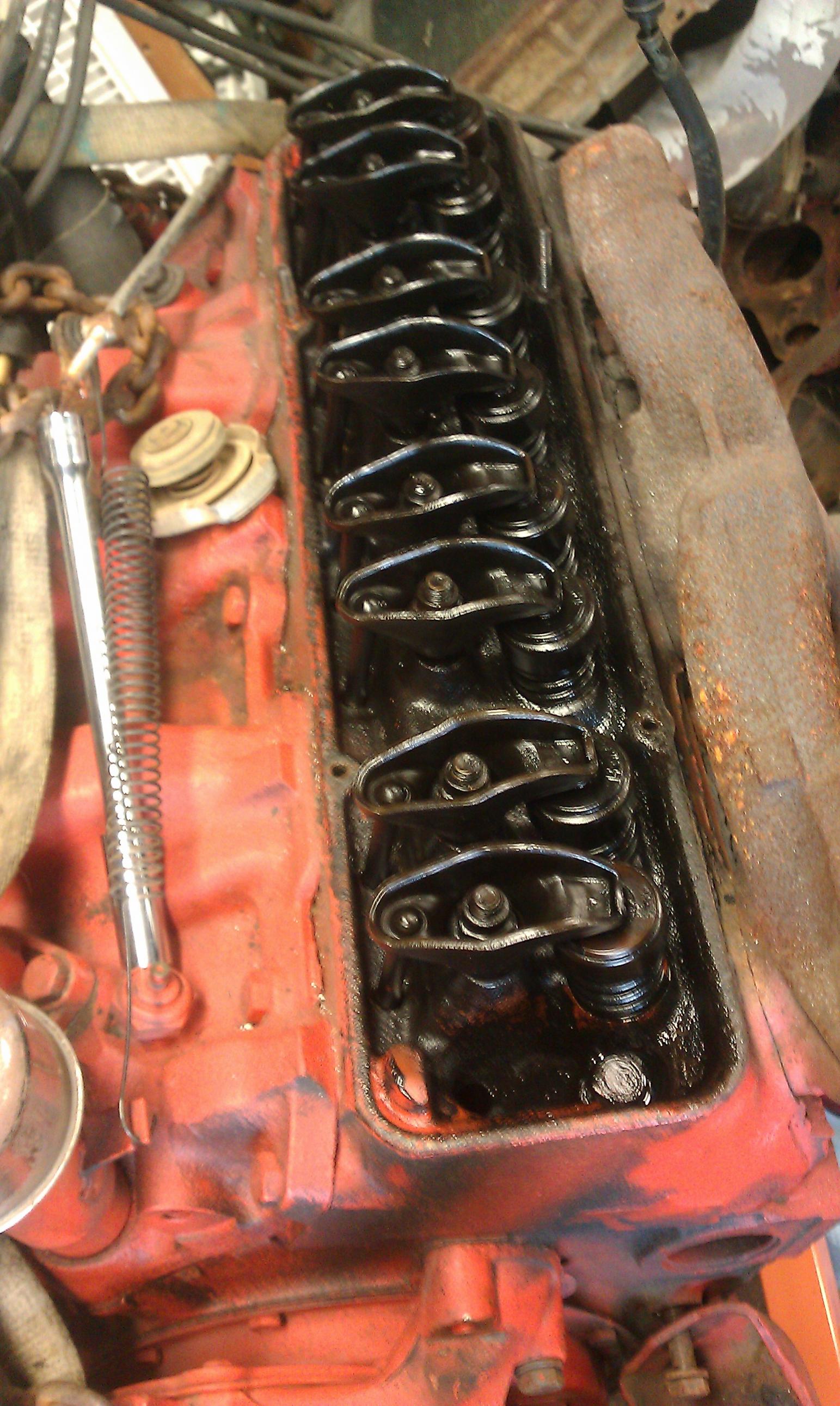

    Havent done much this week. These are some from last weekend. Got the 283 on a stand. Everything looks pretty solid with it. Looking for the Oil pan. I wanted to use the Ford 3 speed w/OD, need some opinions on if I should mate the two or keep the Chevy trans? The trans has a hurst shifter set up. What do you guys think?
    Took most of last week fixing up the garage and organizing things.
    I did Get the front cowl taking down to bare bones and front window seal.
    Also I filled in the Windsplit spear holes.

    I can't remember, but what's the Chev trans? If its a 4 speed or a TH350 do it, but if its a Power Glide keep the Ford trans. At least thats what I would do. Hope the ankle is improving bro!

    I couldnt find any numbers on it, I am going to degrease it tonight and see. There is a pretty good build up of grime on it.

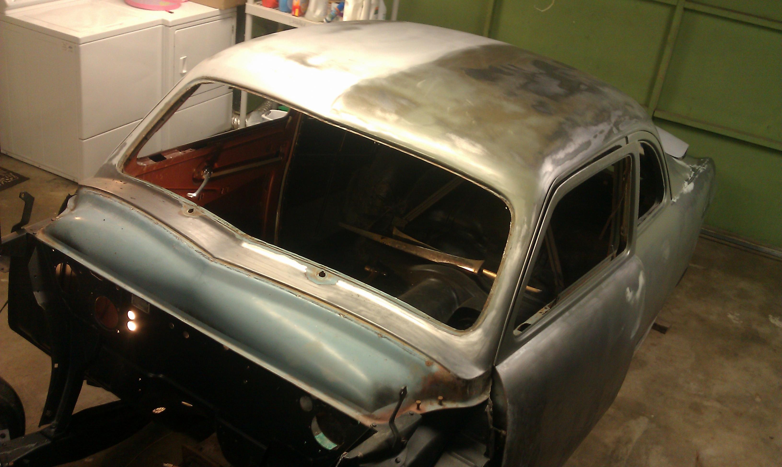

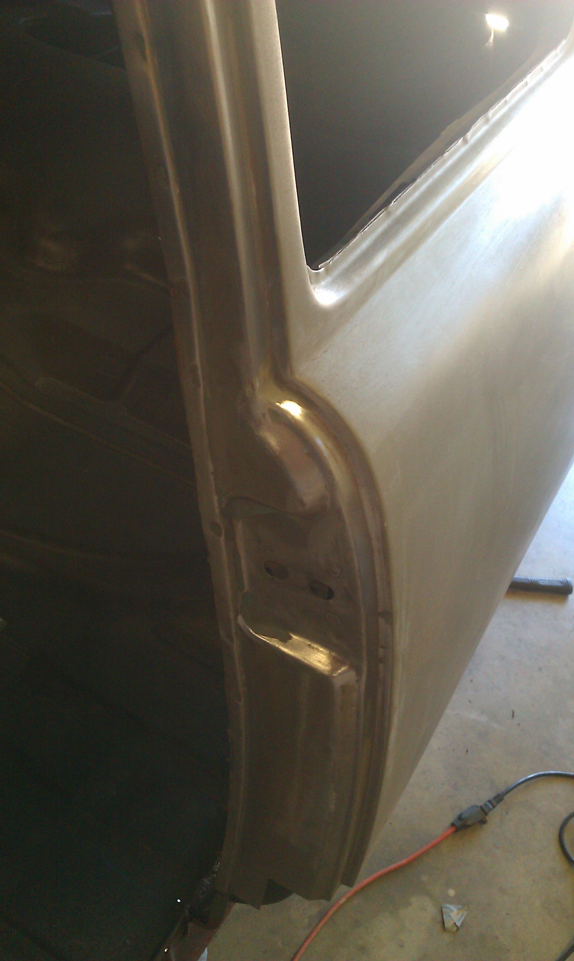

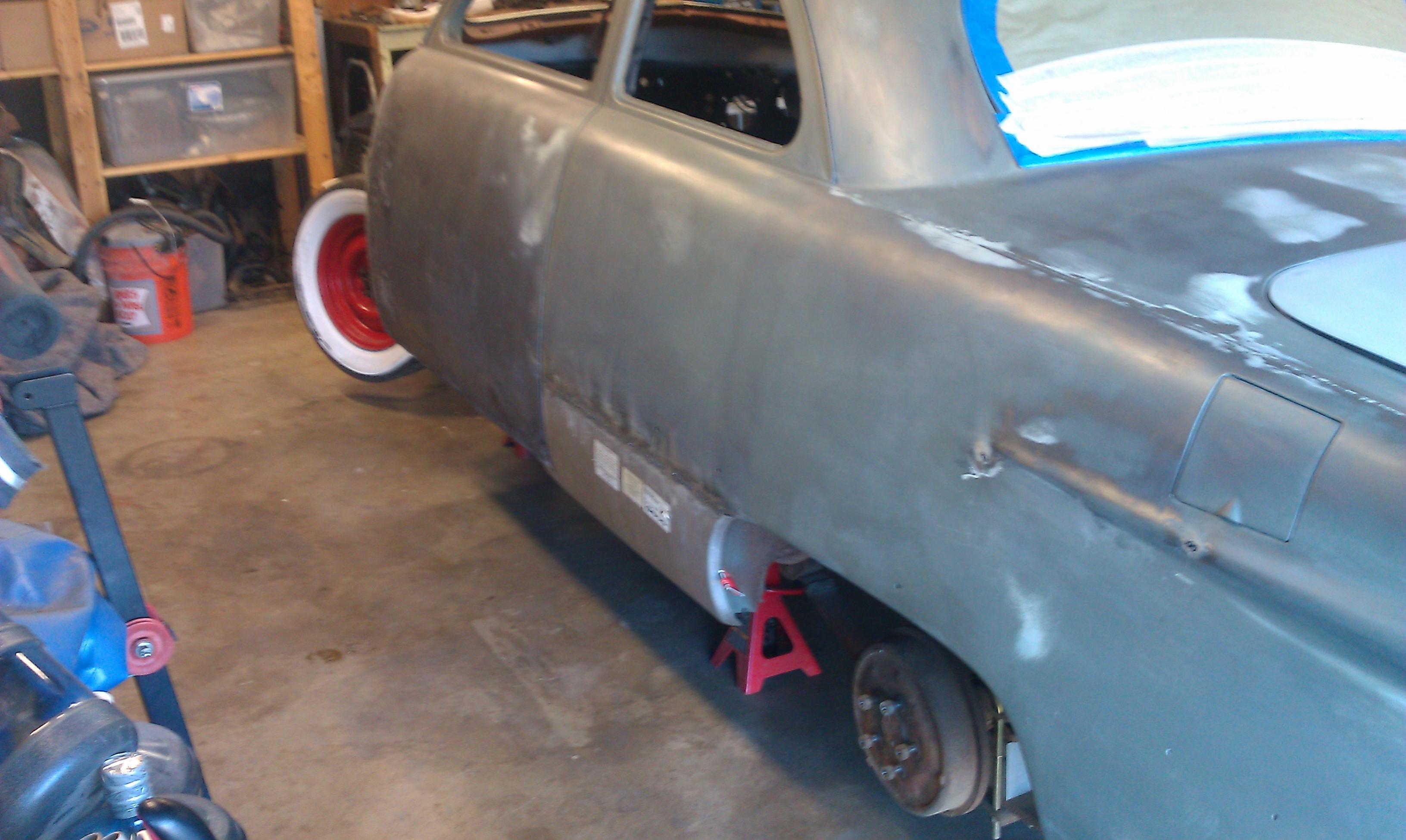

    Had some some time to work on the car yesterday.
    Got the Drivers side Frame taking down.
    I had just tack welded the drivers front 1/4 panel in. Wasnt happy with its placement. So I realigned it.
    Got the top butt weld closed up, and part of the door frame.
    Did anyone else have issues with where the bottom of it aligned to the inner fenders? It was the same on the Pass. side.
    I should of gotten more done, but the my ankle is still not fully mobile from the the infection I had. Plus I have to take breaks, elevating it.

    I think only issues i had with the passengers side were the door gap between the door and front quarter,but that had nothing to do with the quarter panel.The door hinges were just so worn out that the gap was messed up because of that.It turned out a lot better when i fixed the hinge issues.Keep up the good work!

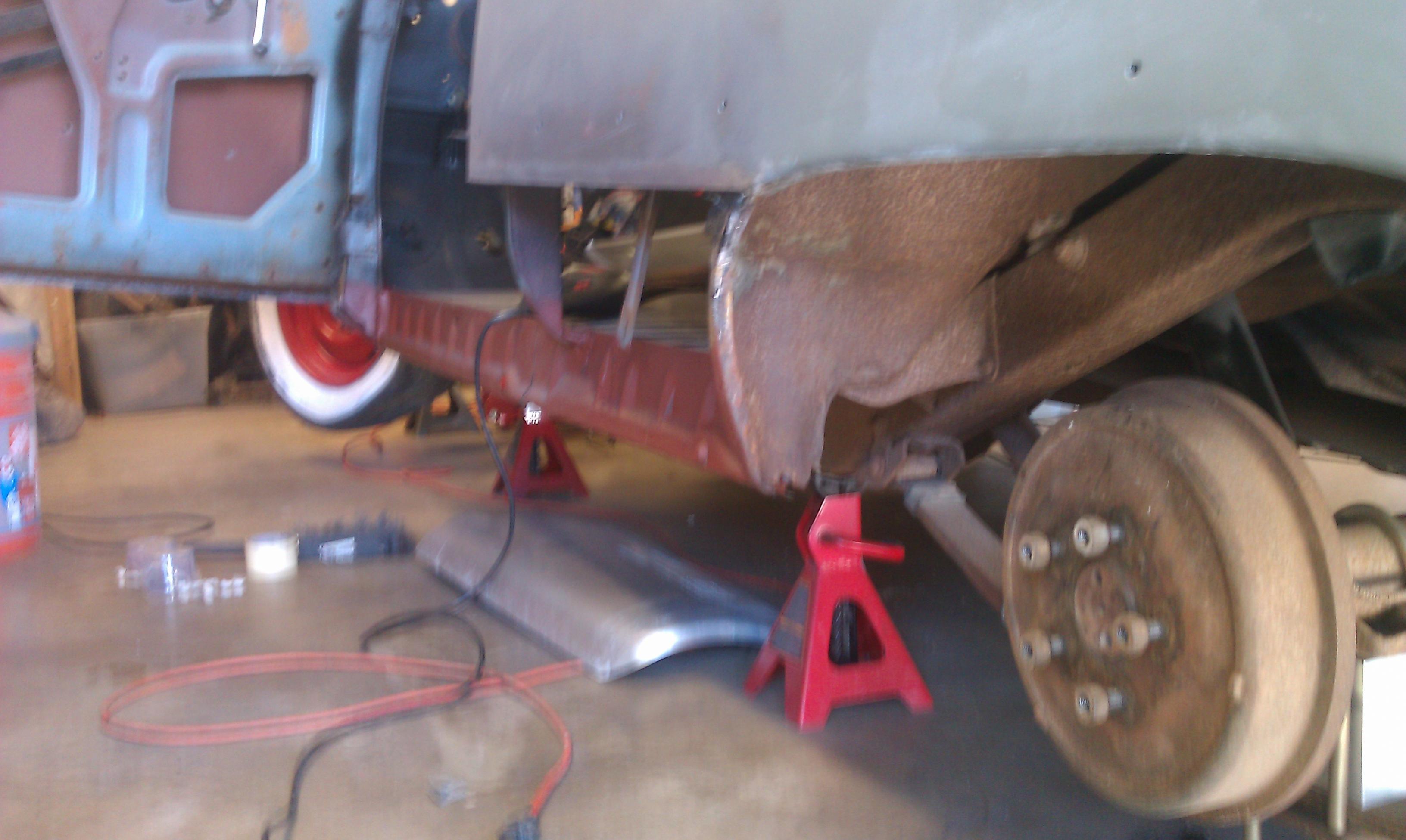

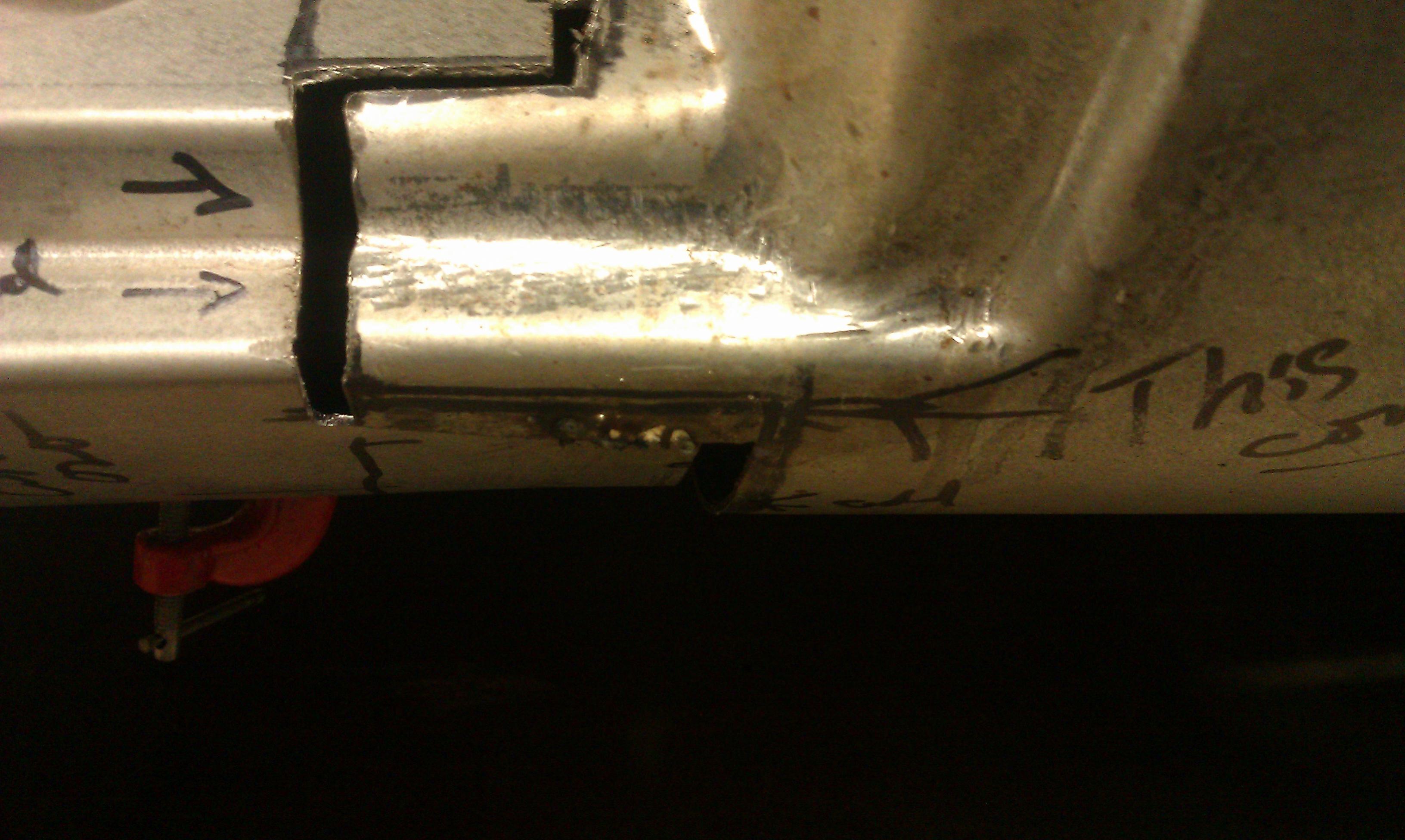

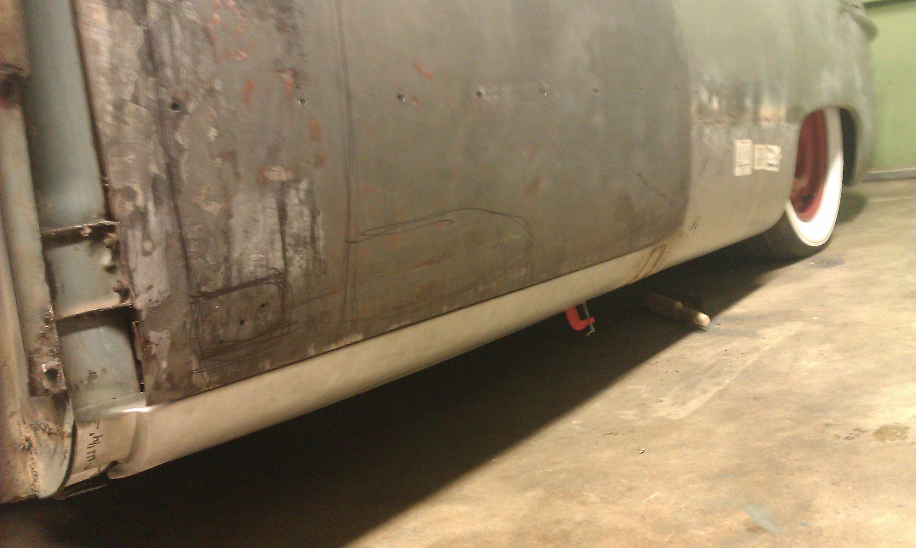

    Got the rocker tacked in place. Still have to finish up the spot welds and closing the seams. I had to reconstruct and splice the bottom 5 inches on the side door frame, also trying to get the 1/4 panels to line up with the rocker was hell. they still are not perfect. Going to beat on them a bit, then fill and block sand.
    I will post pics this week. I am looking to do this with my tail lights. So I am on the hunt for the pieces or something very close.

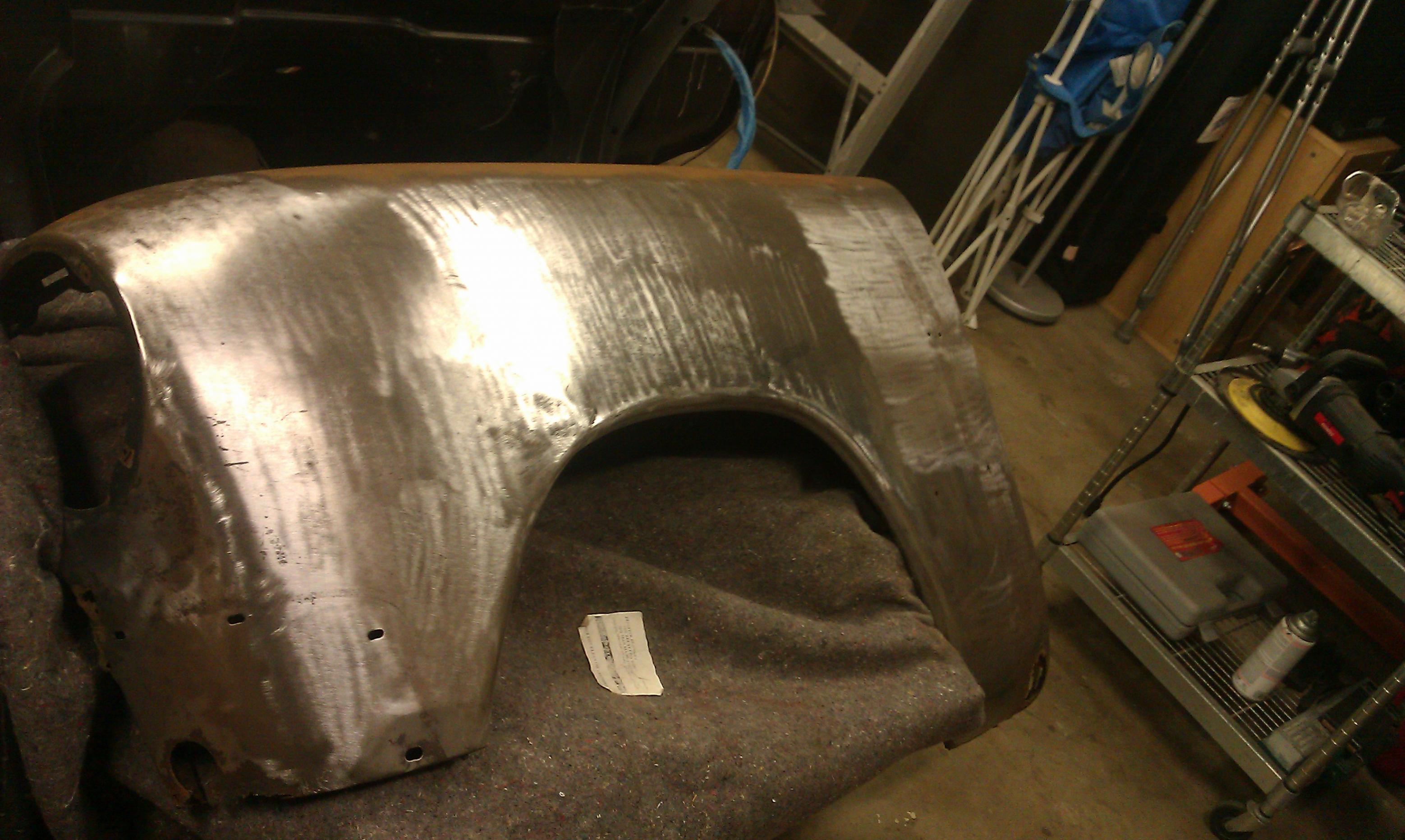

    I had some fenders up for sale that had a good sized dent right below headlight and some cancer. The dent and headlight bodyline is reworked. The pic just shows it bare metal. I will get the finished photos soon. Had them up for 100 bucks. a couple hours of time and their fixed.
    I have a fixation with gold, so there are some gold nuggets haha.
    The rocker to front rear 1/4 did not match up at all. I cut back and had to splice and stretch. It still is not lining up right. I may have to cut further into the rocker and 1/4 panel to get the bottom curve to smoothly transition right.
    The Driver door front part of the skin needs to be replaced, the actual structure of the door is fine. I am going to be picking up a skin hopefully next week.
