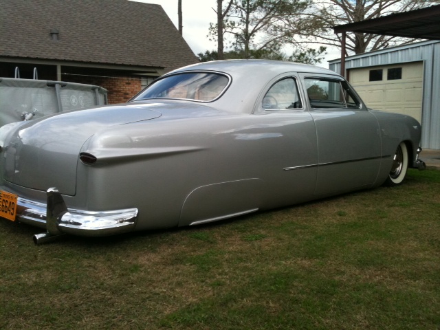

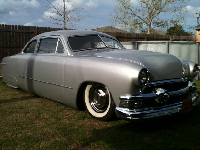

    Another update: I put my 57 Stude trim down the sides today. Kinda breaks it up a little. I'm happy with the results. Got the brakes sorted out completely. I was using a manual pedal assembly with a booster and had the wrong ratio. I had a 6 to 1 and I modified it to 4 to 1 and the brakes are great now. Learn something new everyday.

    Looks fantastic!! Very nice work. Makes me want to drag the 50 sitting outside my shop in to start working on it. Looks like the Gambino kit on the rear is the way to go. What did you use for the front suspension?

    Thanks, I clipped it with Fatman parts. It rides great.

    Did you have to modify the tubs at all to get it that low in the rear? Looks like the original but can't quite tell.

    Thanks everyone. No I didn't change the wheeltubs. Im running 205/75r15 tires and I did have to install bumpstops to clear the tubs all the way down. It's low enough for me.
