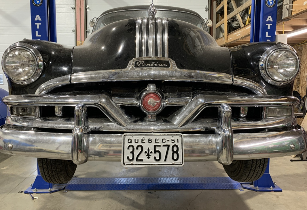

    Just getting started on this project. First issue is the frame is separating. Can't find a donor frame in my area.
    Only 2 options I can think of is swapping the frame for something more readily available such as an S10 or other frame or building a new frame from scratch.
    I don't believe it's repairable but if you guys know otherwise please share your suggestions.

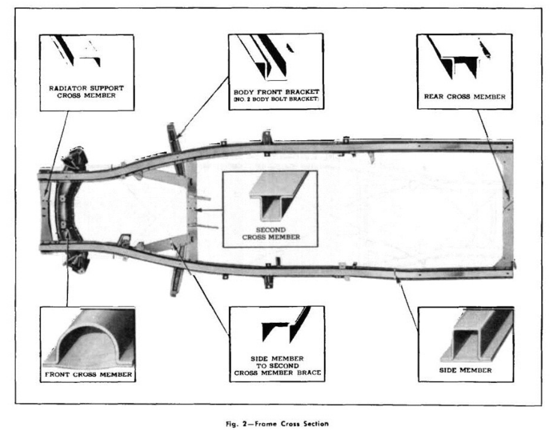

    Is it a top hat frame like Chevy ?

  5. Then it’s a top hat frame like a Chevy, Canadian poncho was just a reskined Chevy
    Opens options for parts cars n finding a frame.

    A top hat style frame on face value wouldn't be that hard to repair depending on what you class as 'Separating'. It's a very basic frame unlike a full frame with open 'C' channel as in Oldsmobiles, Buicks and Cadillacs. Or as suggested, a simple frame swap may be in order?

    Hah! Finally got the pics to load.

    Looks repairable however time is money. Do it once do it right. Either way the body needs to come off frame for repair or replacement. There's time involved wither way, rolling a better frame under your body would be quicker and more time efficient.

    That frame is toast. Once you sandblast the outside you will have more holes than steel left, and you still haven't removed the corrosion from the inside.
    The key to fixing old cars is having lots of friends. Get the word out for what you are looking for. You need to let everybody you can do some networking for you.
    Unless you are an experienced fabricator, a swap from a different model car is not a good answer. You will spend more time modifying everything to fit than you would making calls to find a direct fit frame.
    You might make some calls to the US looking for shops that are doing frame replacements with pro-touring style full IFS frames. They'd probably be giving the old stock frame away for the hauling.

    It looks like repair work has already been attempted on that frame. I would agree that it needs replacement. There should be frames available somewhere as Chevy is the same. All body styles used the same frame as well, except conv. I believe. I know the local pic a part has some Chevy's in it, but I never looked at any frames on them.

    Thank you gentlemen! I actually JUST found a '53 frame. Gonna pick it up tomorrow and make it work.
