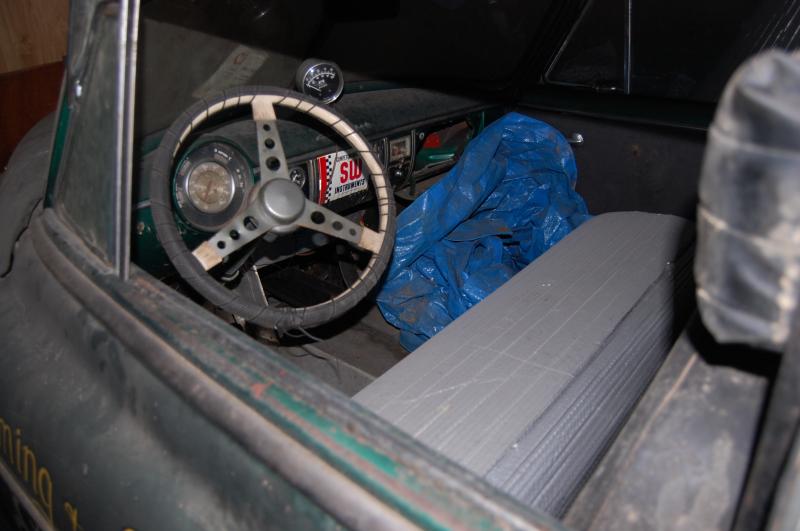

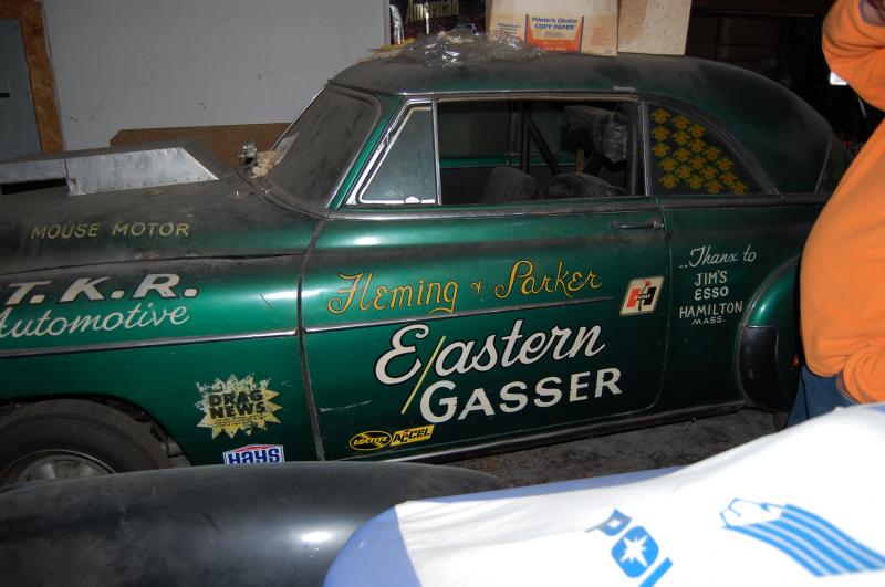

    Larry, cool to hear about your Dad and you both owning Chevy hardtops. It reminded me to look for some pictures I got off the HAMB (I think?) of an old 50 Bel Air gasser owned by a Tom Fleming I believe. Here are the pics, hopefully someone will see these and know the whole story:
