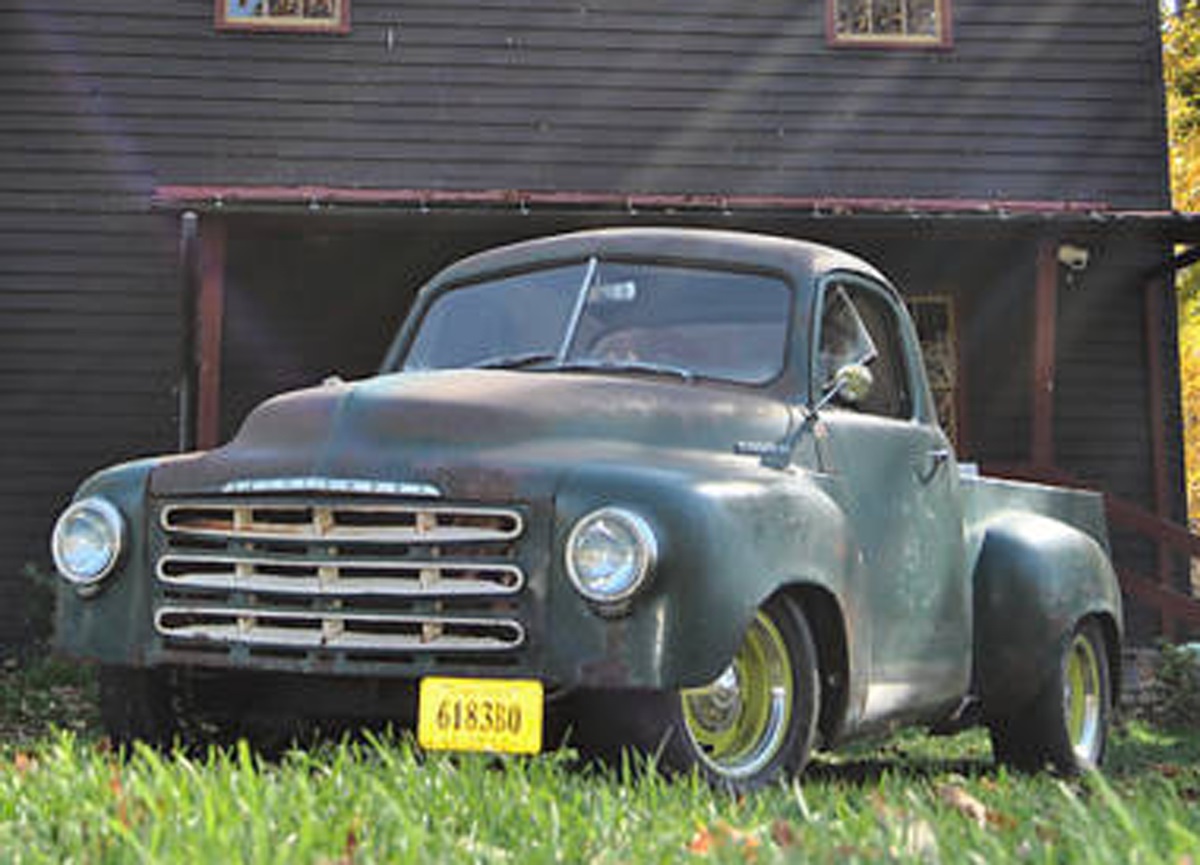

    Here's the truck:
    First pic is when I bought it. Last pic is the truck I am basing mine on.
