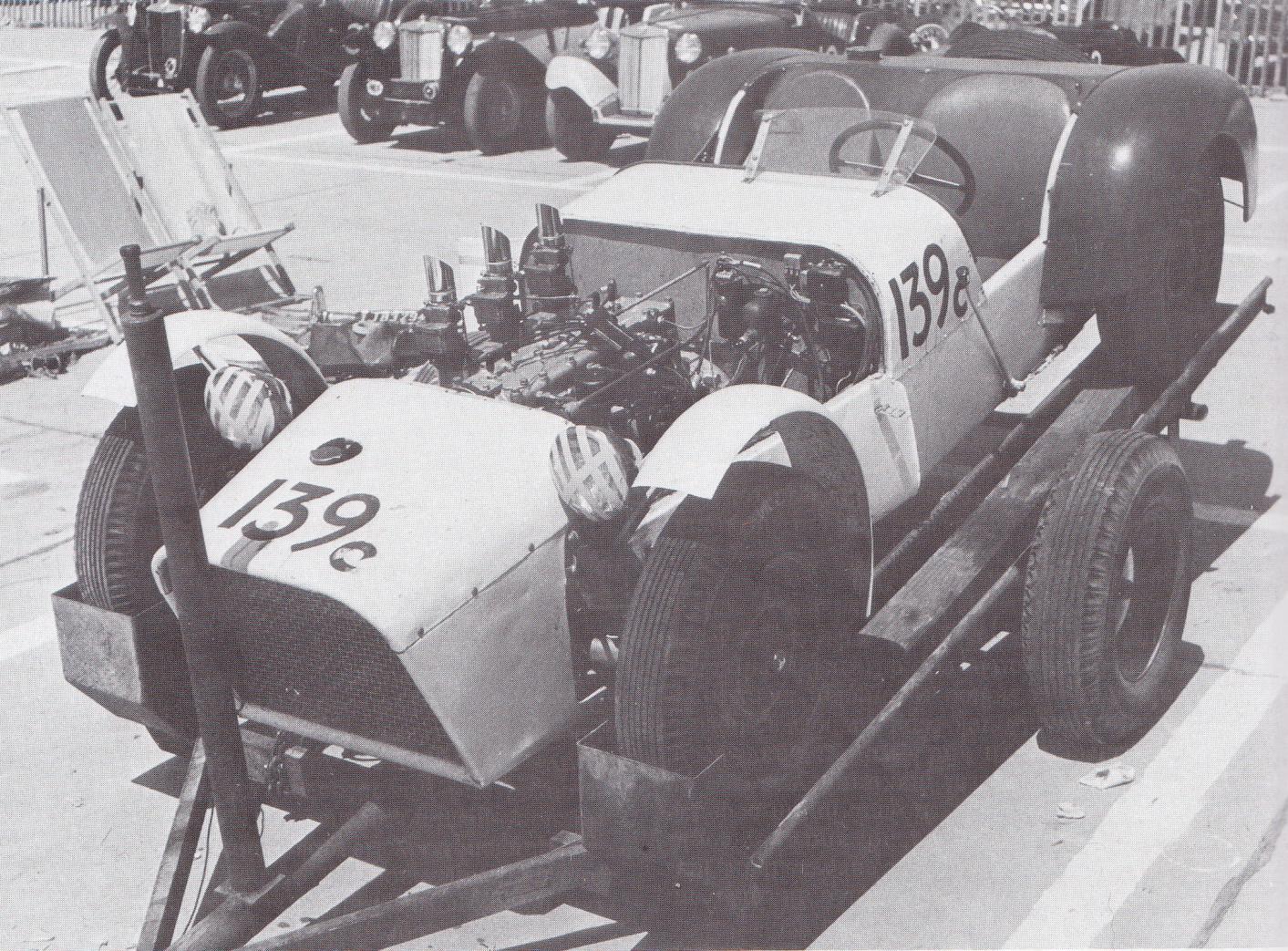

    Apparently the ( 218?) Plymouth had a following...

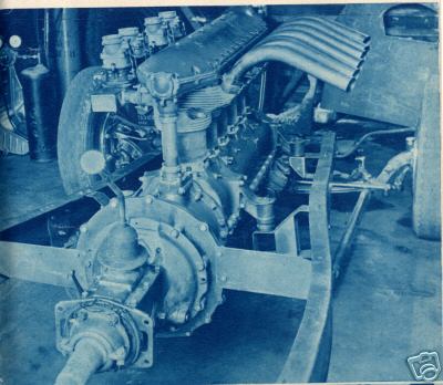

    In my mind, as warped as it is, I'm seeing something with a long hood and a straight Chevy 6 underneath it. Something like this.
