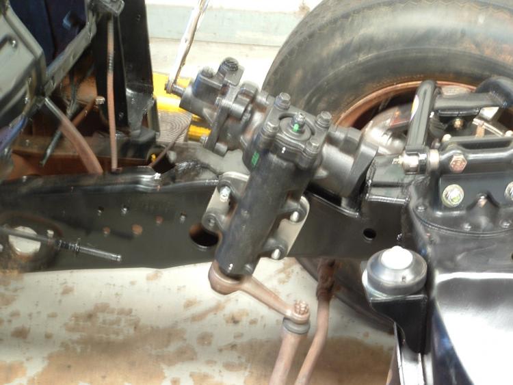

  15. Went to see Rick at Extreme Kustoms in Wildomar earlier today to pick up one of his Jeep steering box adapters for the Merc. While I haven't installed it yet, it looks pretty trick during the "hold and imagine" test on the frame. It looks to be a simple install and will hug the frame nicely. One corner does hit the inside of the fender well, but the creation of small blister with hammer and dolly will take care of it...no drama. Now I just have to figure out exactly which electric power steering pump to use. It seems that every decision on this project not only ends up costing me more money, but also means that I have to change or add a couple more things. Nature of the beast, I guess.

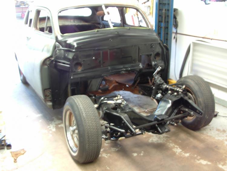

    [/ATTACH] merc2.jpg merc4.jpg merc1.jpg
    EXK kit

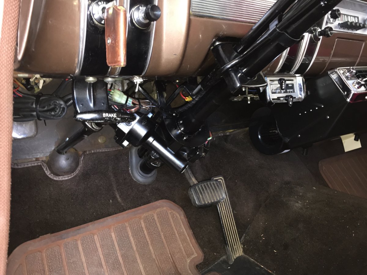

    1953 Ford Car with electric power steering. Budget friendly and no pumps and hoses to run. 54pwr str.jpeg
