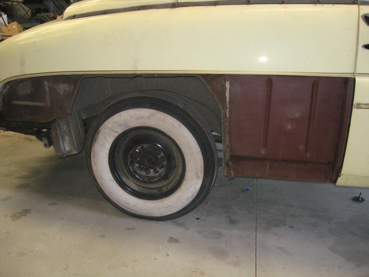

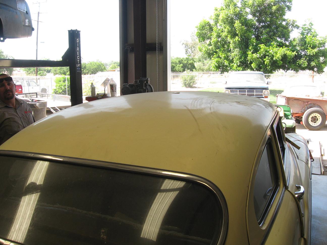

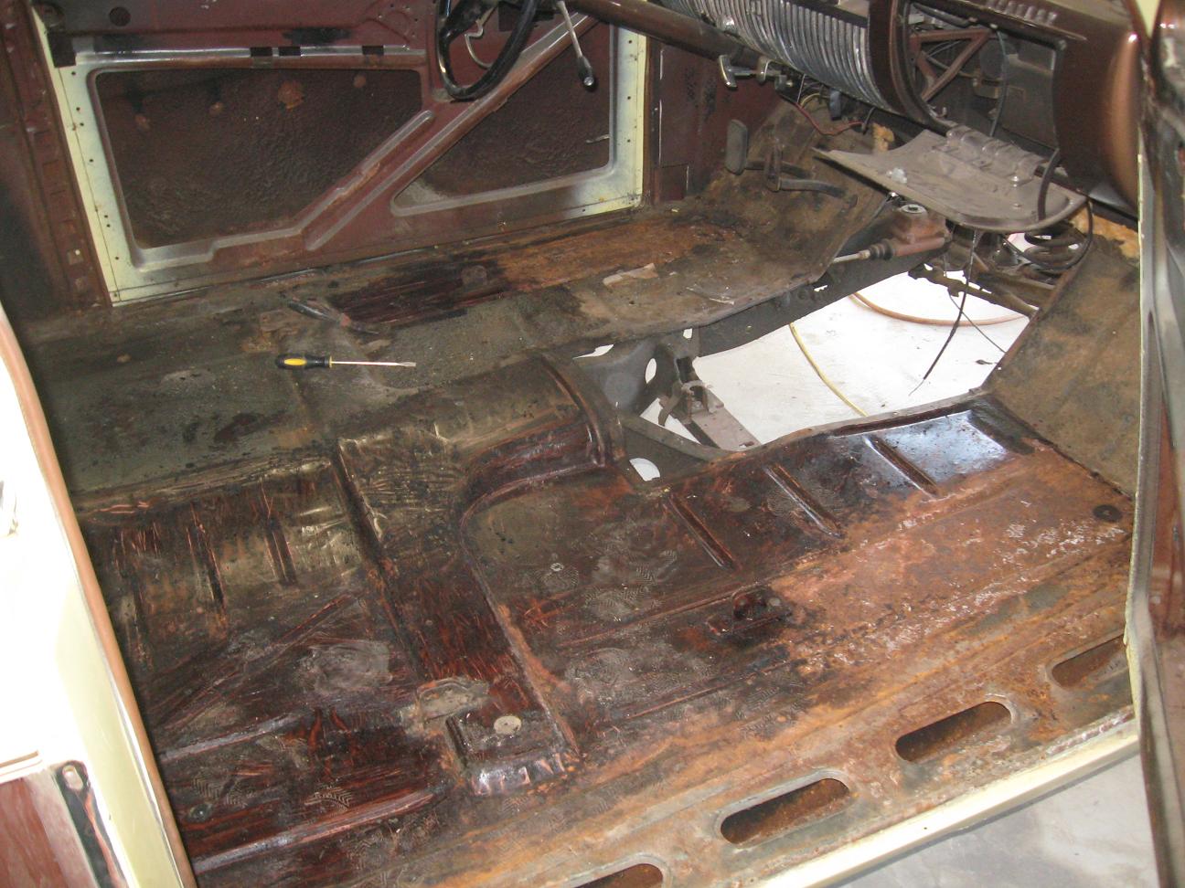

    slddnmatt

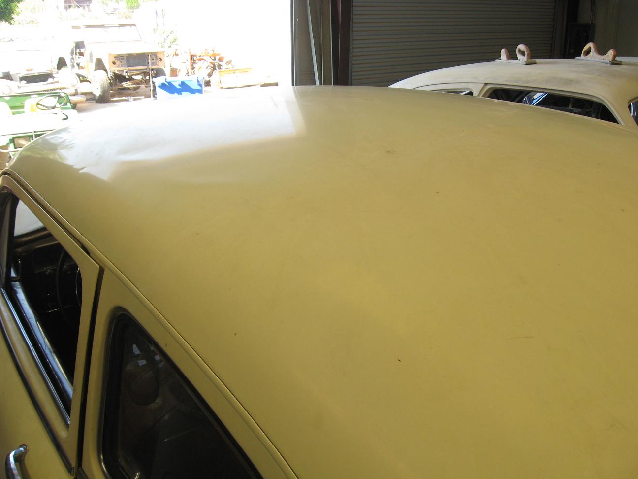

    When we arrived to pick it up, we had noticed the roof was a bit wavy, ( guessing some kids at one time took a walking to it) but being the pale yellow, it was pretty hard to see in the Ebay pics unfortunately for the owner. Once back to the shop we got it tore apart and looked it over. Overall it was a pretty solid Merc as far as rust with only a small 3" circle of rust in the corner of the trunk.

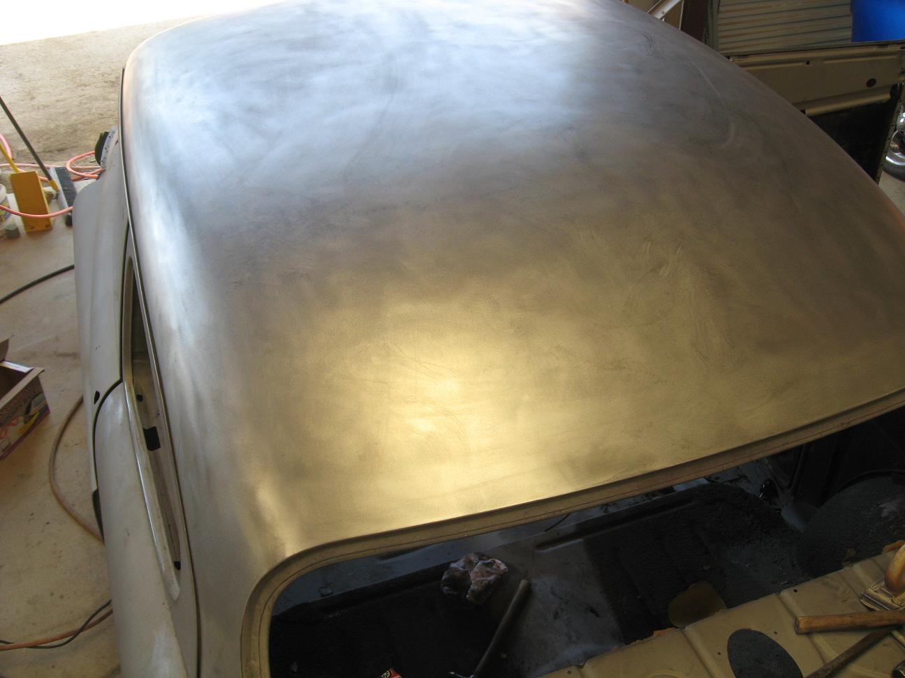

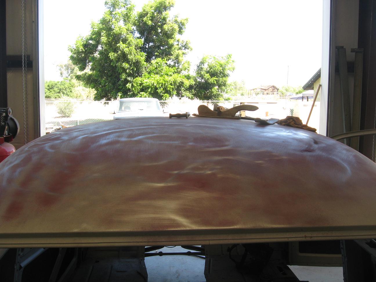

    slddnmatt

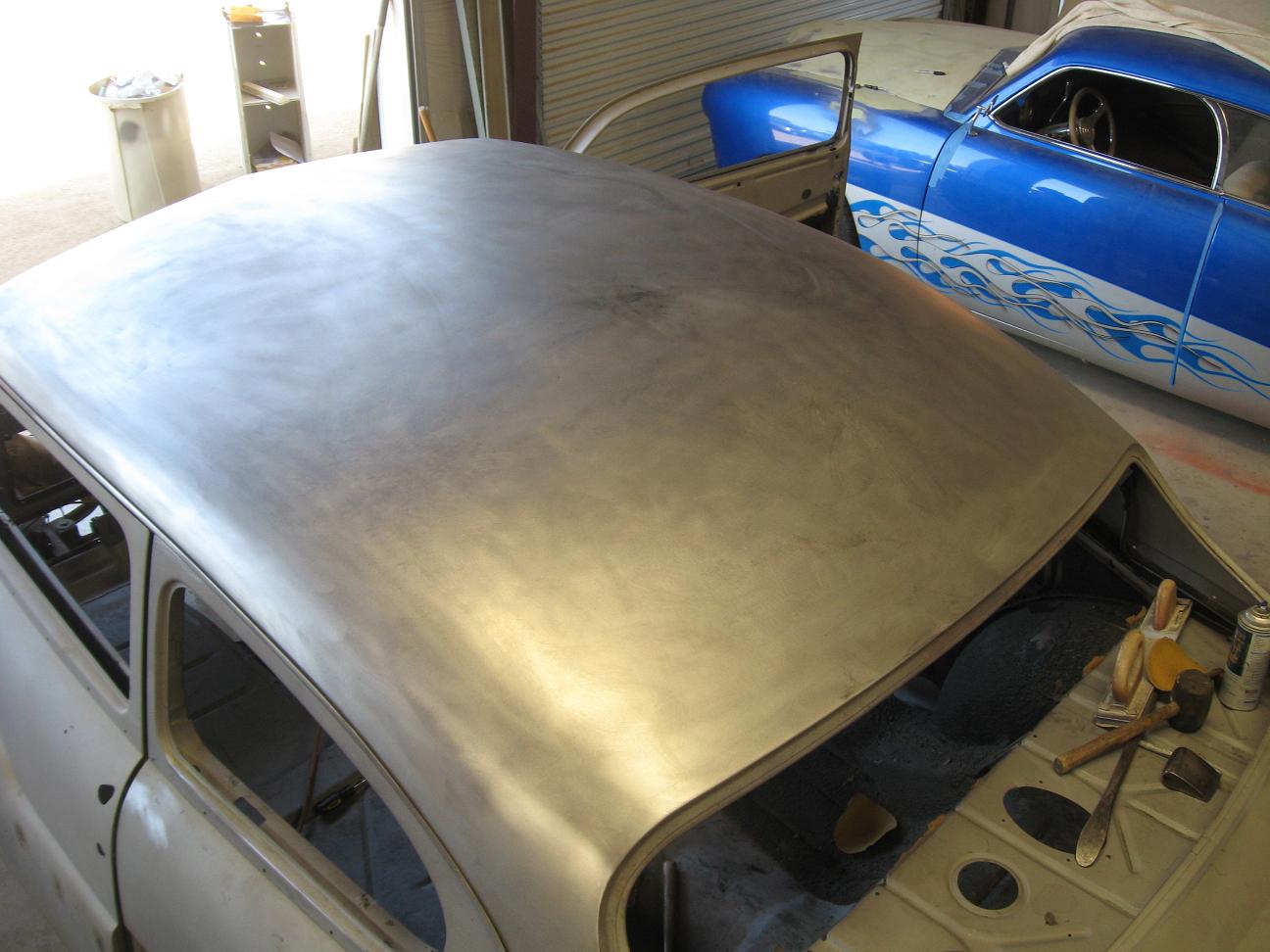

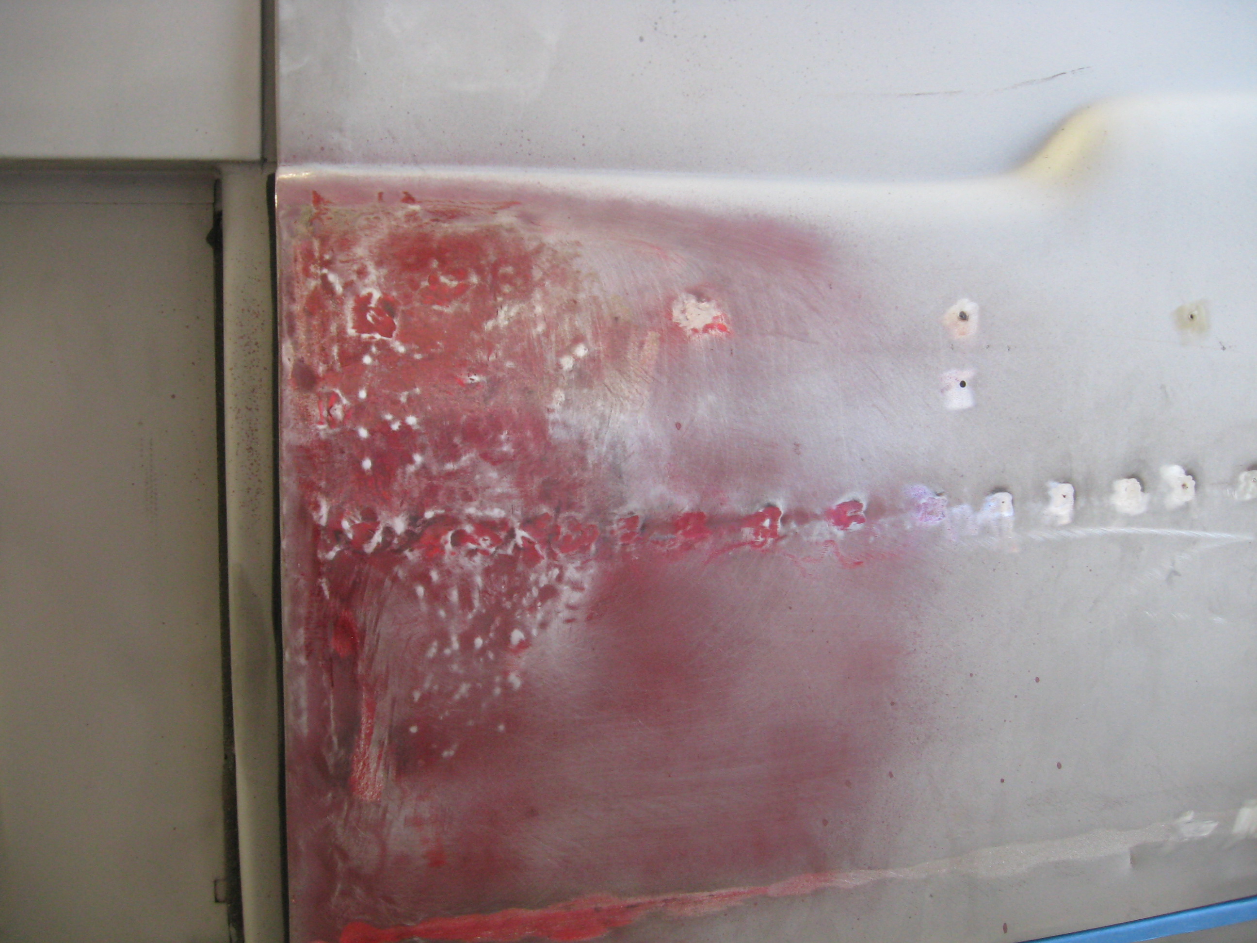

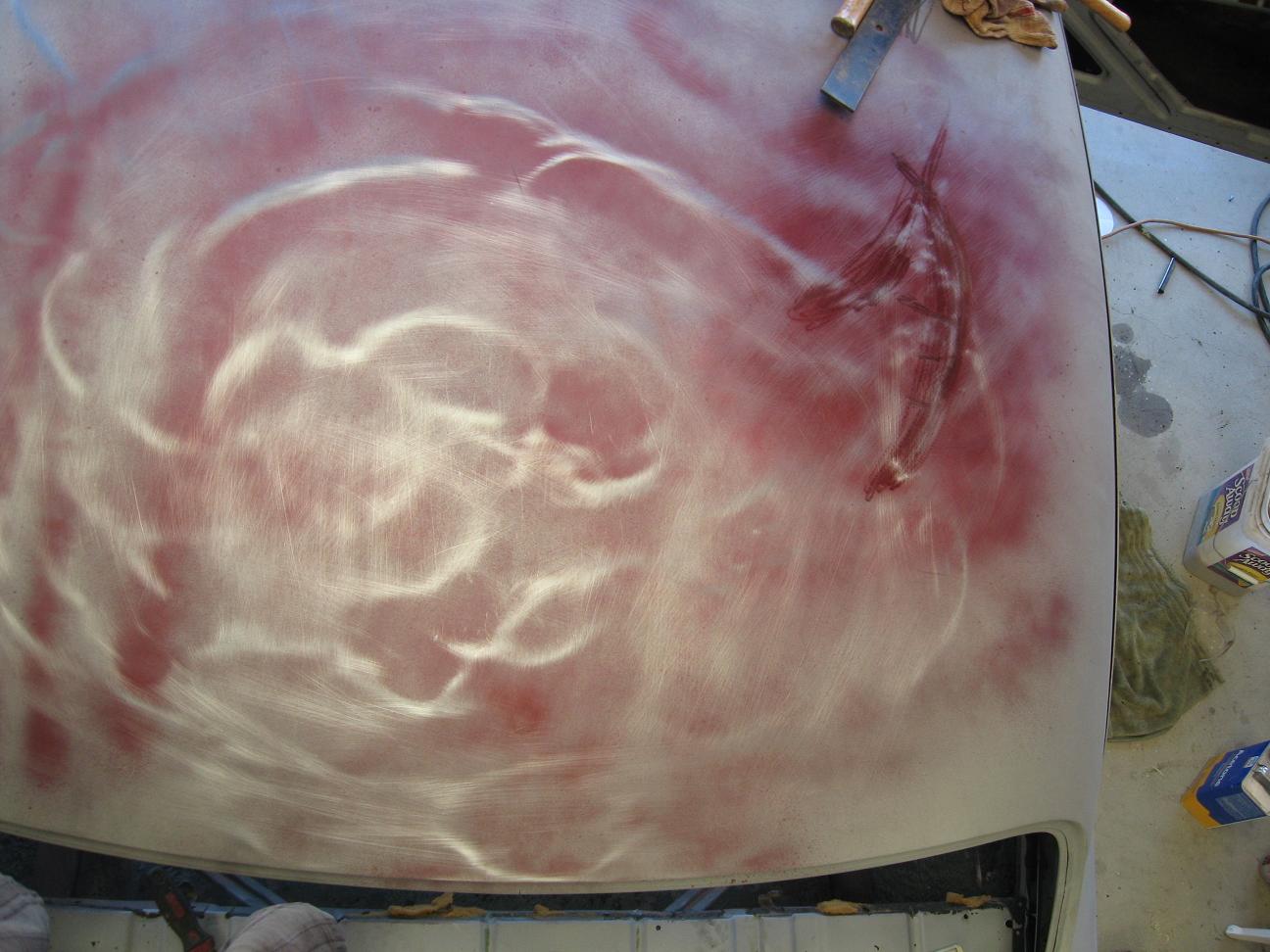

    craigs50 065.jpg craigs50 064.jpg craigs50 065.jpg craigs50 065.jpg craigs50 051.jpg craigs50 066.jpg craigs50 067.jpg craigs50 065.jpg craigs50 064.jpg Once back from the sand blaster, the signs of the excellent previous body work started to show its face..You can now see the dents in the roof alot better, with a quick block across the Dykem. I worked on the roof for hours getting it all smooth and pretty again, before I could take the ax to it!
    kidcampbell71 likes this.

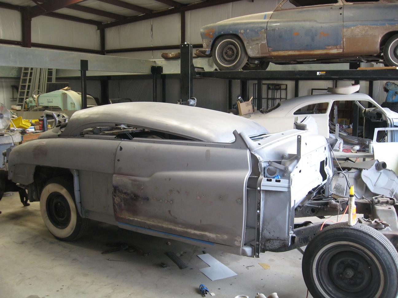

    Sorry to let you down Pist-n-broke, but yes it has reworked vents to go with the original roofline shape of the Merc, and as much as I would of loved to do roll down windows in the rear, It's not my car or money and all those custom touches aren't free..
    After discussing cut heights with the owner we ended up going with 4" in front & 4.5" in the rear. I love sending pics of the roof lobbed off to the owners. My buddy about had an anxiety attack when hes saw his Merc in this state..Gets that heart rate going!

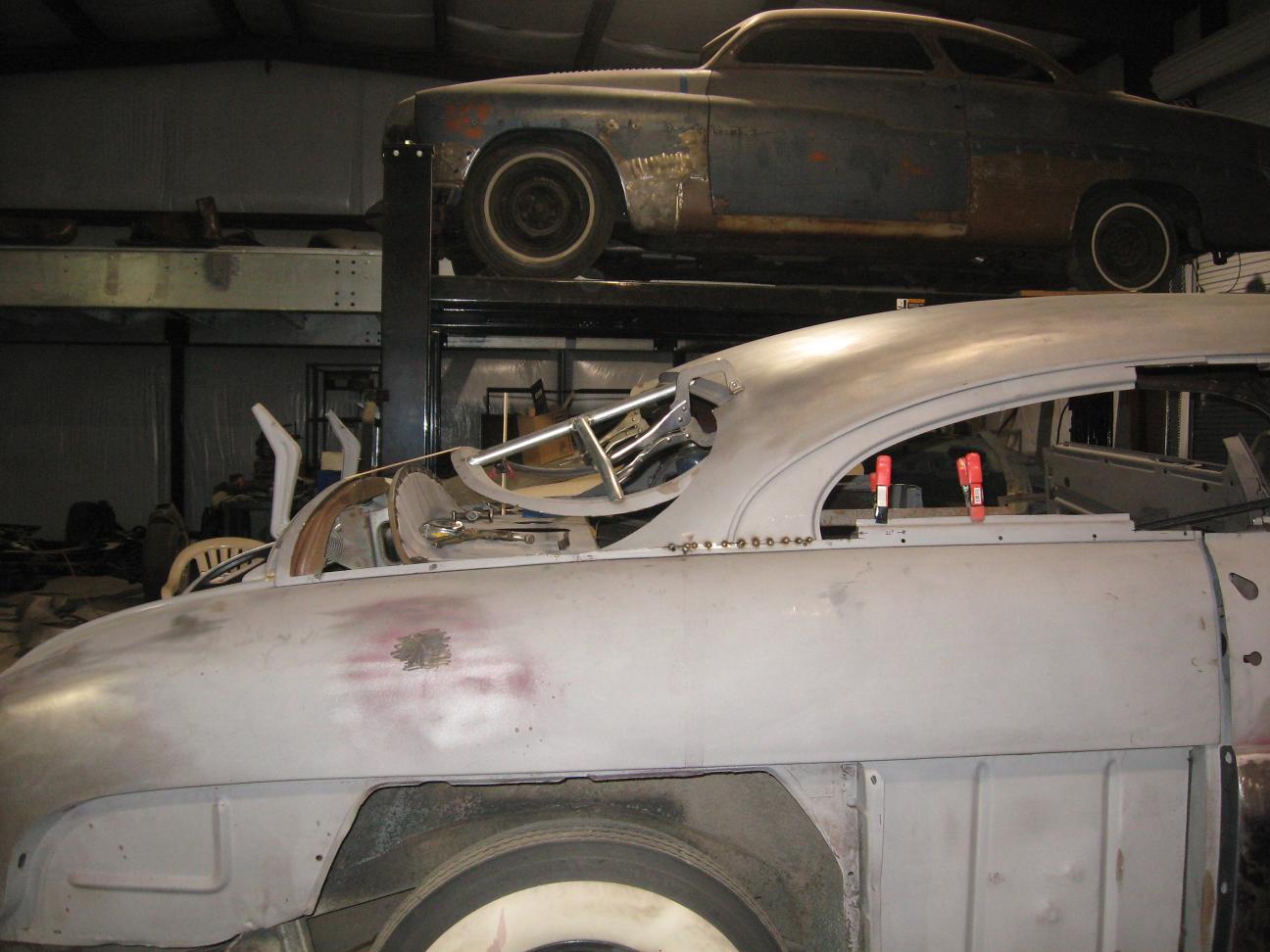

  12. slddnmatt
    Joined: Mar 30, 2006
    Posts: 3,682
    slddnmatt

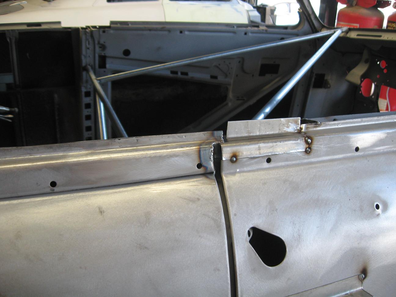

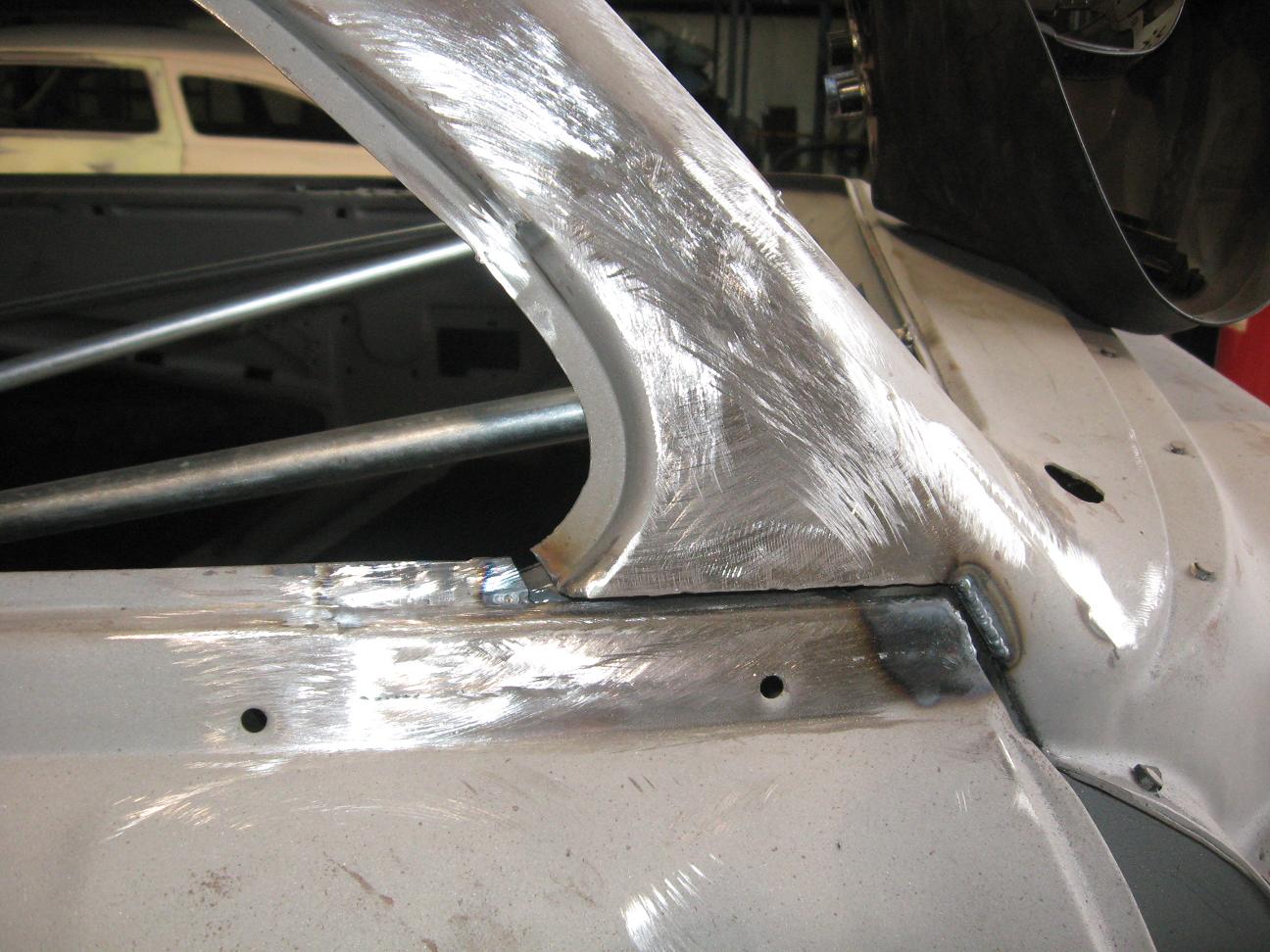

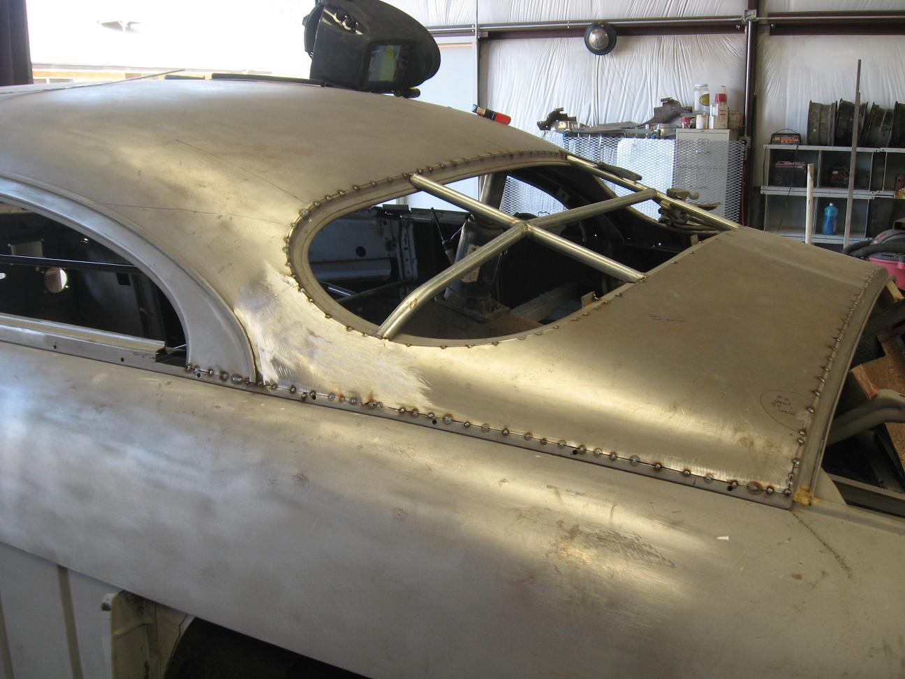

    craigs50 089.jpg craigs 50 009.jpg craigs 50 005.jpg craigs 50 012.jpg craigs 50 014.jpg Now for the fun part of getting the rear window positioned and square. Then on to forming the deck and getting it tacked in place and checking everything out.
    kidcampbell71 and Eric H like this.

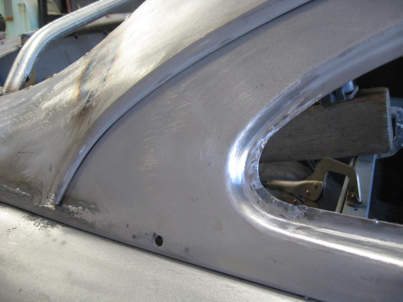

    craigs 50 011.jpg craigs 50 015.jpg craigs 50 016.jpg craigs 50 044.jpg craigs 50 021.jpg
    getting the "A B & C" pillars and door tops situated..

    Is the roof repair all hammer and dollie or was a shrinking disc/torch used as well? either way..simply amazing!
    Eric H likes this.
  18. slddnmatt
    Posts: 3,682
    slddnmatt
    A lot of bumping with the hammer and dolly and shrinking disc..think I used some cuss words on a couple of the spots also ;)
