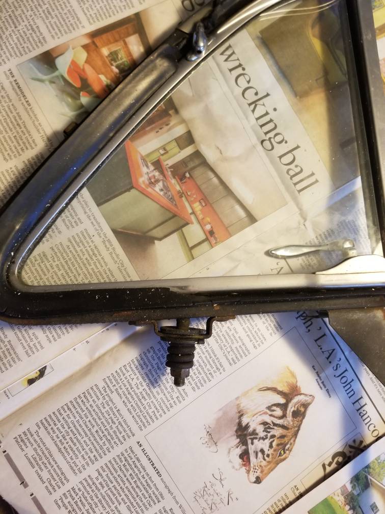

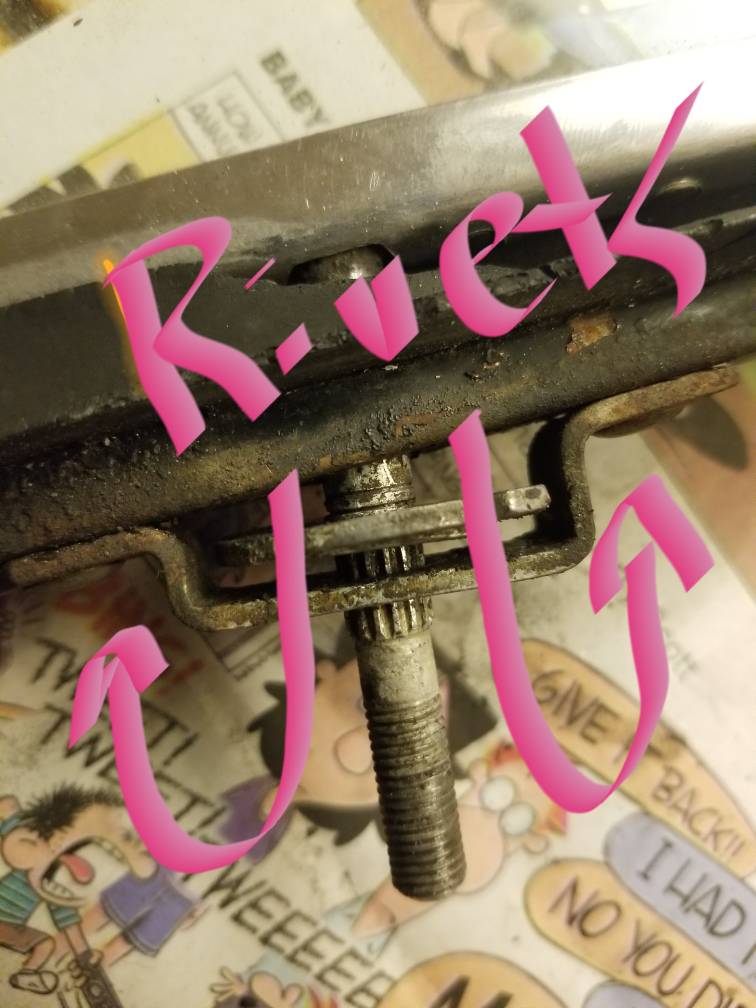

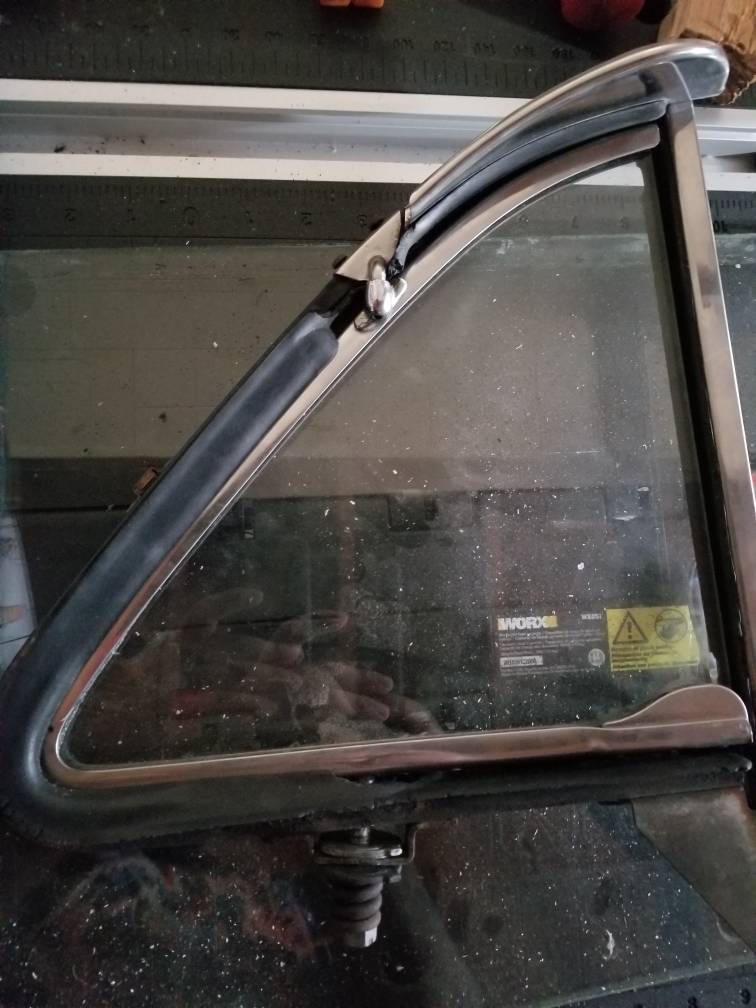

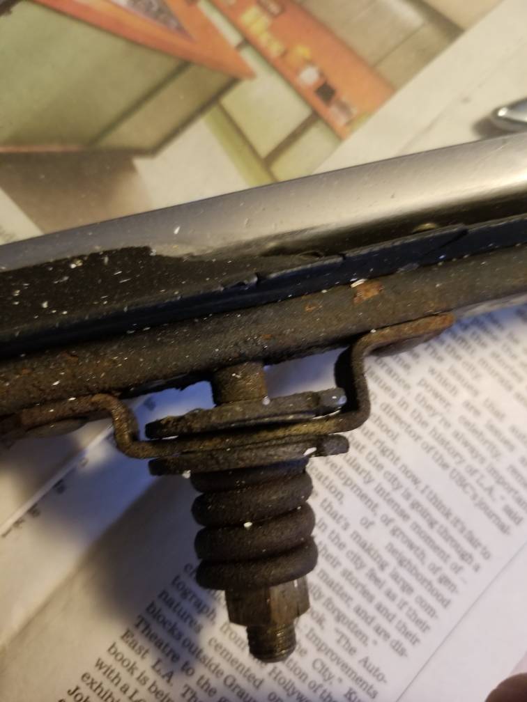

    Hi there just got some new vent window weatherstrip amd having an issue removing the window. The bottom nut , spring and washer came off bht the tip washer is stuck. I think its pinched there on purpose not to move so it can keep pressure down on the rest of the sprig assembly. Do i have to drill out the rivets that hold that bracket in then re revit with a pop rivet or am i missing something? Thank you in advanced. Enclosed is some pics. 20191016_165125.jpeg 20191016_165131.jpeg 20191015_183638.jpeg 20191015_180420.jpeg 20191015_180400.jpeg

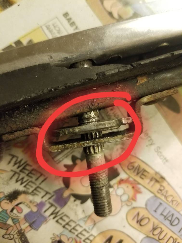

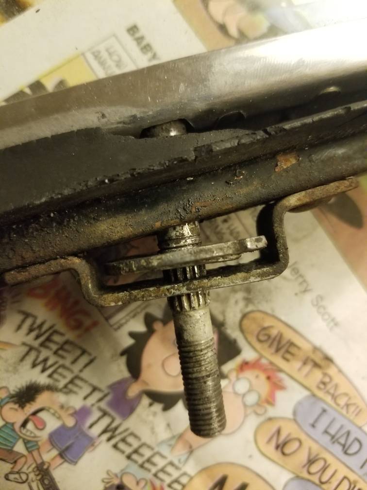

    So the whole assembly came out of the door it just i cant get the vent window out because this washer wont come out. Not sure if its supposed to stay there and that braket surrounding it needs to be popped out. Should have been clearer on the pics lol 20191019_181957.jpeg 20191019_182209.jpeg

  4. No no, that washer does come off the splines just like the lower ones you already removed. It's just stuck from age. The 2 rivets you see just hold the shaft in the S.S. glass frame. Don't remove them if you done need to. Replace a nut on the threads just flush to the bottom of the shaft and set it on a solid work station. Then gently tap the washer in question on each side of the shaft and it will let go. You should know when you start to put it back together there is a void in the splines to clock the stop shoulder to keep the frame work from turning to far and stopping where it belongs. Pay attention when removing things.

    Ahh ok cool thank you very much. I did see the matching spines and tapped it but was too afraid to keep tapping it. Figured i should ask before i go further. I appreciate all the help!
