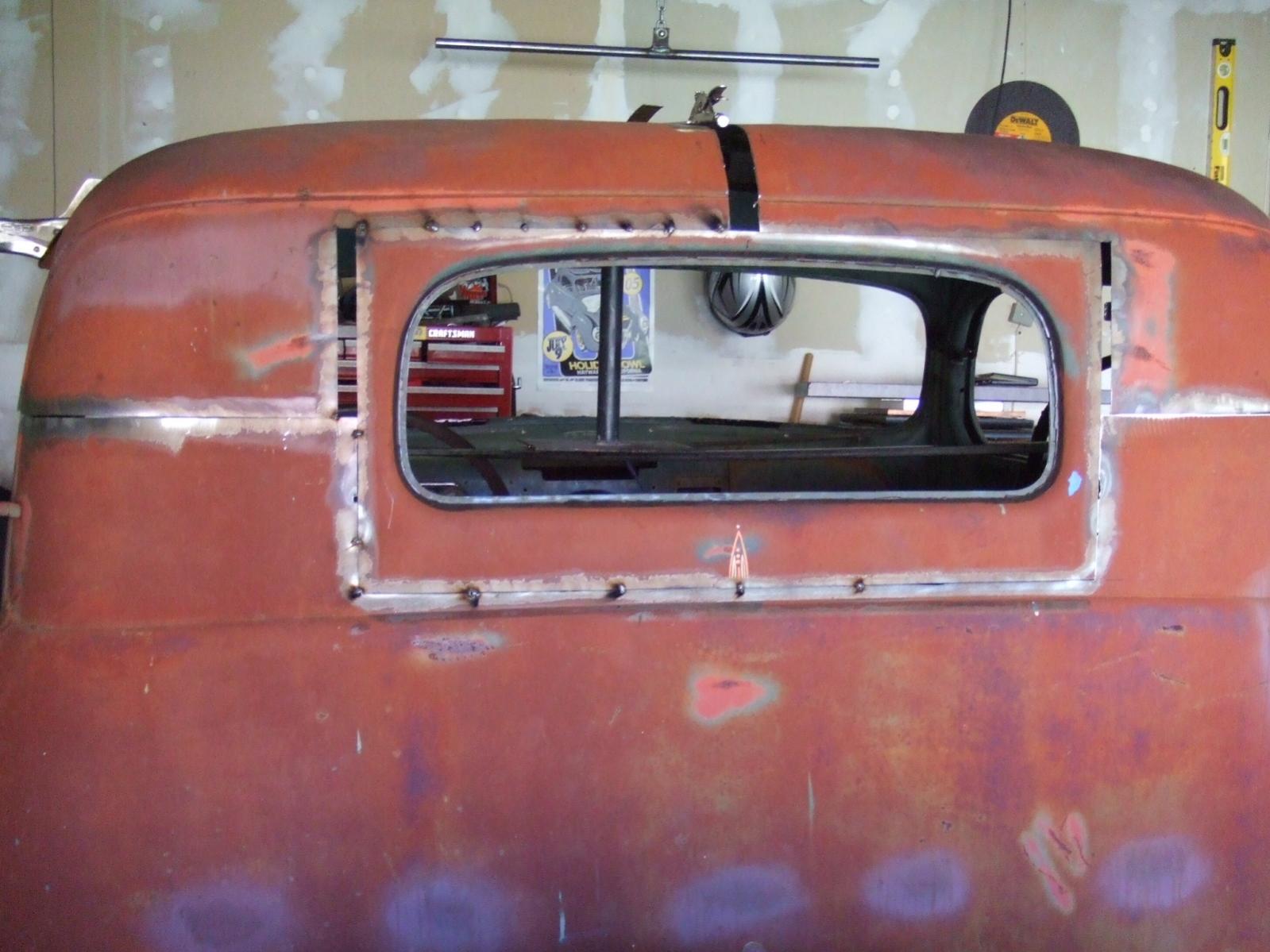

    Its been a while sence I have last posted anything about this truck. But, these past few months I have been working on it almost ever night, And this is what I have managed to accomplish in those few months so enjoy.

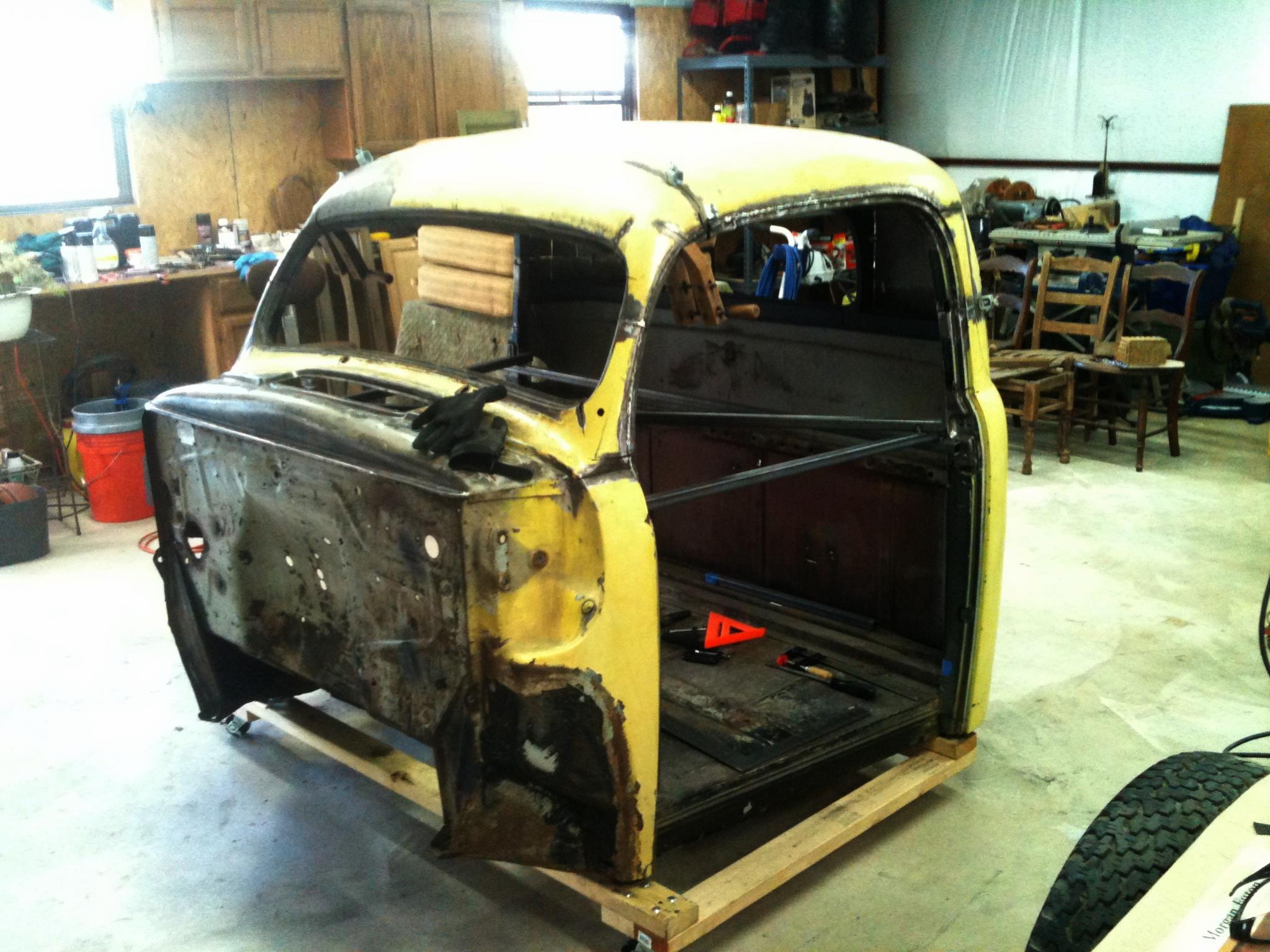

    I welded up the seam where the rain guards used to be. (learning to weld as I go). And I measered out the chop and made sure it was right, 3 inches in the back and 3 inches along the front post.
    Sorry for the quality it was taken with an iPhone and I have shakey hands, but you get the gist of it.
    Then I cut out the rear window out, making sure I did not cut the supports. (agian sorry for quality)
    Then I cut the top off, and removed the rear window with the supports all in one peice.

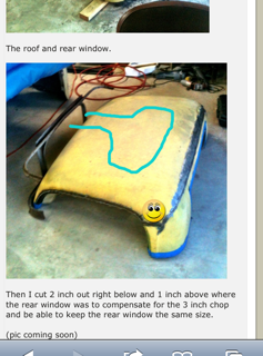

    The roof and rear window.
    Then I cut 2 inch out right below and 1 inch above where the rear window was to compensate for the 3 inch chop and be able to keep the rear window the same size.
    (pic coming soon)
    I don't have a before picture of what the rear window looked like when I pulled it out. But I had to straighten the top supports, they some how got twisted when it was pulled out a little force and a hammer straightened them out, The bottom ones where all fine nothing wrong with them. I then sanded off the tar like substance off of it and sanded the whole thing down and painted it with two coats of a rust prevetion paint and 2 coats of primer. And this is the end result.

    Just don't lean the posts.
    I know it goes against what you usually hear when it comes to chopping a top but at least half the roof to bring the front and rear posts down separately.
    Then start looking for a donor to fill the hole in one piece. There are at least a couple of good threads on this floating around.

    I know what you are talking about with not leaning the post. It causes problems with how the window sets in place. But I have thought long and hard on how to chop it, and leaning the posts is my best option. Leaning the windsheild back will also give me the look I am going after. I am also trying to stay away from using any classic donor cars.

    Take a close look at a few F1 chops with the posts leaned versus being quartered. Are leaned posts really the look you're after or are you just convincing yourself that it is because you think quartering a roof is "beyond your skill set"?... because I'm not convinced it is. (beyond your skills)

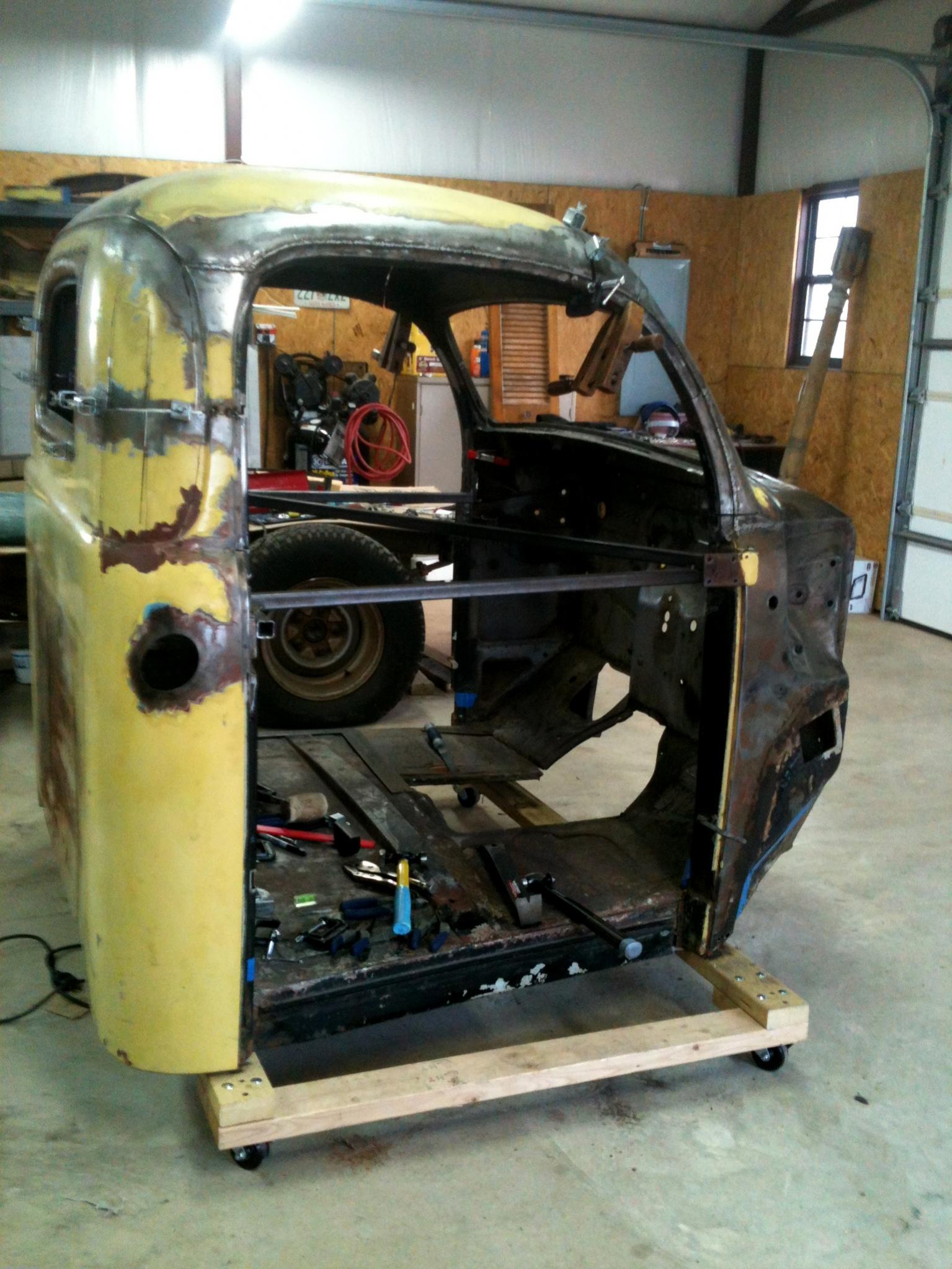

    I think I am actually understanding why you don't want me to lean the posts back. The body line (blue line) will be interupted and will no longer flow IF I lean the post back at the lowest possible point (lowest red line). This will allow me to lean the blue line back, so that the body line will not be interupted and will flow right. The dash will have to be cut out (was already going to do that) and a relief cut across the cowl, and this will give me the room I need to lean the posts back properly and be able to retain that line.

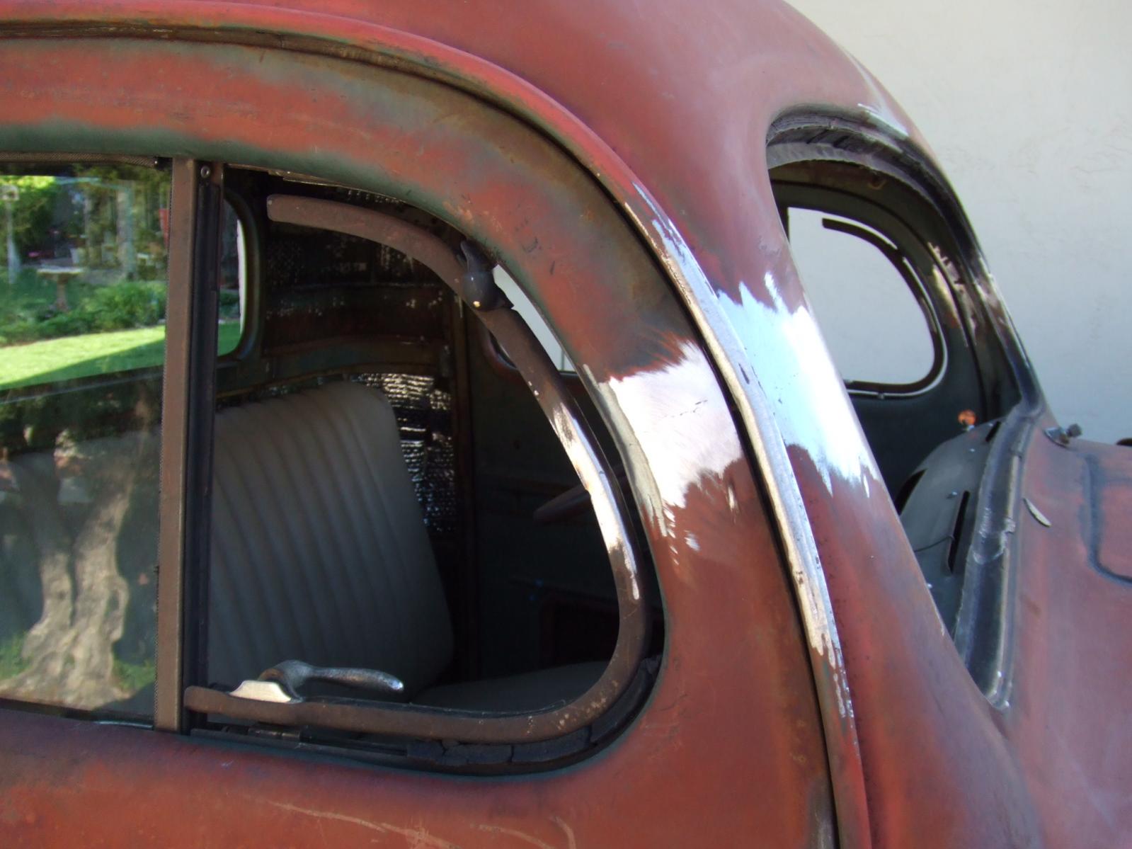

  13. I chopped my 49 Ford COE 4 inches. I quartered the roof, keeping all the pillar angles stock. I used a donor roof for the splice pieces. I cut out 2 inches above and 2 inches below my back window so the rear window is still stock height. It is close to same height as the side windows and front windshield. I also cut down and modified my vent windows to still be operational.
    My opinion leaning the posts on these trucks does not look good. Chopping a top is enough work, do it right the first time.
    My COE for reference, I wil add some detail pics of the chop later. They are on my home computer, this is on my photobucket.

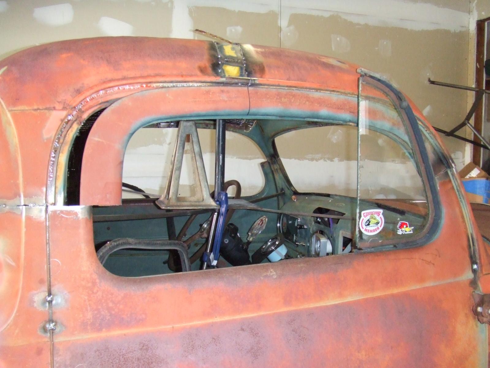

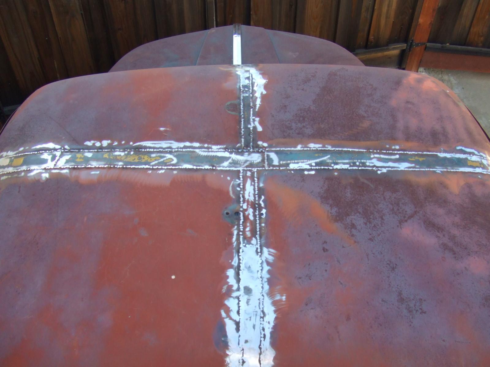

  14. Here are some detail shots of the chop, as promised:
