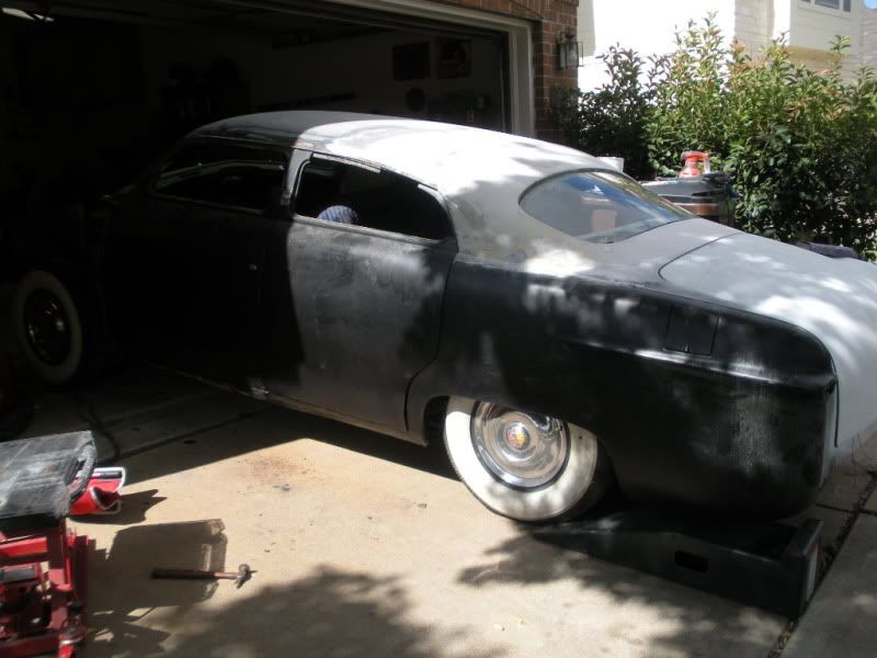

    Lousy pic, but here is one I am working on. Should be in primer soon.

  24. rafael
    Joined: Jun 28, 2007
    Posts: 194
    rafael
    from Moody AFB
    did you go with bags or static drop? good looking 4 door i also have a more door, its alot easier to get the familia in there...hehehe

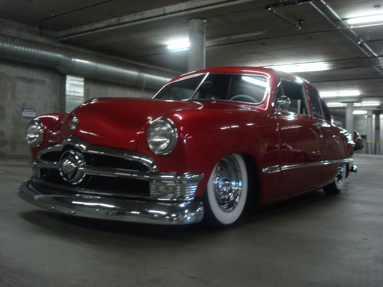

  27. hombres ruin
    Joined: Nov 21, 2006
    Posts: 3,306
    hombres ruin
    Thats my ride,thanks for posting,its a two door,glad you like it.
  28. KomoG2
    Joined: Mar 10, 2009
    Posts: 180
    KomoG2
    from Utah
    Yeah hombre, hoping I can get mine that nice someday. I guess in due time. Nice Box
