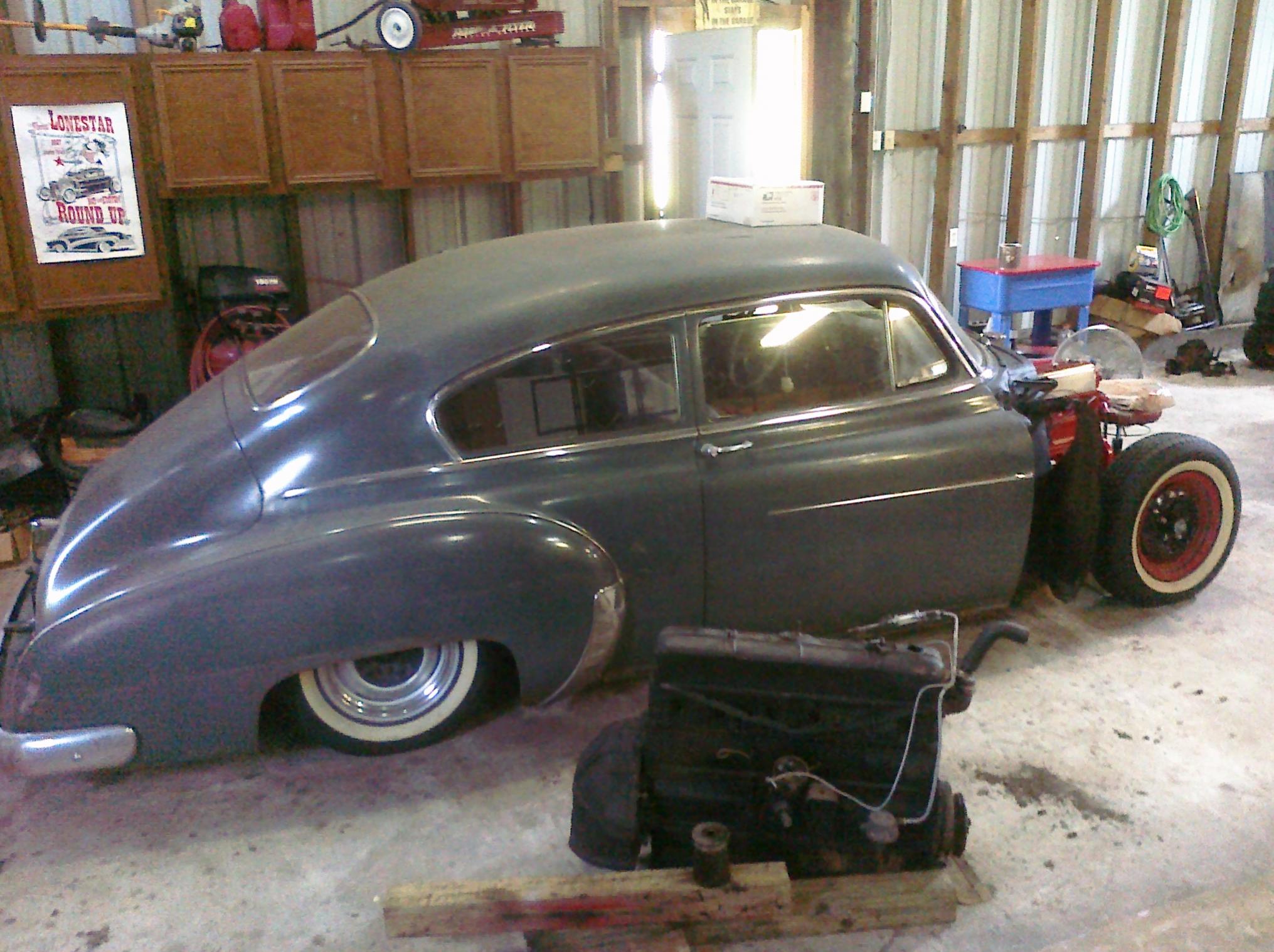

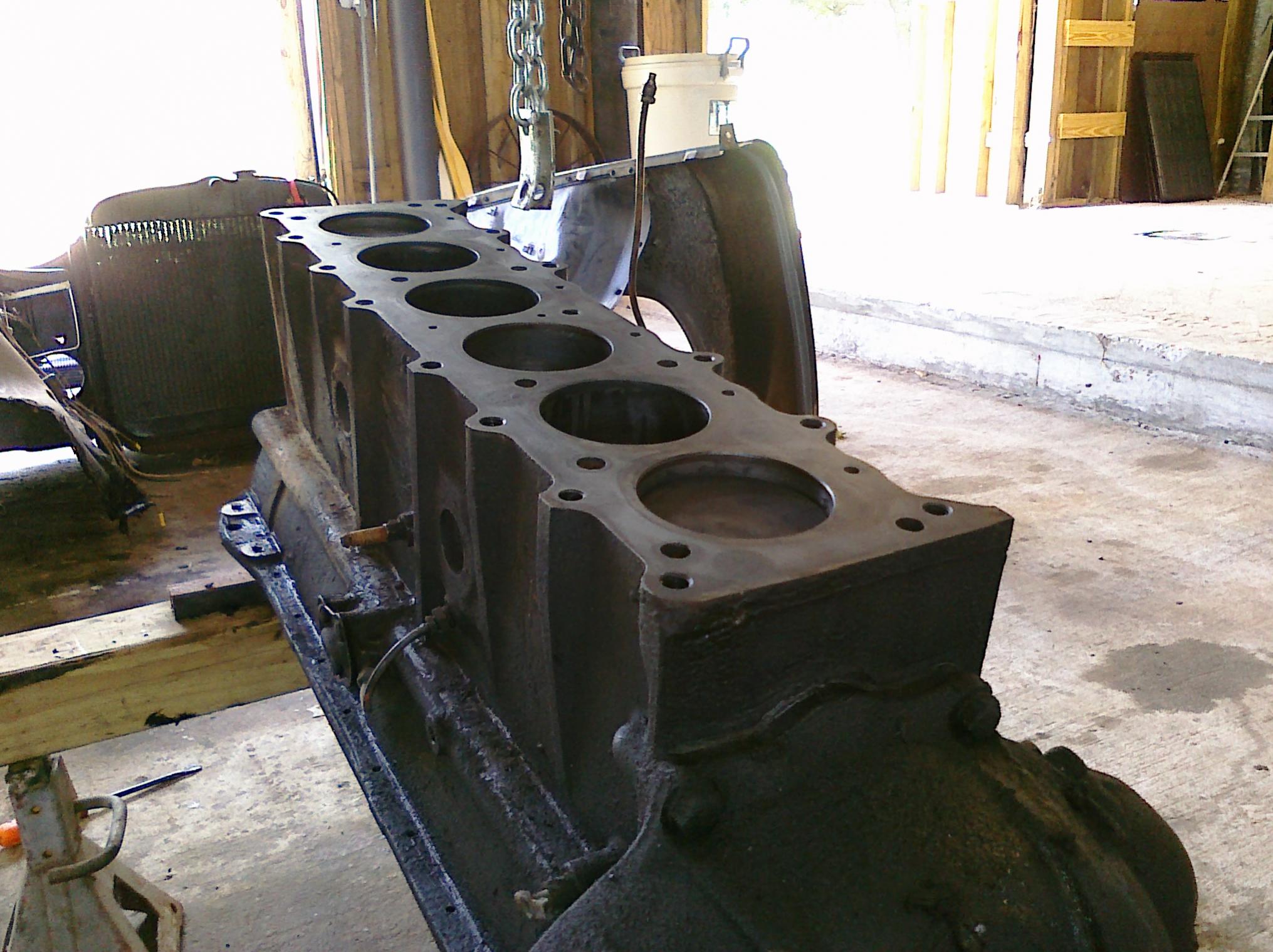

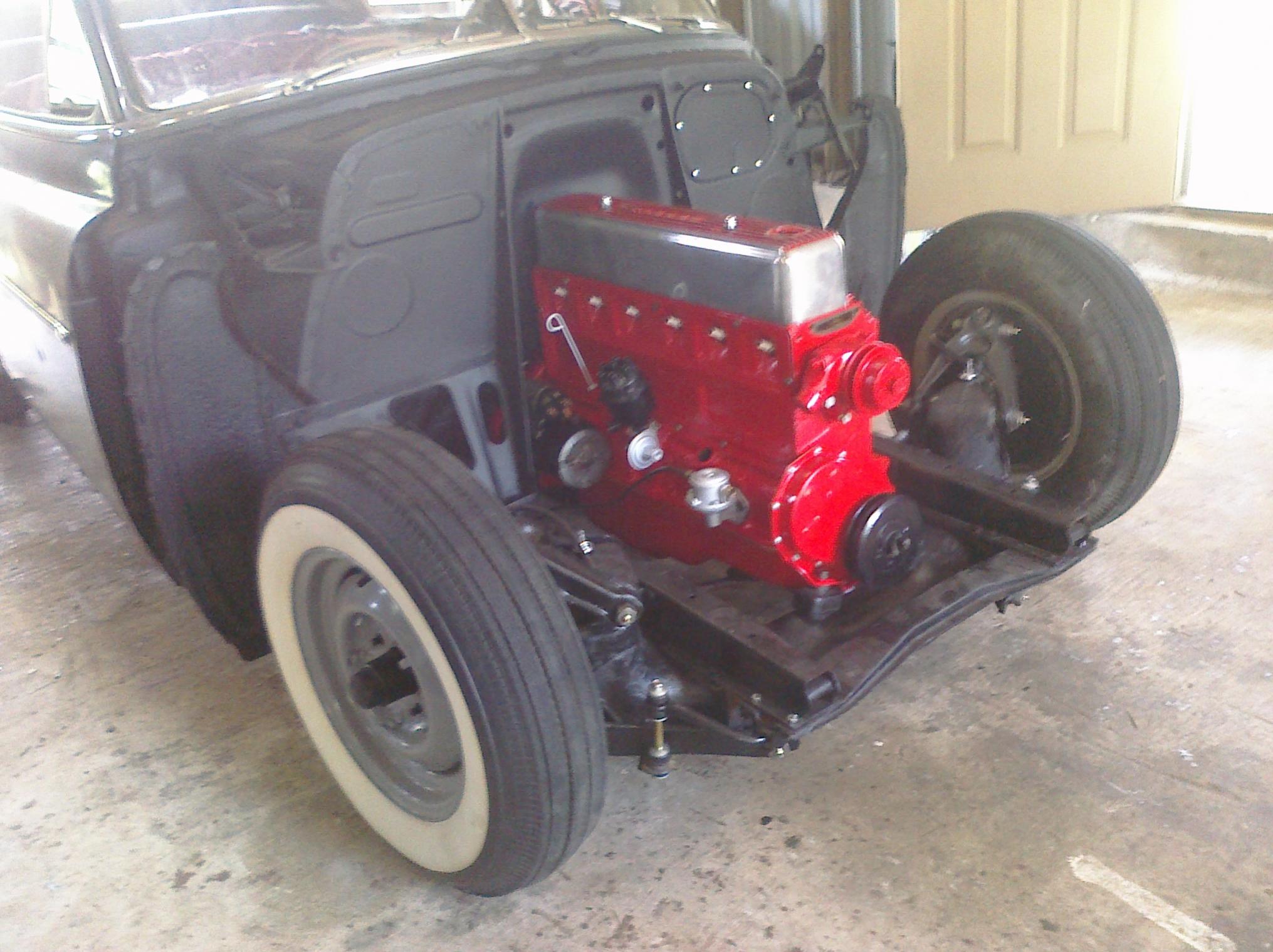

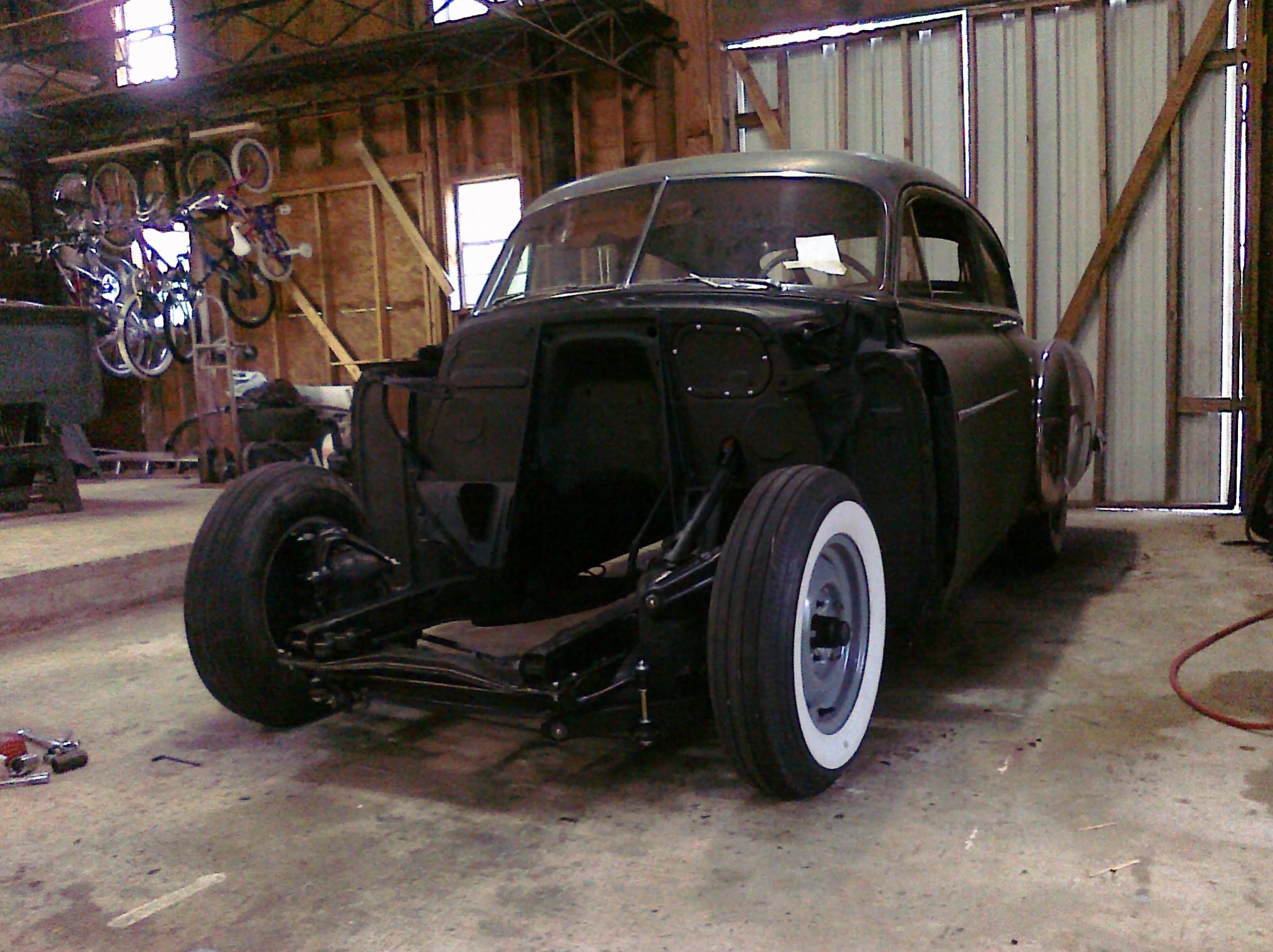

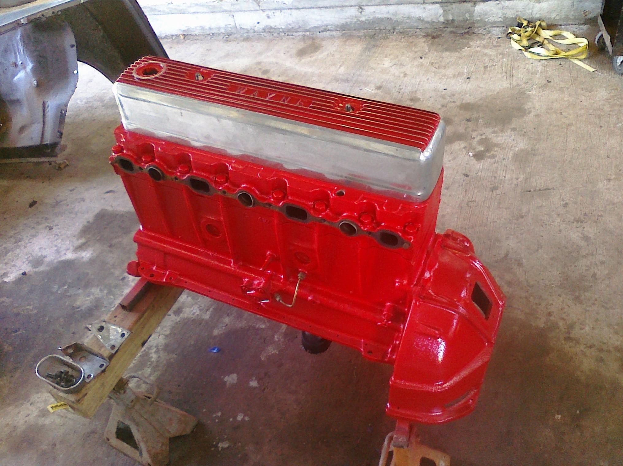

    Well its been awhile since i posted some pics of my fleetline project,so here goes nuthin,by the way im not computer savy so if the pics suck let me know. Also there is a another thread on here i started of the same car but dont know how to show the link.. I started off pulling the motor which was in pretty good running condition, and regasketed everything, painted it. My main focus is not the motor so i kinda wanted to leave it stock and reliable. Im really focused on the exterior and the interior, i want to build a eye catching 60's style custom. While the motor was out i tackled the front susp..I rebuilt it and stepped the lower control arms and cut 2in out of the coils. I really want a low car without bags.. nothing against them, but this car i want different. I reinstalled the motor and moved to the rear susp. i pulled out all the old susp for now to see where it would set.It looks good in the pics not to low and broken looking. Im debateing what im doing for the rear susp. too..maybe some long trailing arms and coilovers. Im at a good stopping point though. This was all done about a month ago. Im haveing heart surgery in a couple of weeks, so i get some updates out after im healed up .Dont worry ,doc says its routine(VSD" heart murmur")surgery. Yeah its sucks im only 29 and having heart surgey, but gotta have it done! anyways enjoy the pics!:)

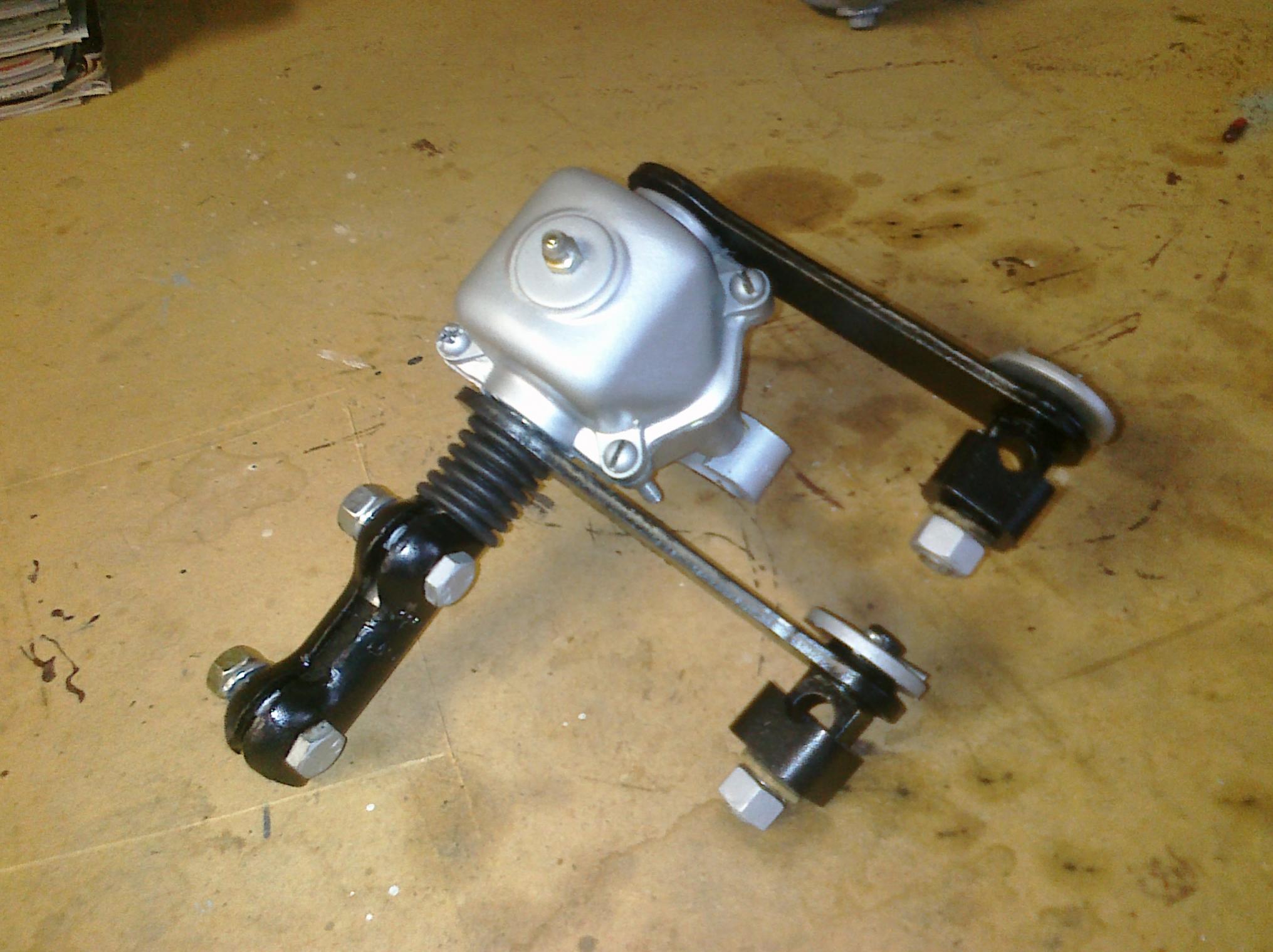

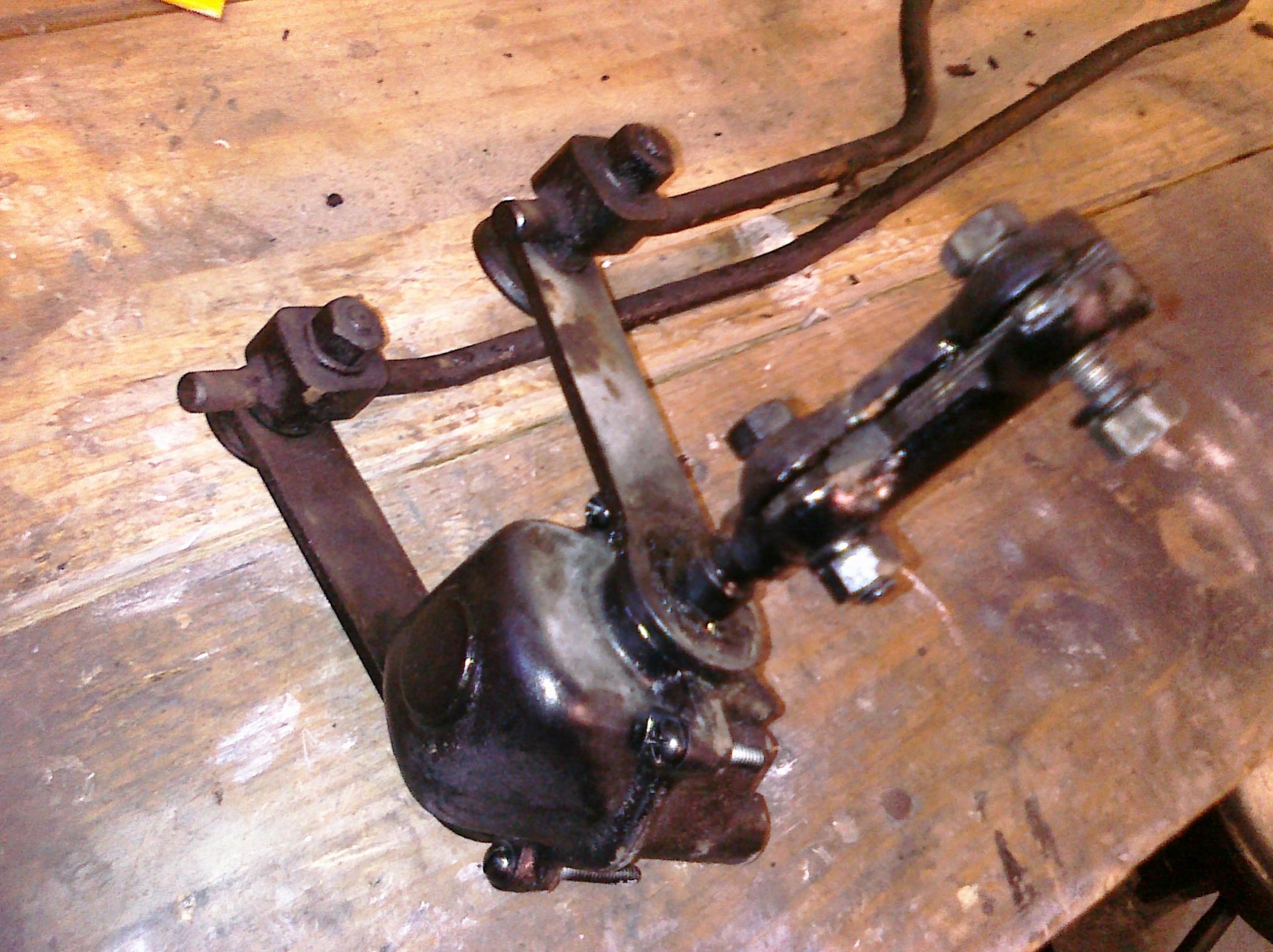

    Well, since i cant get any "real" work done on the car and im stuck with light duty work . So i rebuild my shifter mech. this morning. It was kinda cool in my shop this morning so i sat at my workbench and got somthing done. Here is a before and after pic. i think it turned out pretty good. I also added a grease zerk to the top for easier lubing.

    Well I'm back! had a heart cath done at Texas childrens hospital in Houston. They put a camera though my main artery at my groin and checked heart pressures and also checked for blockages...everything checked out good! My heart is working as it should besides the hole in the left and right lower chamber wall. They said I could live a normal long life with a hole in the chamber wall. But if the time comes and absolutely need it repaired they will.doc said all my symptoms were from anxiety ....I guess it makes sense cause I was worrying day in and day out. But know I know the good news I feel alot better
    So now comes the fleetine .... Sorry she's gonna be on the back burner due to hefty health insurance deductibles . But I do have some spare money to get my black 51 sedan presentable for roundup this coming next year. So most of my parts ,wheels,and fresh motor will now go in and on my sedan. I guess we can call this the 51 chevy build now. So I've been busy the past week on the transformation. pics of my progress on the 51 soon!

    I don't want to piss on this parade, but, aren't those lower arms just a little out of level? Is it sitting at ride height now? You did mention low with no bags. The lower arms should be level to the ground so you can have some suspension travel. If not your gonna bang pretty hard no? Also 2 inches out of the springs is pretty aggressive. I think. Why not dropped spindle supports?

    yes they are out of level...it won't affect ride quality.I've lowers numous chevys this way.....they actually ride and handle better. The uppers are at a higher angle due to stepped lower a-arms
