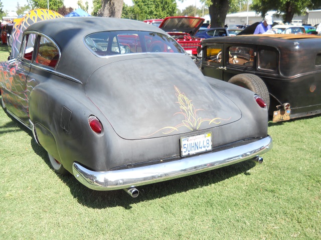

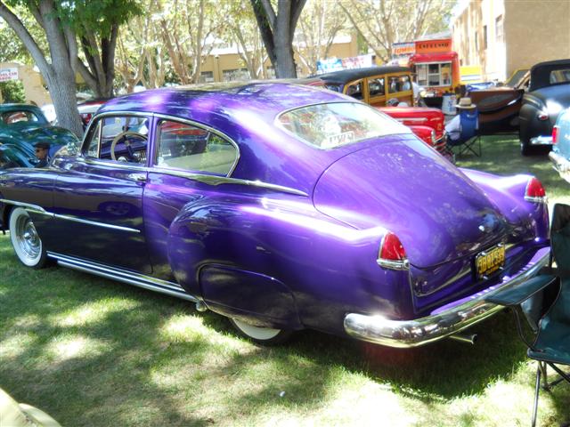

  3. Jalopy Joker
    Joined: Sep 3, 2006
    Posts: 25,062
    Jalopy Joker
    GG WC Nats 2012 083 (Small).jpg SAM_0932 (640x480) (640x480) (640x480).jpg SAM_1280 (640x480).jpg SAM_1279 (640x480).jpg DSCN8829.JPG DSCN8861.JPG

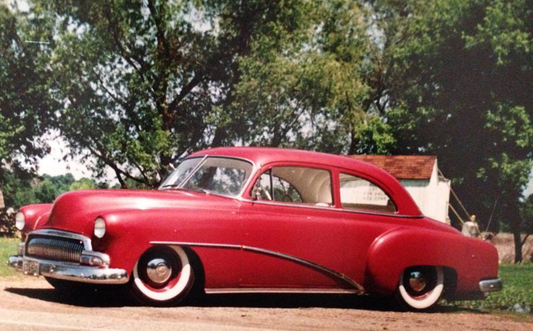

  18. Moriarity
    Joined: Apr 11, 2001
    Posts: 18,576
    Moriarity
    SUPER MODERATOR
    0BE6B9C4-5BB2-449C-96EE-02902158FDC9.jpeg F1EDA7E5-FCFB-4B24-A8DF-1BA4DE29499B.jpeg I did a 52 Chevy back in the eighties and swapped in 54 235 and used a powerglide rear end( just the ctr section) that gave me 3:55 gears and cruised great at 70 mph
