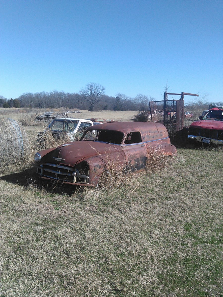

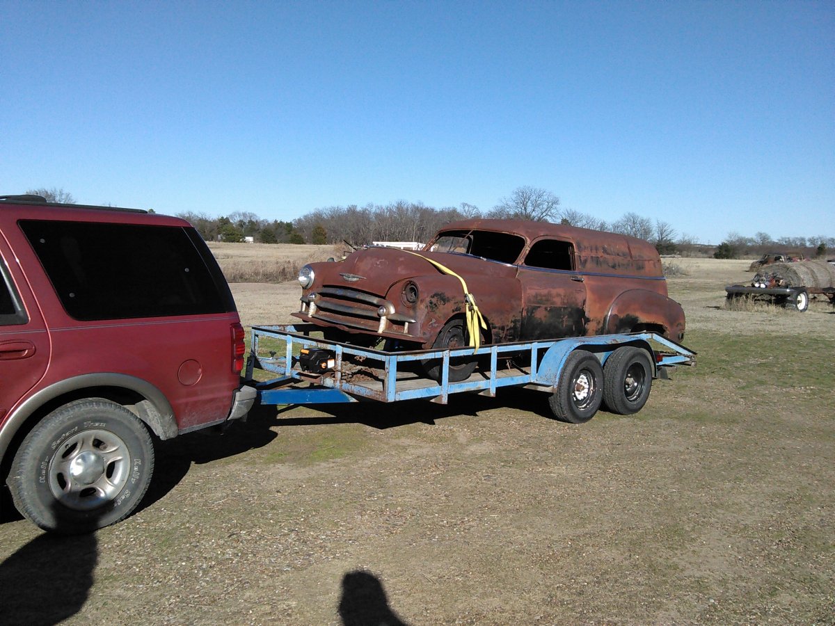

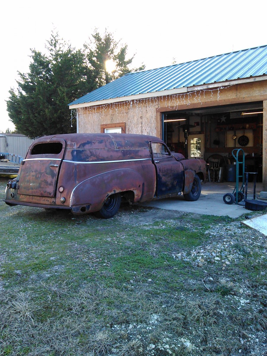

    I have been looking at this old car driving by it for the last couple of years, so today, I rescued it. I'm not entirely sure what to do with her, or how to do it, but I am going for it!
    Had to go buy three maypops to put on her, she'd been sitting there 10+ years. Got her loaded on the trailer smooth as silk, thanks to Harold, the now previous owner, and my good friend Dave, who was a trooper today!

  4. Well, at least you have the stainless moldings for it....super hard to get. I never did find stainless for my back window.
    It appears to have been pro-streeted. Did they massacre the rear frame? It's gonna take a lot of work to get it presentable again but it can be done. Mine was a lot worse than yours..

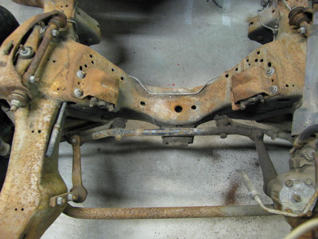

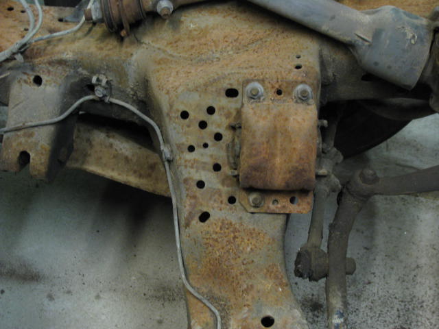

    Well I got the front sheet metal pulled off to take a good look. Does anyone out there have a good idea of what subframe this is? I am new to all this, so any help is appreciated! I don't recall ever seeing this many mounting holes for motor mounts in any car I have ever looked at....

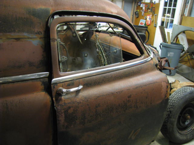

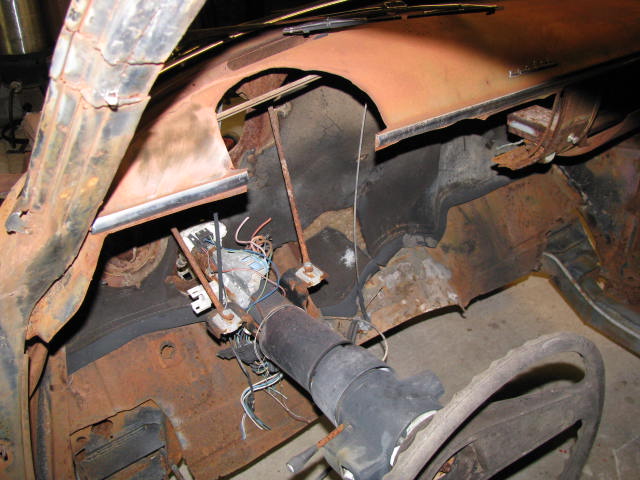

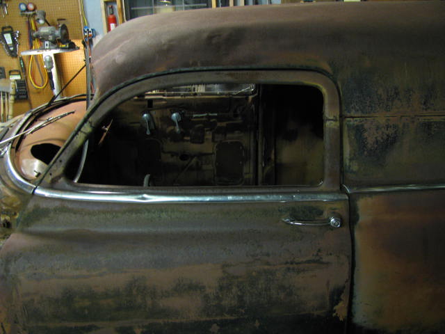

    I think whoever started this project didn't do it so well! The doors are sagging from lack of floorboards, it looks all catty-wampus as far as being level on the frame etc. I guess I will fix it!

    I have a 51 spread all over my garage right now so I can say with some authority... Jeebus! The good news is you bought a Sedan Delivery, so you'll have somewhere to haul your balls. Buying that one took a bunch of imagination and giant cajonies!
    That back half is not 50 chevy at all. Haven't seen any frame pieces yet that are. Depending on your plans, you may be way ahead to source another frame. Someone who knows SDs better needs to verify, but I think any 49-52 frame would work. In any event, a chopped delivery would be super cool so good on ya for saving it.

  14. front clip looks like 80's G-body GM..Cutlas, Regal, Monte, ect

  18. Looking at your total Chassis I'd say none of it is 50 Chevy, and the front clip is not Nova. Here is what a Nova looks like. 005.JPG
    Notice the outboard kick on yours. Probably more like a Caprice. If I remember right Delevery and sedan are the same Frame. I like your project. If it soon overwhelms you let me know first. I had one in 1970. It served as my Shop truck. I've always missed it. What part of the Country you in?

    My 53 chev had the same clip under it when i started it and to make all the front core supportsheetmetal fit, it was absolutely butchered to clear the steering box if it's gonna be clipped a 68 ish nova/camaro is a much better option steering box is behind the crossmember on those years..... I swapped the frame and put mustang ii on mine..... in my opinion i would be looking for a frame..... cool ride man, have a good time with it

  25. ...that delivery has another late model chassis under it, maybe Malibu or ?,...I'd get a good stock rolling chassis and get the body mounted on it after you fully brace up the body.

  28. The way that frame kicks out is not 2nd gen Camaro or Nova. Being front steer, I would guess it is like rockin rebel suggested, a late 70's GM A body/early 80s GM G body. They kick out like that.
    Looking at the motor mount, I think you need a few more holes, then you can have universal engine mounts to fit any engine with side mounts! Actually the extra holes are probably because those A/G bodies had a whole variety of engines used in them from Chevy/Buick V6 to multiple V8 options.
    The basic chop on that body looks good, but with the lack of structural support, hopefully it is square and usable. Getting a four door donor car is a smart move.
