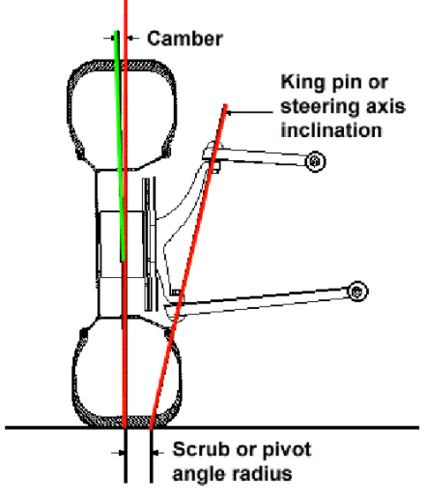

    ??????????? explain [maybe you've used the wrong terminology]
    "Scrub radius" is king pin inclination and wheel centre geometry on the front steering

    @Mimilan .....i think you called it correctly.....incorrect terminology. great illustration though of ‘scrub radius’.
    i think @Nostrebor meant “scrub line”........that no point on the car would contact the ground below the rim if the tire(s) were flat.
