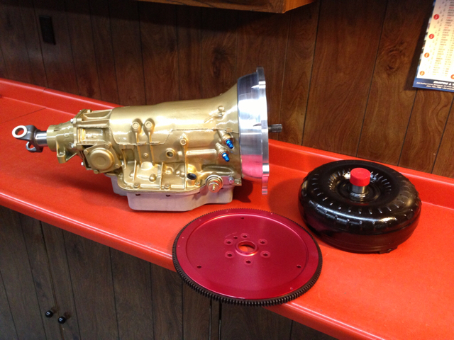

    We offer other options for the extended bell Caddys and Oldsmobiles ....... 350/400 turbo as well as a 700r4 ..... For the same potential cost as the rebuild of the hydro....
    Hnstray likes this.
