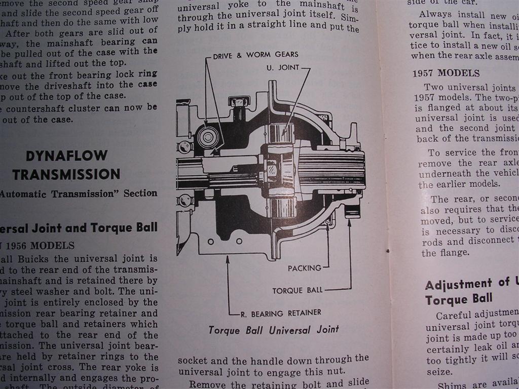

  7. F&J
    Joined: Apr 5, 2007
    Posts: 13,223
    F&J
    Did you think I forgot? Well yes, I did, and I rememered once, then forgot again :)
    Here is what I can find:
  8. loranzo46
    Joined: Apr 18, 2007
    Posts: 89
    loranzo46
    from pa
    Hahaha no i figured you were looking still just seeing if anyone else maybe knew too. Thanks for the pics with out of the manual That is a huge help. Very much appreciated.
