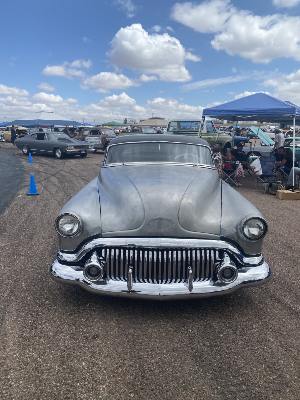

    In case this helps anyone, here are pictures of my '53 Special and a '53 Super I saw at a car show this year. You can see how few of the panels are the same, although it would be hard to tell if they weren't side by side. The '51s and '52s used the same bodies as the '53s.

    The rear fenders are welded on for the Specials, and bolt on for the Super and Roadmaster.
