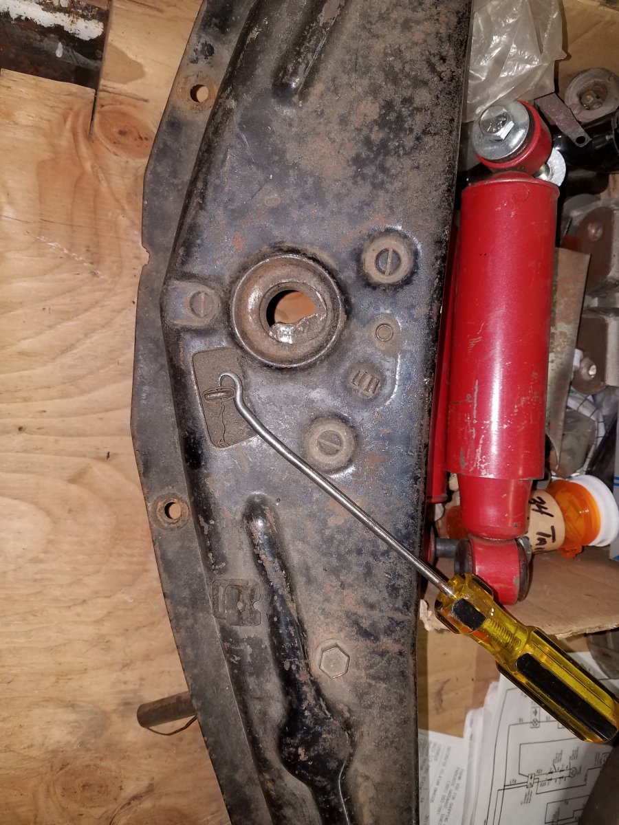

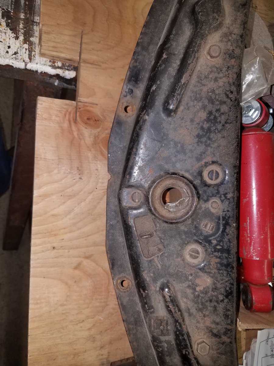

  6. To refresh your memory this is the latch installed and the cable fastens to that little short lever sticking up. Not much to get a hold of and you must pull it horozontal to get it to release. It's a Bitch at best. Note the wire wrapped around it.

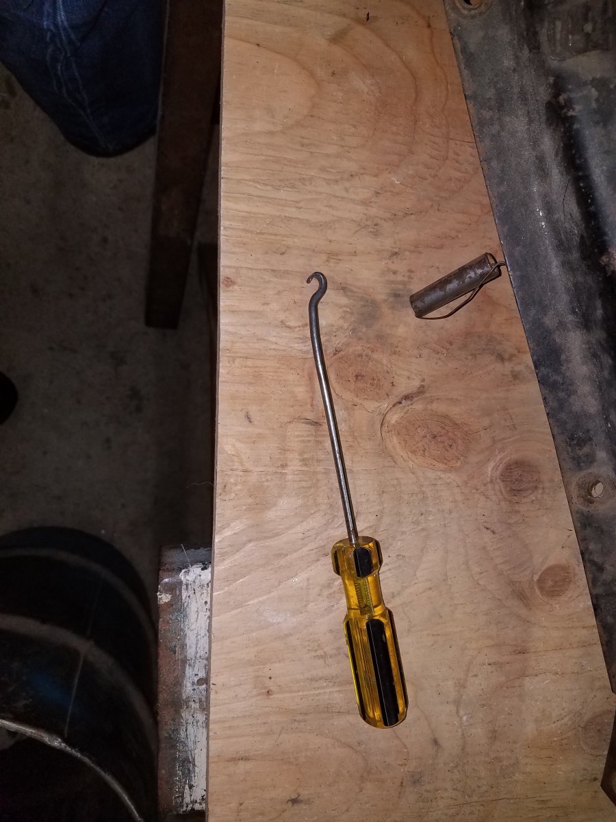

    20190513_065612.jpg So this is what I made to get the job done. I will explain that piece of tube further on.
    20190513_065622.jpg The reason for the Fancy hook is so that it stays in place while your pulling sideways. Getting in there as I remember really sucks.
    20190513_065639.jpg In this case Size really does matter in that space is very tight and angle of pull is difficult. This will give you something to work from. Having someone push down on the Hood to unload the latch jaw really helps unload the spring tension.
