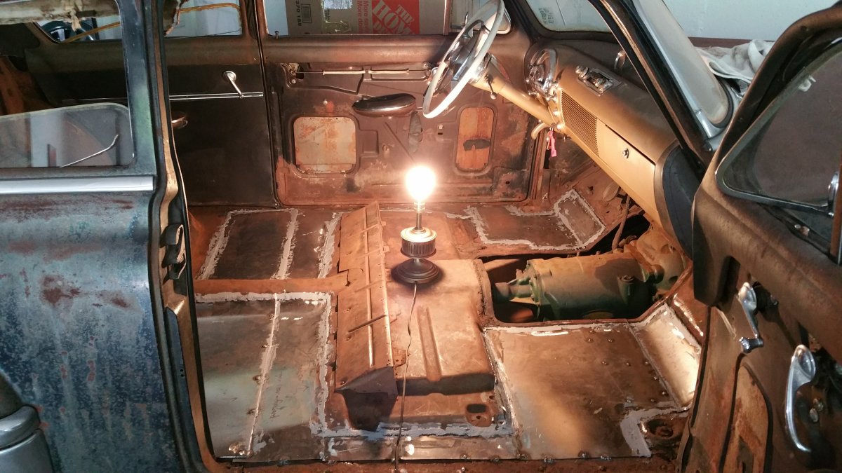

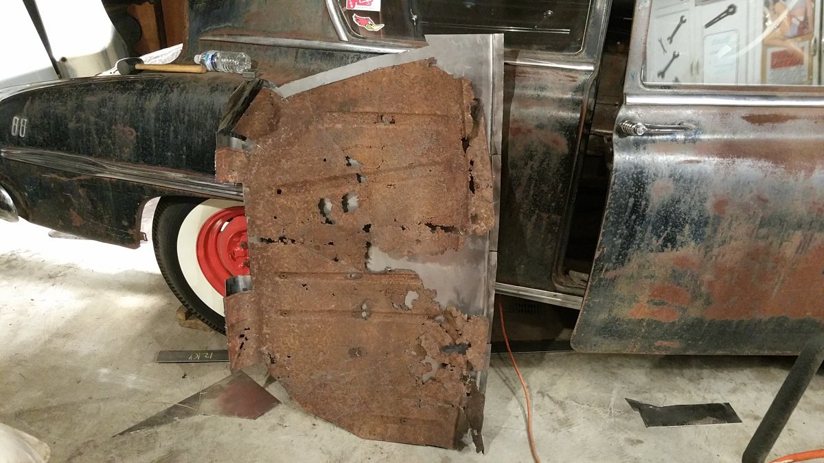

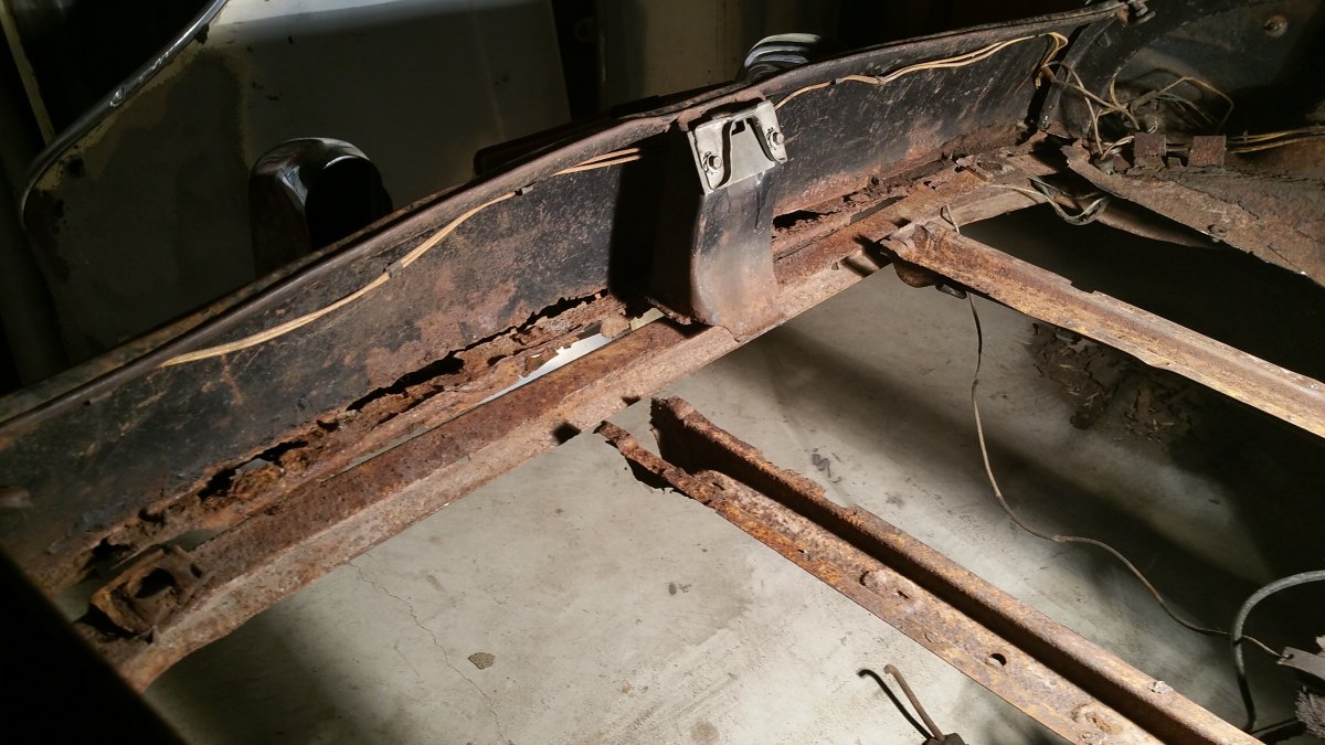

    I cut away the old rust in the floors and and prepared the structural members for new steel. The Chassis is rock solid everywhere and the only body member needing attention was this rear crossbrace that was mostly gone. So I fabbed one as close as I could with rectangular tube steel stock. Repro doesn't exist so thats the only way this car was going back together.

    Took the time to measure and cut closely and get a butt weld everywhere rather than overlap, used butt weld clamps to do this and they worked well. I was careful to replicate the factory seams just like they were with overlapping joints that are spot welded. Lost of strength! Also was careful to put spot welds on the structural members in about the same places they were on the old floors. The only thing my floors lack are the factory indentations. There are repro floors out there but they also don't have the correct indentations and they don't provide all the metal that I needed to fix my rust. Plus, this way I only spent about $100 in materials rather than $450. All I have left to do is stitch weld, grind, and seal.

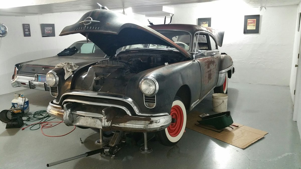

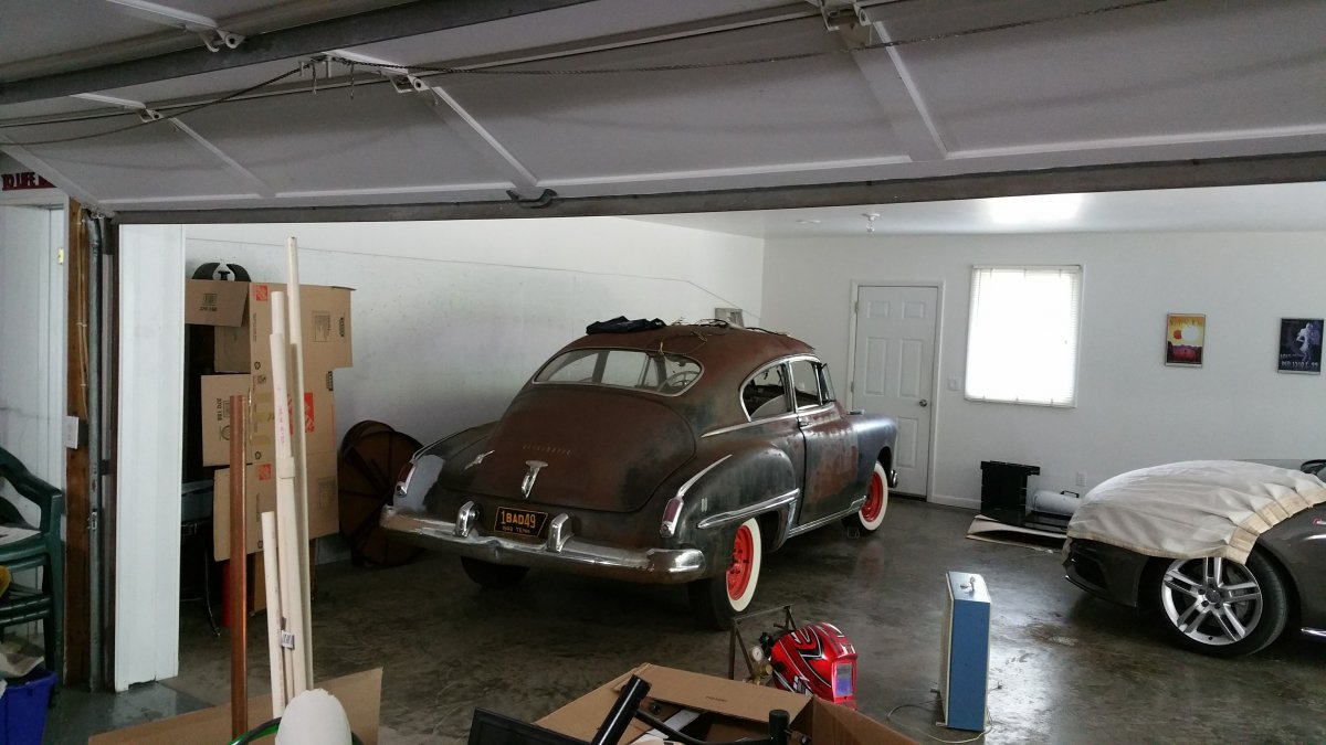

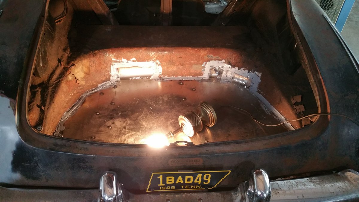

    A little progress.. more to come this year. 20160922_122737.jpg 20160922_122813.jpg 20160922_123453.jpg
