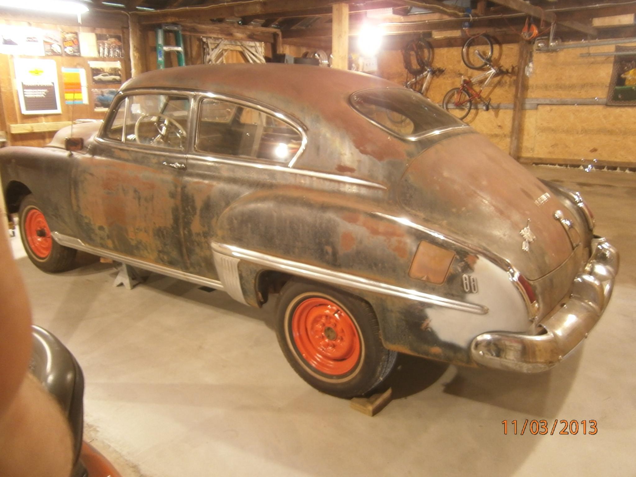

    Here is my project. I bought it in '09 from a guy who had it since high school which for him was the late '60s and his Dad bought it used in 1953. I have the title which his Father signed in 1953 which is pretty cool. The last registration was 1969 according to the stickers on the license plate. The seller told me he thought it had been parked and not run for 20 years but I think time flew by kind of fast and it was more like 40 years. Fortunately for me they put oil in all the cylinders when they parked it and the engine turns free. I tried to start it and got it to pop and nothing more. I checked the compression and it was only 50 some pounds in each cylinder and 0 in one. Pulled the engine, pulled the heads and did the upside down water test and the water ran through in minutes. More to come. Ideas, advice welcome, anyone working on similar cars let me know.

    Thanks for the interest and the advice. I've done some stuff to the car since I got it and I'll get some photos up in a few days. I just started really moving along with it in the last month. It kind of sat sleeping in my shop for a while..

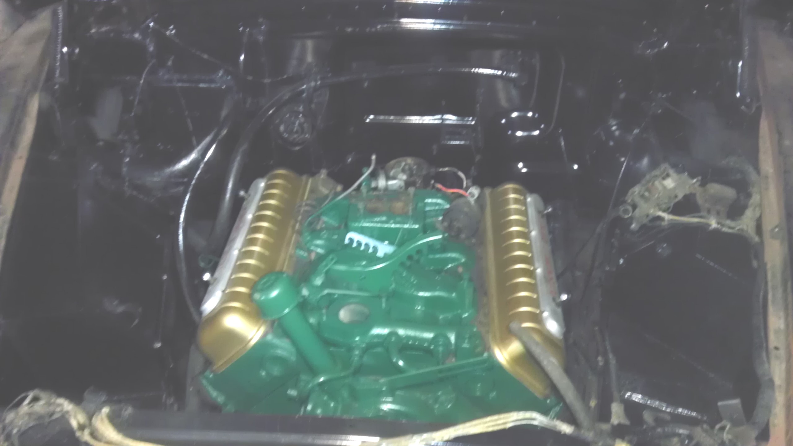

    I found out this engine and transmission don't go in the same as cars built after the early '50s! Since the engine has only one mount in the front middle behind the crank pulley and the transmission has no mount near the tail shaft the tail of the transmission will just hang if the engine isn't attached and so you have to support it or at least I felt I had to! :rolleyes: And if the transmission was removed then the engine would have to be supported from below with blocks. There are also exactly 30 small bolts that seal the fluid coupling between the engine and transmission. Yeah, not as simple as a torque converter! And the seal must be carefully installed so that it doesn't leak. There are pegs between the ring gear and the fluid coupling on the trans as well as pegs between the engine and transmission casing. And of course in the center of the transmission there is a large shaft that had to slide into the back of the engine. They all only line up one way. To slide it all together I had to pull out all the tricks and have a jack under the tail of the transmission and the engine hoist on the engine and go up and down slightly with each and jiggle the engine and use a board to push and coax them together getting all the pegs to slide together one by one. Not to mention the car has to be raised as high as possible to get the transmission under and lowered to get the engine over the radiator support (because its so tall) and raised again to get under to mate the two.
    Lots of fun and it went together pretty easy considering. 3 hours on a Saturday and 3 hours on a Sunday for the engine. But the transmission took about 4 hours on a seperate day. That was tough its own fun considering I don't have a transmission jack. I used a come along thrown over the barn joists and hooked to the top of the bell housing to pull it up into place and that is about when I found out it wouldn't fit between the dog house and the cross member. So once I took the cross member out and attached it to the transmission and then raised the whole assembly into place it was all down hill from there. :D
    I had help on both ends but actually lowered the engine in myself one night. Thought I was going to just get everything ready and before I knew it I was opening the valve on the hydraulic ram to lower it with the left hand and pulling a chain with the right to guide it down. It went straight down onto the mount very nice and easy. That was the only easy part.

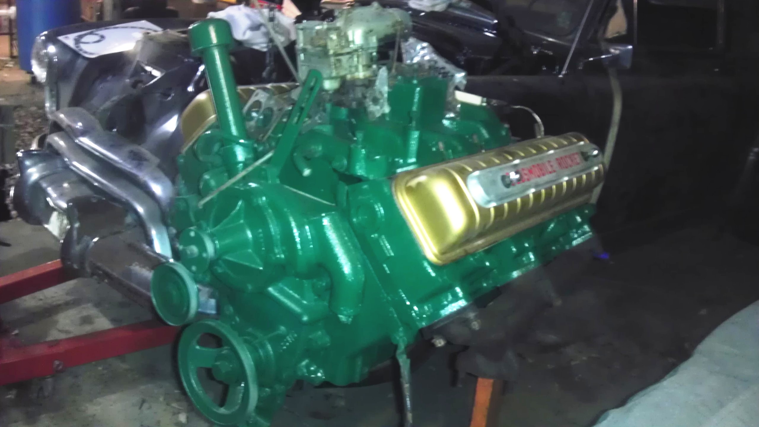

    CGKidd - good timing, I just came back on here after being away for a while. Its cold out and that gives me the itch to be out in the shop with a heater on. It feels like a lot more than a year since I touched this car but I got the engine nearly assembled now in the last 2 couple weeks. If it stays cold through January I hope to have it running and driving :D. Once that heat sets in its patio bars and the lake! May be I'll be able to take this. The next hurdles are going to be to find out if the transmission is okay assuming the engine fires and runs well. Then I'm going to have to build my own wiring harness or shell out $700 for a replacement, because mine is ate up by mice. As long as that goes smooth I'm on my way.

    I'll get a couple pictures of the rocket engine re-assembled in the week. I'm doing it all original as long as that engine is solid which I think it is - I had the heads rebuilt and I've resealed most of it but I didn't touch the internals other than to inspect. I found the original red color that was on the wheels from the factory because I didn't want the common rustoleum red. Its available online after a lot of searching.
