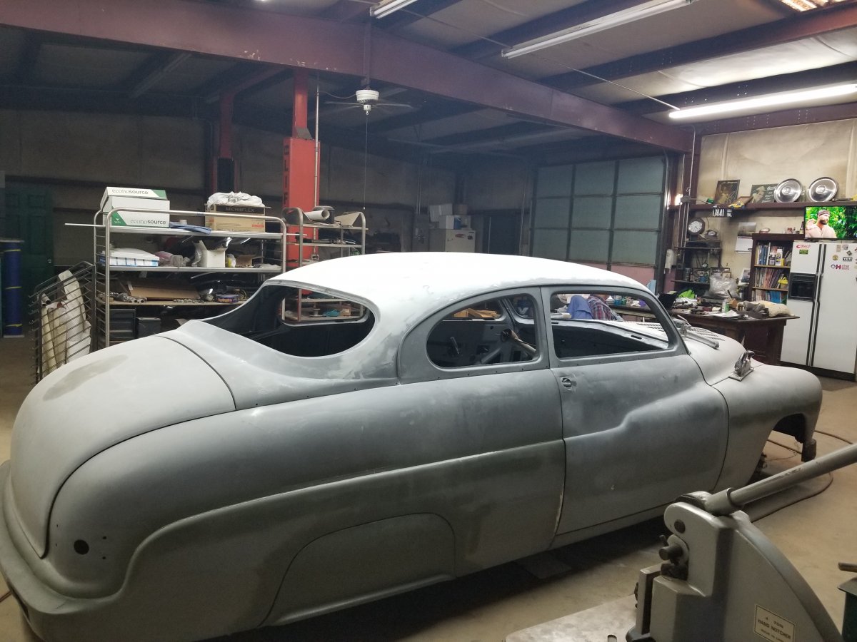

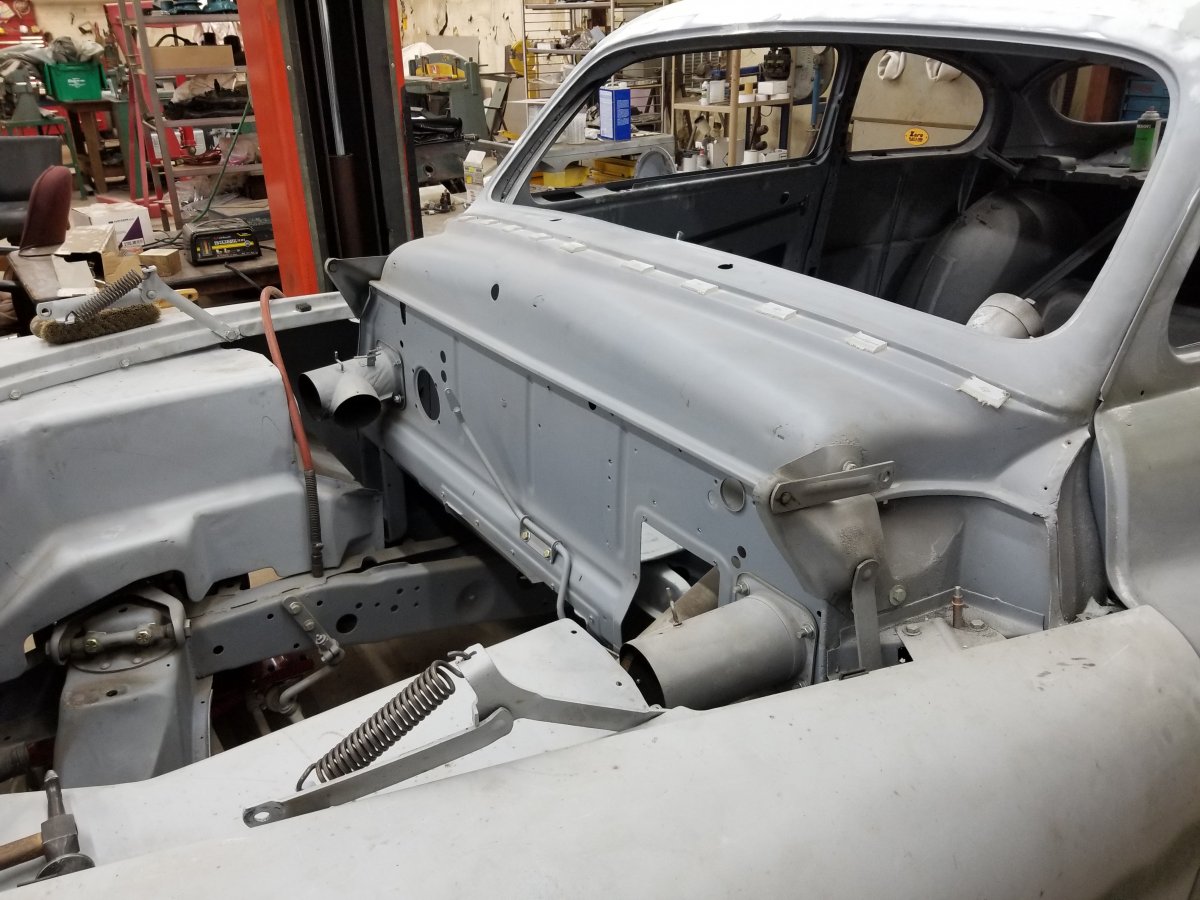

    Its been a while since any updates but work is still going on just slowly so here's a bit of an update. I got the roof done a while ago, basically after clecoing everything together I used the pullmax to make the center strip , then was just a matter of spending a couple days welding everything together. The reason I took so long to weld was because I knew the roof was going to shrink simply by welding on it. So to at-least save myself from more work later, I would just do 1-2 tacks then move about a foot away , a couple more , repeat that way the metal had plenty of time to cool and didn't build up excessive heat that would make later panel hitting harder. 20171128_160936.jpg 20171129_212403.jpg 20171225_142853.jpg 20171229_173741.jpg 20171229_173754.jpg 20171229_173811.jpg 20171229_173847.jpg 20171229_173918.jpg

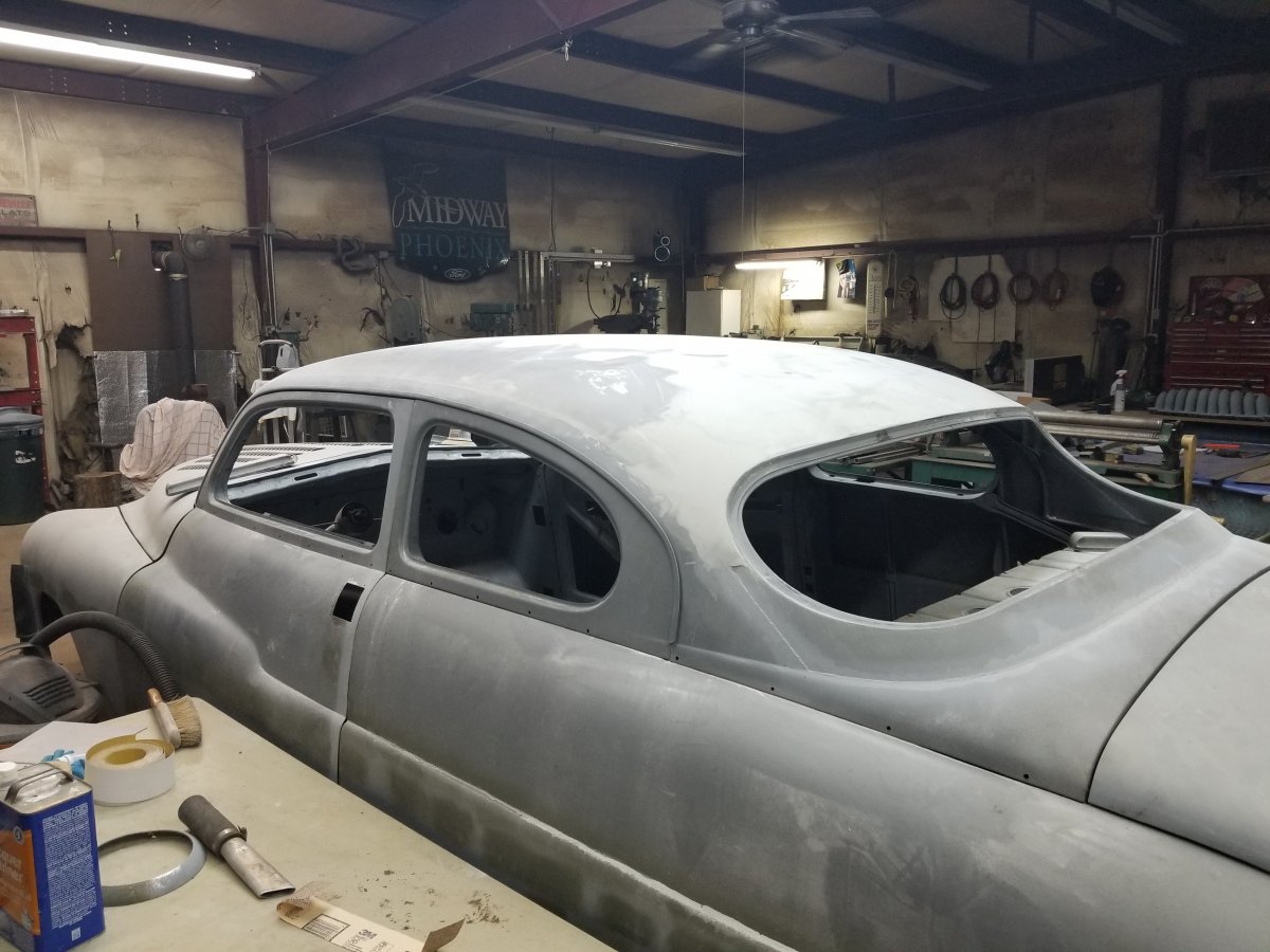

    So after getting the welding done i started doing some bodywork on the roof and that's alot of whats taking forever because honestly... i just don't enjoy doing it so its hard getting motivated..but the roof is almost done thankfully.

    Looks great. I'm the same. Metal Fab is fun. Body work not.

  6. Squablow
    Joined: Apr 26, 2005
    Posts: 13,065
    Squablow
    Nice job on the decrowned roof. I had considered something similar, with just a more laid-down rear window on an otherwise stock height roof, to take out the back seat head "bump". I'm not that far yet though, and your car looks really good, I like it.

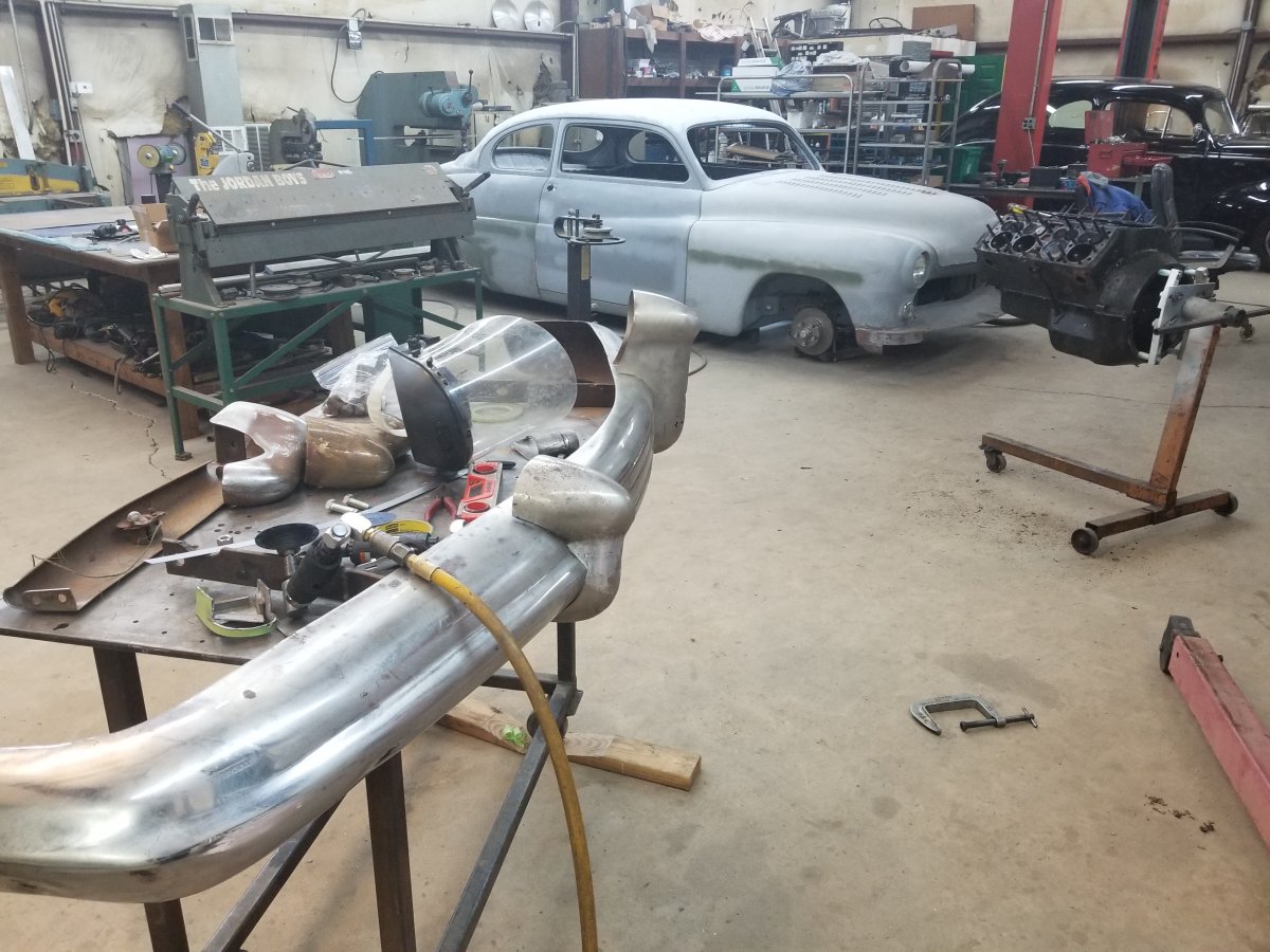

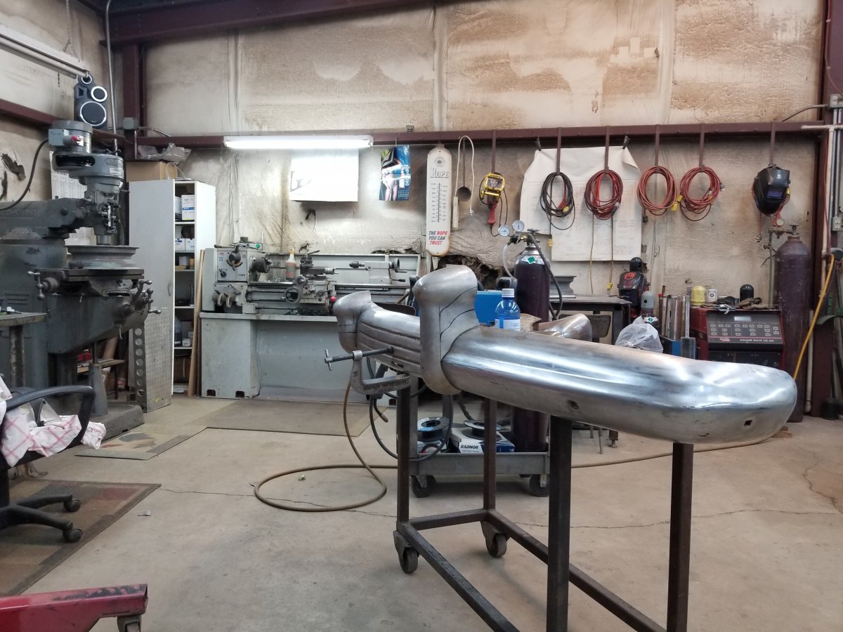

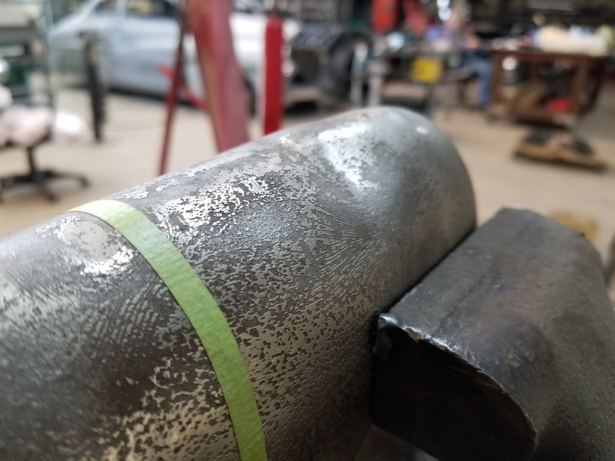

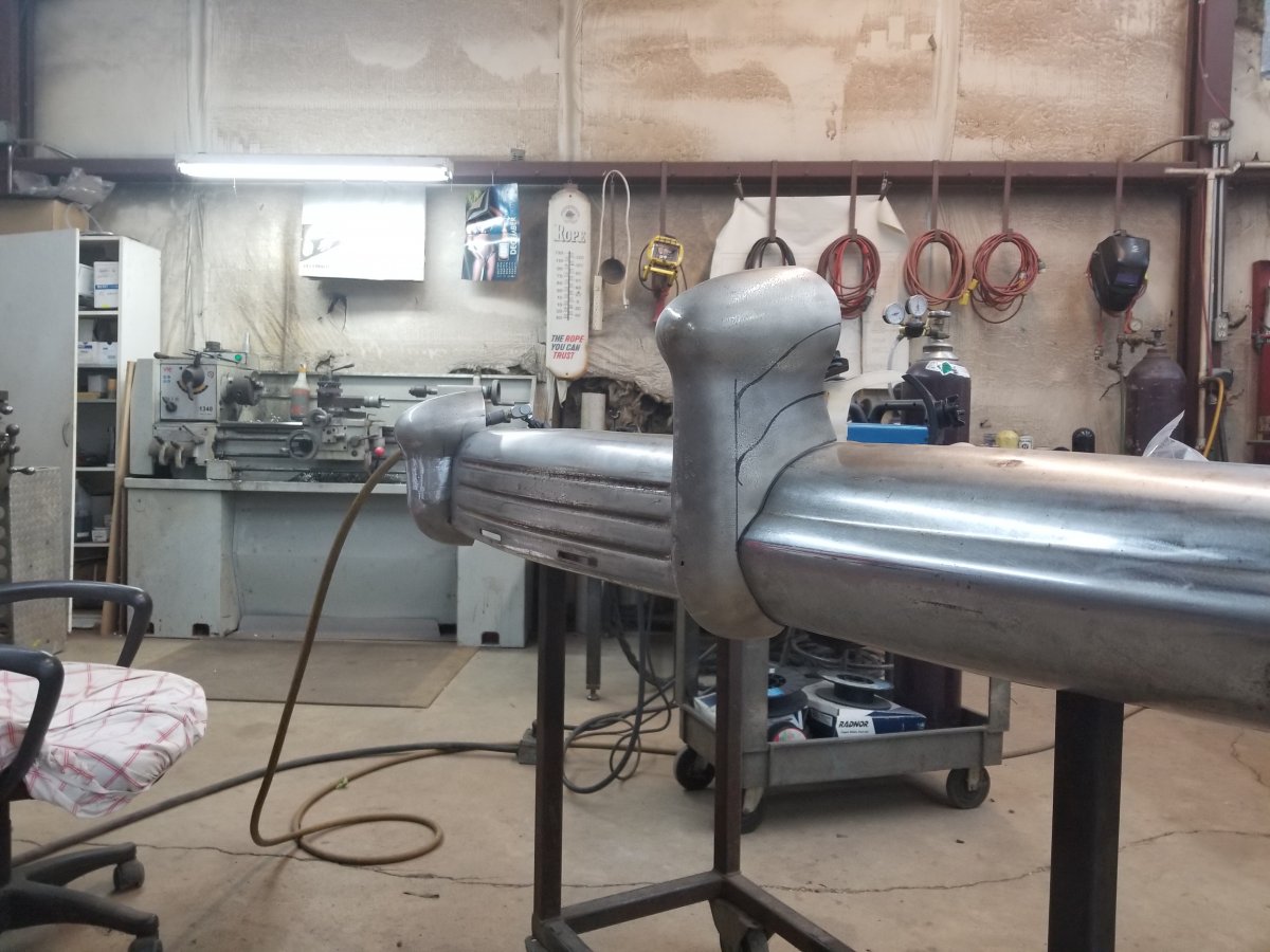

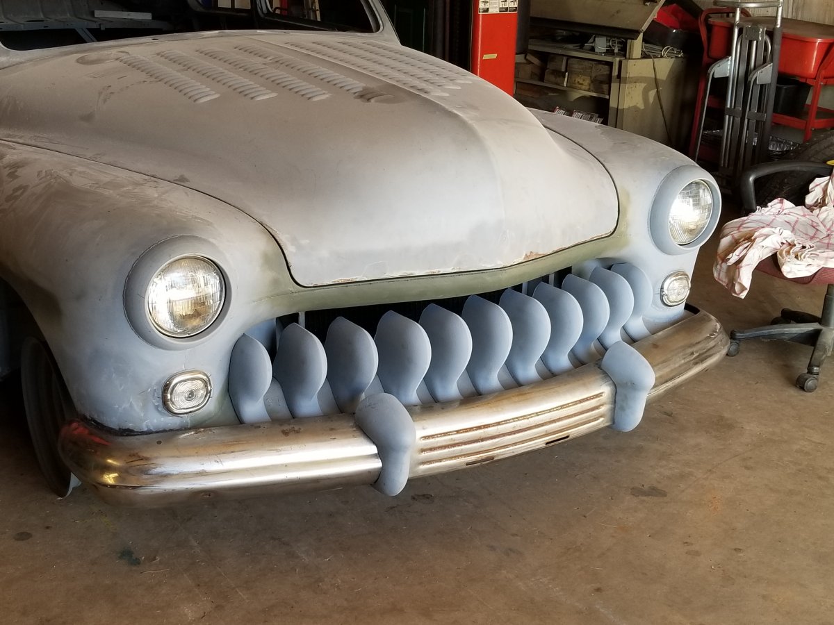

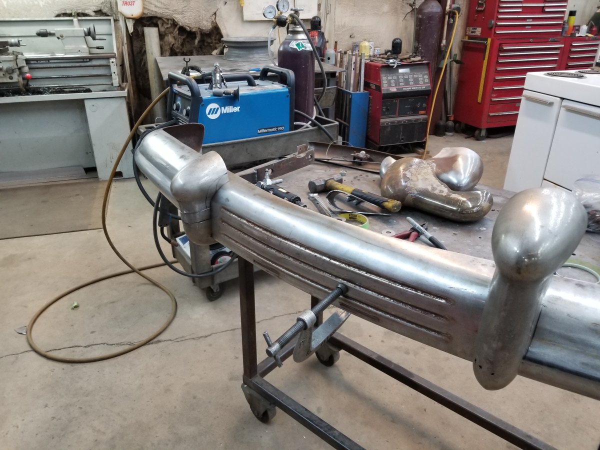

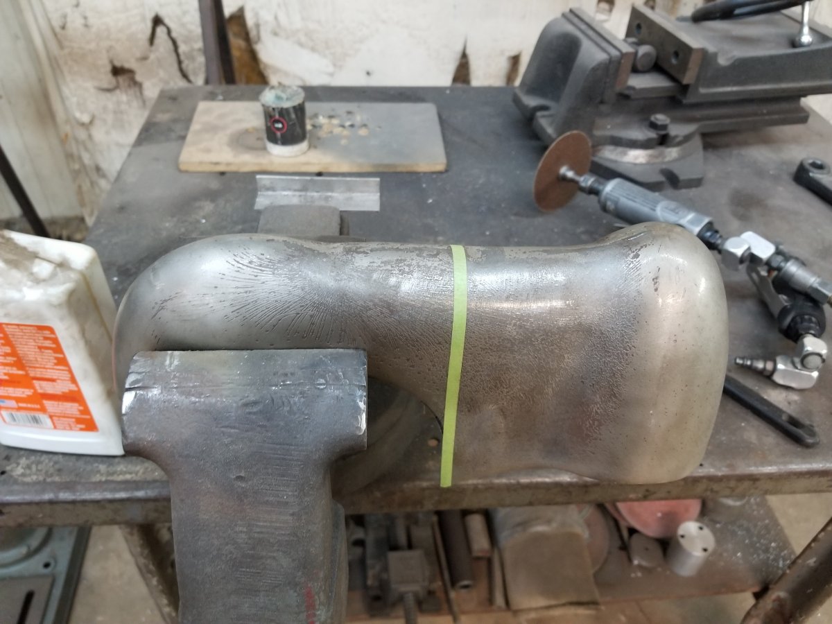

    So besides just taking my sweet time I've started to work on something a little more up my alley; back to doing something with metal.
    The front bumper I'm using is a 51 mercury bumper which I prefer the look of over the 49's , and I like the bumper guards style.... just not the size of them. So that's what i'm working on now is getting them cut down a bit so they mesh better with the Desoto grill.
    First I simply welded the bumper irons to the bench because its a little easier to work at a manageable height. and I used the drivers side as the reference whial I did the passenger side , and seeing as it was the worst condition it was a good testbed. 20180205_144652.jpg 20180205_144704.jpg 20180205_152455.jpg 20180205_153137.jpg 20180205_170020.jpg 20180205_170029.jpg 20180205_170039.jpg 20180206_163054.jpg 20180206_163104.jpg 20180206_163115.jpg
    And so now one down, now all i have to do is match the other to fit the same way. But i think these will look a lot better than how tall the originals are

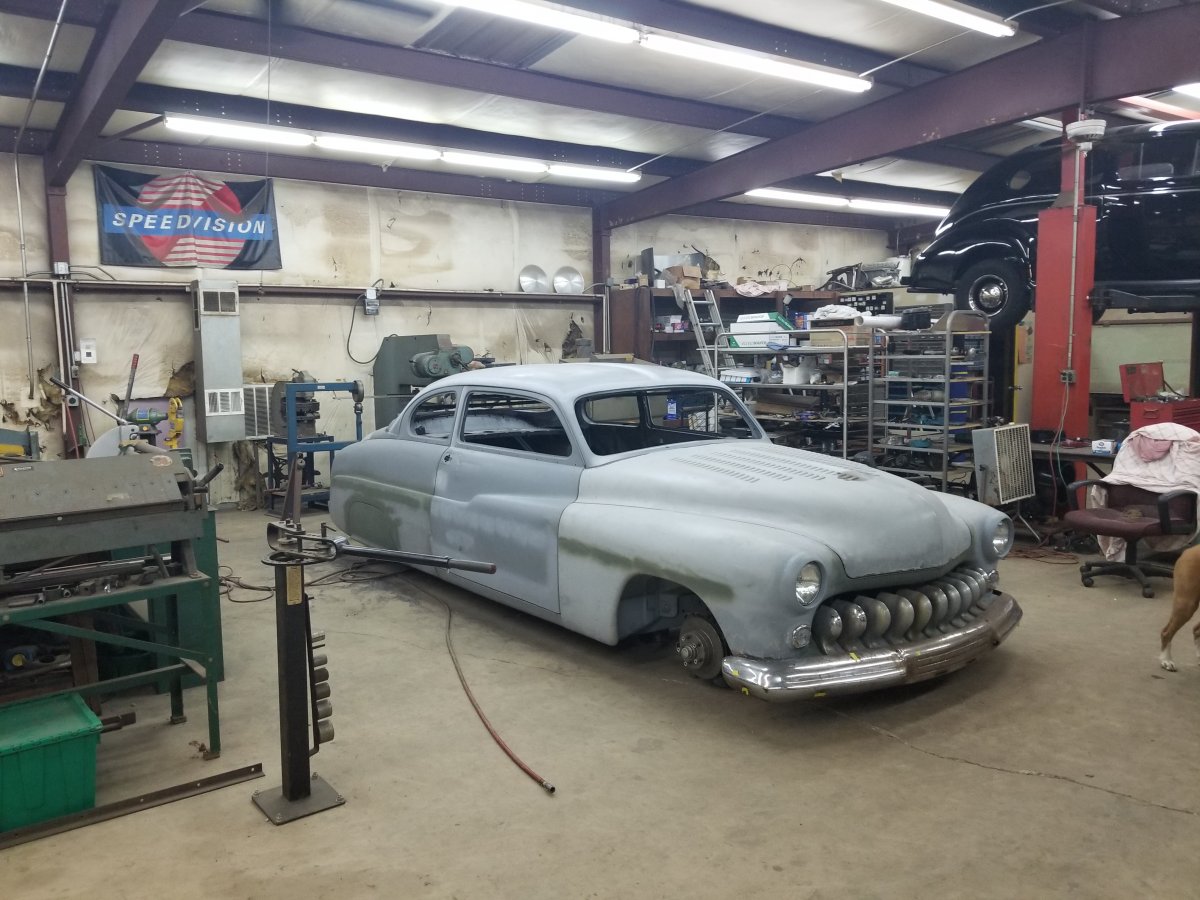

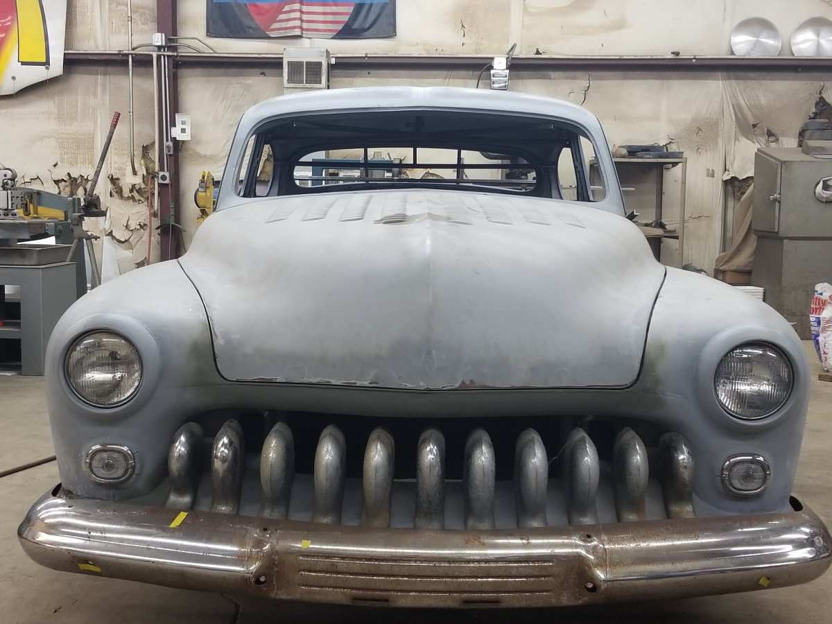

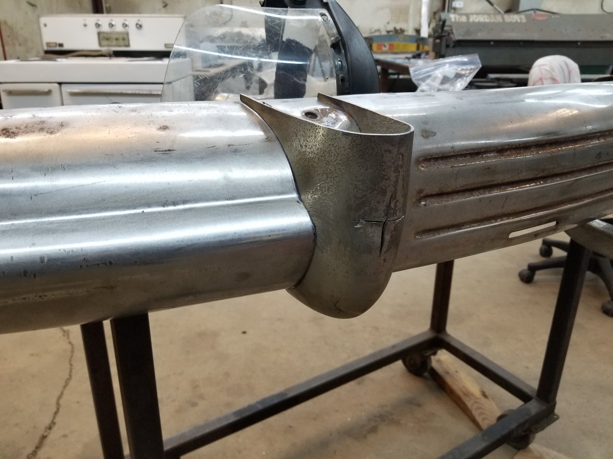

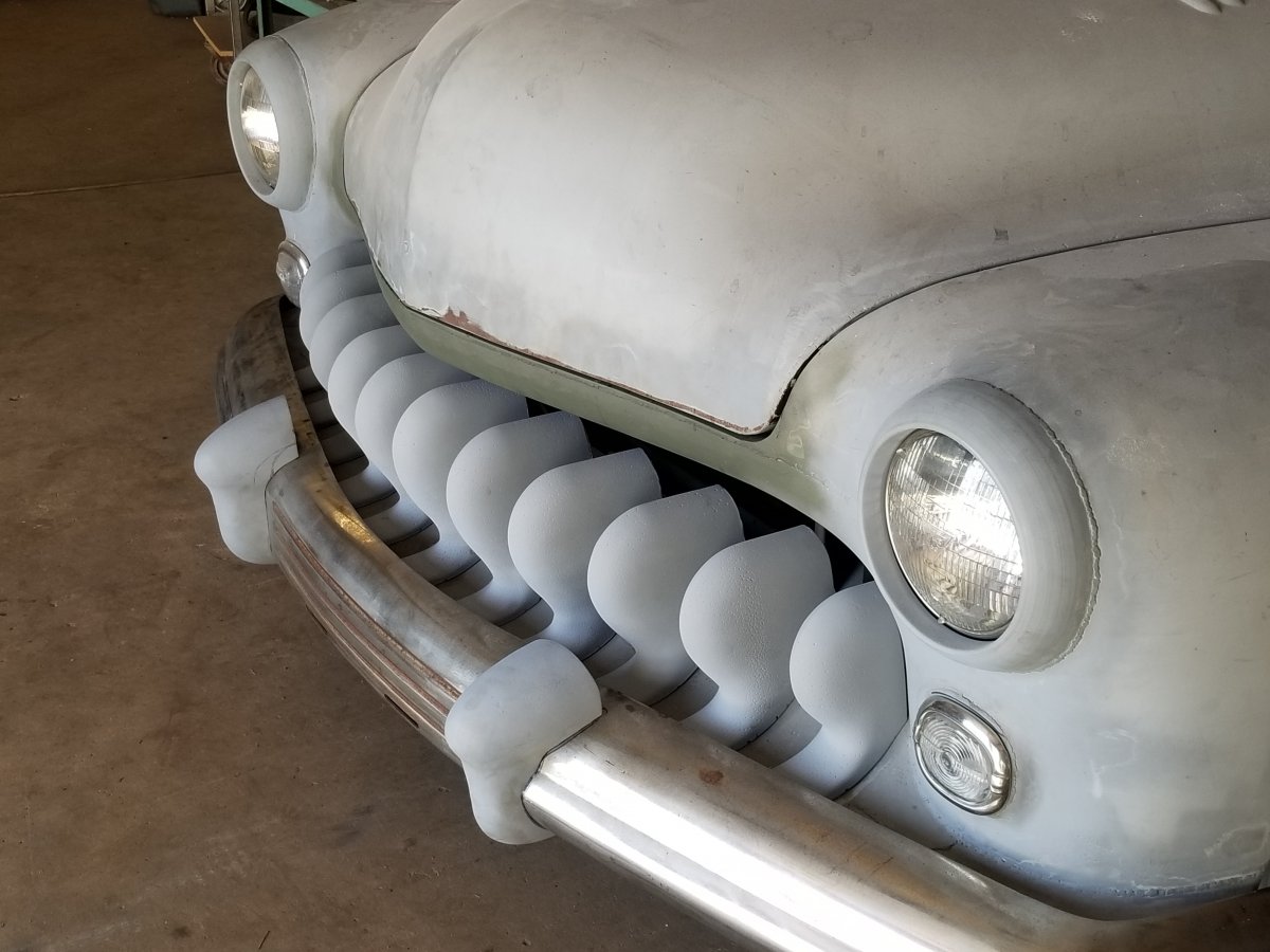

    So basically just doing the same thing to the other sides bumperette.
    Putting everything back on to see what it will somewhat look like , and personally i think it works well with the grille they don't overshadow it anymore.
    20180218_153826.jpg 20180218_153836.jpg 20180218_153850.jpg 20180218_153910.jpg
  10. 1-SHOT
    Joined: Sep 23, 2014
    Posts: 1,049
    1-SHOT
    That is a whole lot better looking. They were way to big before kind of like overpowering. Frank

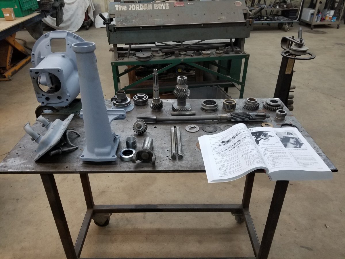

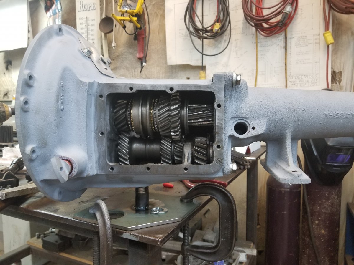

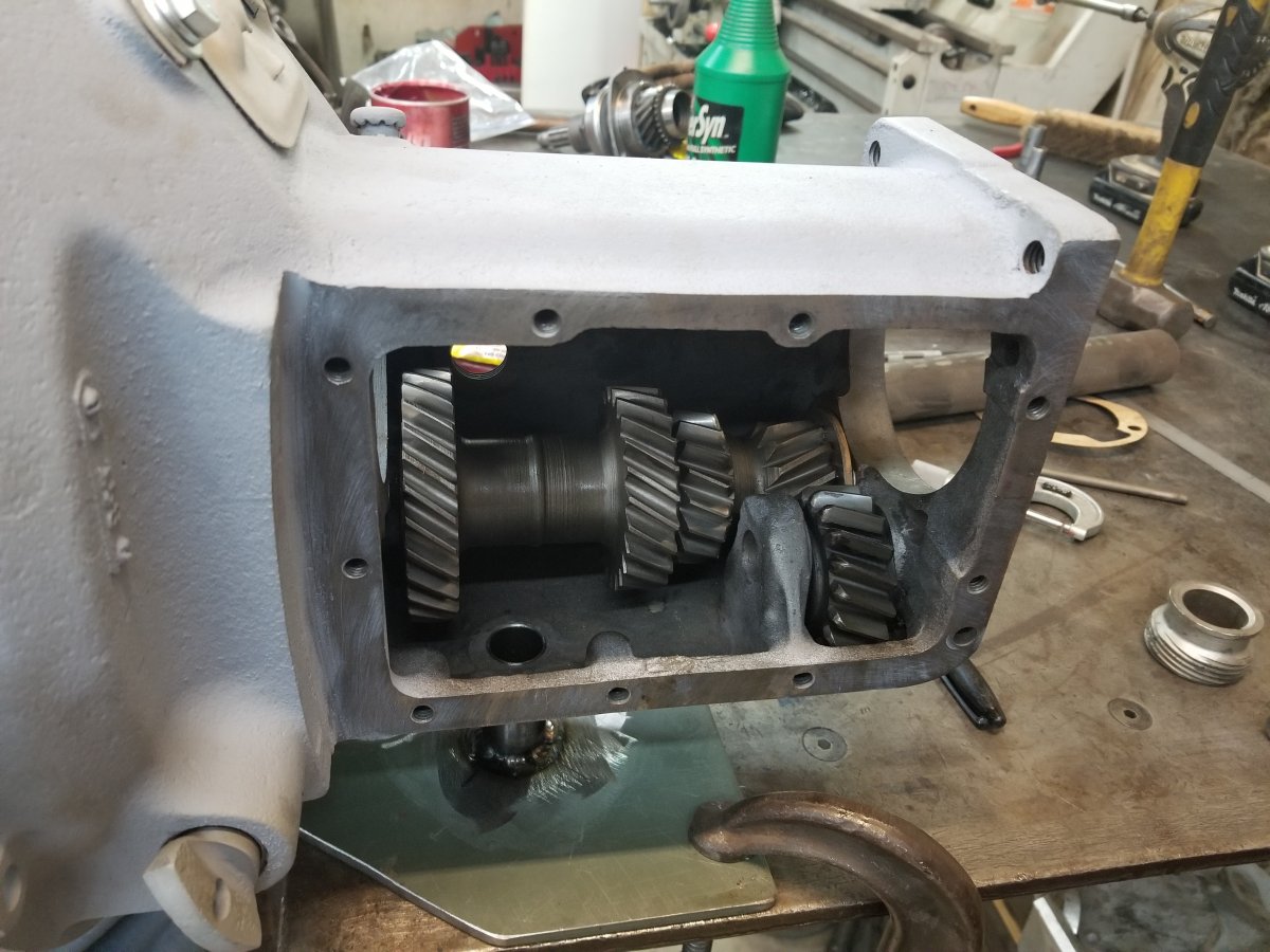

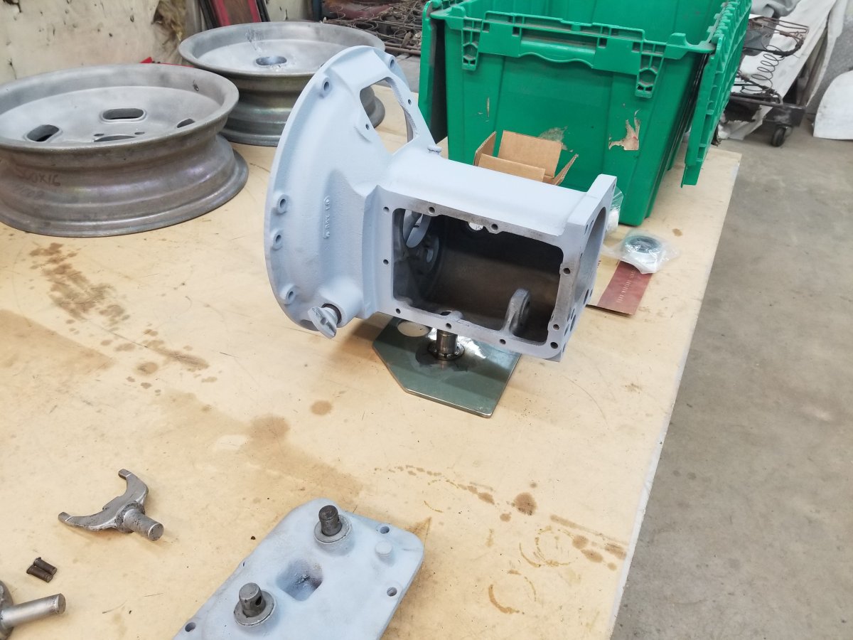

    So the transmission rebuild is turning/turned into the project that never ends.
    So first off this is a 49 mercury transmission and im trying to put 50 ford internals in it... yes i knew there was going to issues... and i found them and fixed them but jeeezzzz.
    First off even thou mercury and ford have the same part numbers for a lot of the parts does not mean they are in-fact the same... basically nothing in a mercury is the same as ford...
    So to start the delays.. i ordered all the parts from macs and everything was great... until i got to the cluster gear roller bearings... see the mercury uses a cages roller bearing and the ford uses loose single bearing... so the product is a caged bearing that says it works for 50 fords... well it works for the 49 mercury but no dice on the ford gears as its way to big to fit...
    Thankfully between the 2 gearbox's i was able to get a set of bearing that weren't brinelled so used those.. then go to put everything together, now the clearances are very tight with all the new special washers... so tight you in-fact cant even get them all in let alone have the lower cluster spin.. now I'm not talking by a lot in total between all 3 special washers only .005 but that was enough to stop everything from working.. so had to use a set of the original ones that admittedly were in great condition but i thought hey new is better.
    One of the final and honestly the dumbest problem i had that took ...2-3 hours of frustration.. and it was the easiest and dumbest problem to solve...So the gearbox tail-shaft housing is held on by 4 bolts... so put new bolts in... what i didn't expect/remember was that the lower gear cluster is very close to one of the bolt holes so if say you have a bolt that's just a little too long it will start hitting all those washers and in effect lock up the gears... making for a very confusing wtf is wrong now moment...aka remove the one offending bolt grind an 1/8th of and taadaa everything works perfectly now.

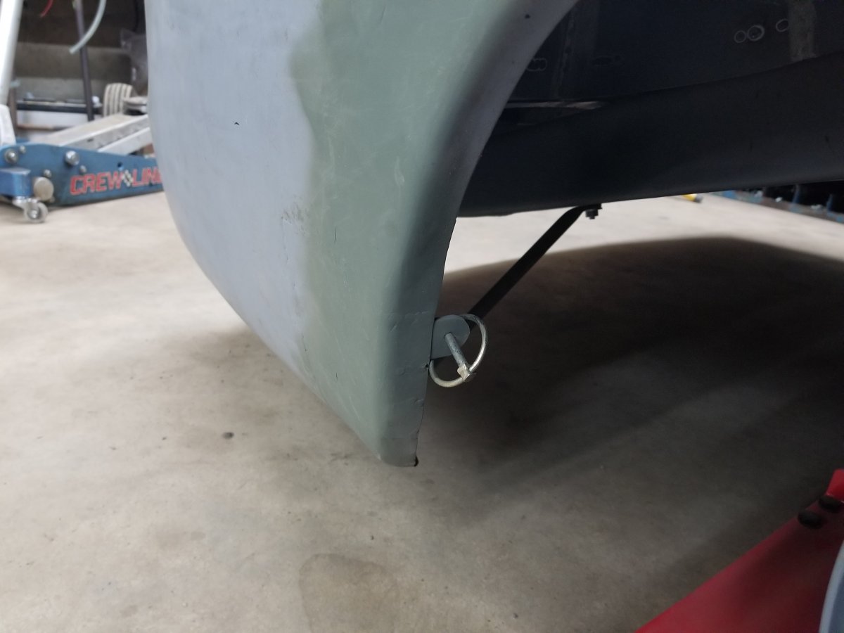

    Sure thing Marco,
    So I started out first just getting the skirts to fit nicely in the opening I had.
    The idea of how to attach these was kind of stolen from a Oldsmobile holiday 88's stock flush fender skirts. They had 3 sheet-metal pieces bent in a V on the very top of the skirt that slotted into some slots in the fender's lip, then some brackets that bolted everything together at the bottom. So I wanted to do something similar because it was a simple solution to something I'd never thought of. So I started by drilling 3 holes the same size as the metal dowel pins I made into the flat part of the finder lip around the center (width wise) and, then carefully making sure the dowel pins are perpendicular to each other and in the actual holes I'd drill I tacked the pins to the fender skirts. (well then untacking when you couldn't get it out because one is tilted and locks everything up and trying again till everything actually works) So the pins lock the top of the skirts in/out and forward/back and make it so they can only go up/down if nothing is locking them in. To lock them in place i made a set of ears for the car and skirts drill the hole for the car side first then put the skirts back on and center punch the skirt side so they are perfectly in line, then just drill both holes to be the exact clearance of whatever pin you want to use. I'm using some lynch pins from tractor supply because they work great for this application. Hope this helps you Marco 20180316_211216.jpg 20180316_211227.jpg 20180316_211259.jpg

    Thanks Mbartills. It did help a bunch. I have already made the skirts, but after seing your project I will change mine. I am including a picture of where I am right now. Parts have been media blasted and primed, but now back to work to make it perfect. Thanks a lot. IMG_4472.JPG

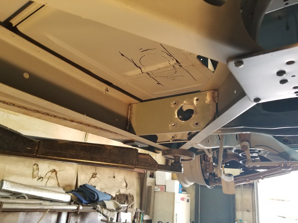

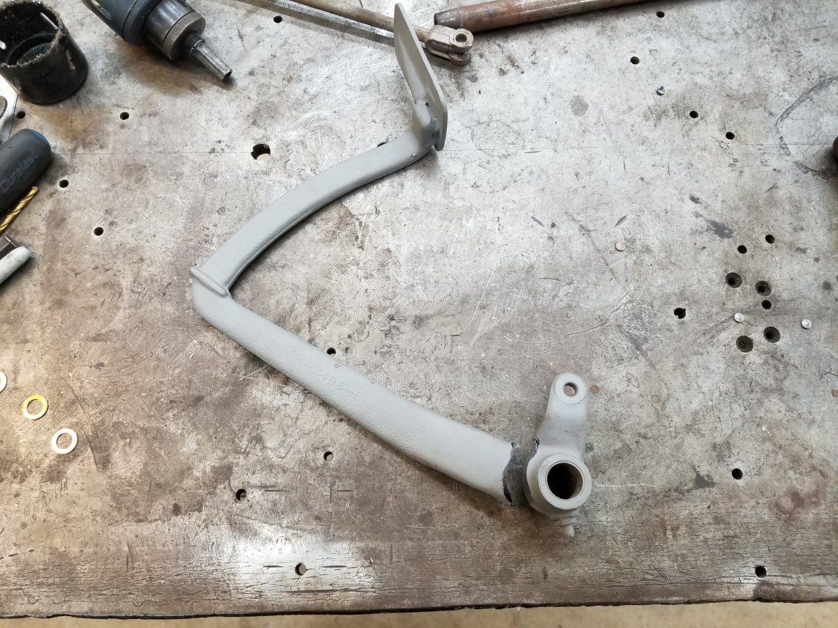

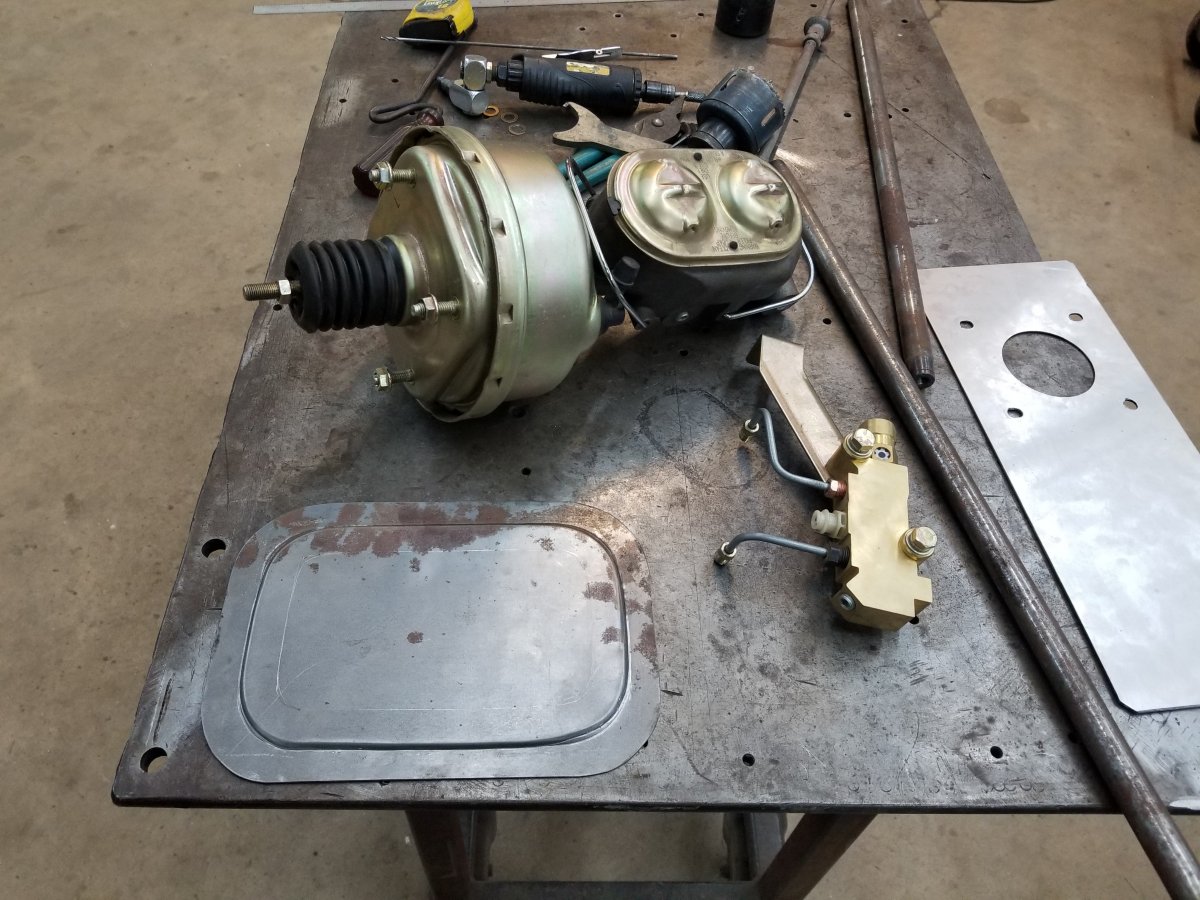

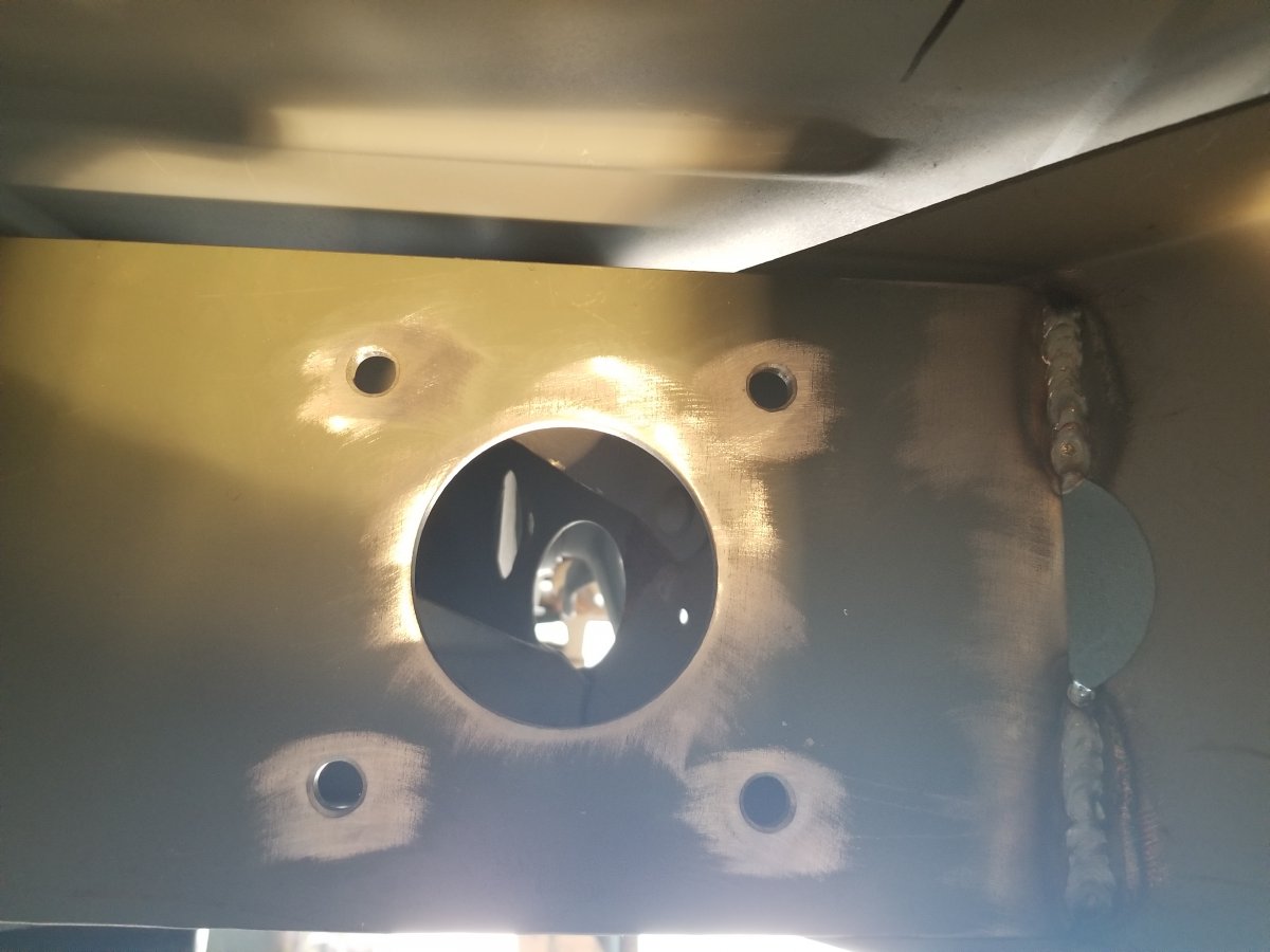

    Next task, seeing as its back on the lift was to finish mounting my brake booster... and make it actually work with the stock pedal location. I had made an aluminum template a long time ago so simply using my template made the steel plate. I knew from the start I would need an access panel when I set up the location I made it so that it was just touching the floor initially so that when I made my access panel I could make it raised for clearance. The original master cylinder mounts to the front... well making it mount the other way means that the clevis pivot is in the wrong spot, and seeing as id like to keep the grease zerk I need to rotate everything around , similarly to get the push-rod I'd also need to rotate the clevis's pivot to get it aligned with my hole... but all in all everything works just lovely now. 20180319_182451.jpg 20180320_105652.jpg 20180320_105723.jpg 20180320_133145.jpg 20180320_152425.jpg 20180320_153043.jpg 20180320_153103.jpg 20180320_155847.jpg 20180324_090441.jpg
