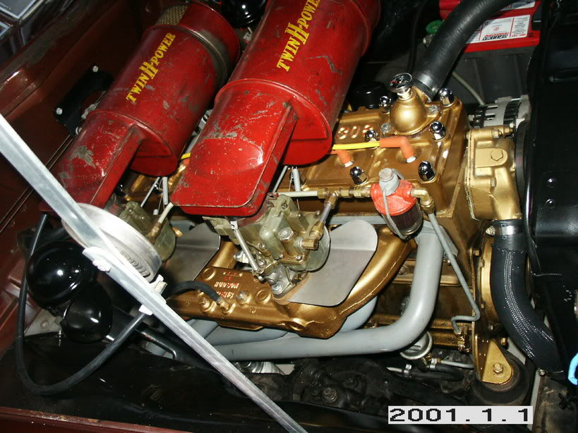

    Can't help you much with the transplant,my 49 Hudson has a 308 Hornet motor BUT my 65 Impala wagon has a 500" Cadillac so heres my take. It has been done because I've seen some for sale in yrs.past. Definitely going to need an Eldo rear sump pan OR just cut the sump off your pan and weld a cheap swap meet Chevy pan sump onto your rails. Stepdown has center pivot steering and that drag link which will have to be considered. Because the transmission cover unbolts and opens up half the firewall and a lot of floor it shouldn't be hard to mock it up in there. The frame crossmember at the firewall is an integral part of the chassis and will likely have to be modified.
    You could probably make it a drop out,just remember it is structural. I'm guessing the Cad has a long tailshaft t400 trans but I don't know were it will end up. The Hudson used a two-piece driveshaft and theres not a lot of tunnel there either so keep in mind driveshaft clearance through the rear suspension travel. You will find lots more info on specifics searching these
    forums: http://www.cadillacpower.com/forum/ and http://www.classiccar.com/index.php?option=com_kunena&func=showcat&catid=13&Itemid=152
    The Cad motor with an aluminum intake may actually be lighter than the big Hudson six(or L-8). Best of luck and keep us updated.
