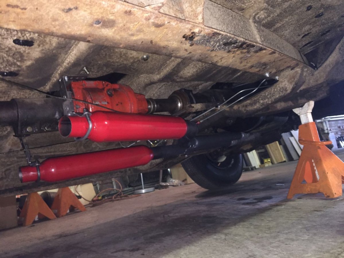

    You're already past the most difficult part of the exhaust system. Many stall out trying to get the headers pipes past the crossmember and all the linkage down there. From here back should be a breeze. May I suggest getting some pre-bent tail pipes from NAPA that will get you over the differential(what ever pieces look like they will fit), then start at the holes you've cut in your bumper for sections of straight pipe to provide perfect orientation and secure mounting. Then use whatever bends and short sections necessary to the connect to the tailpipes behind the differential. I'm guessing it will look killer. I bet it sounds great too, inline sixes with glass packs have a sound all their own!

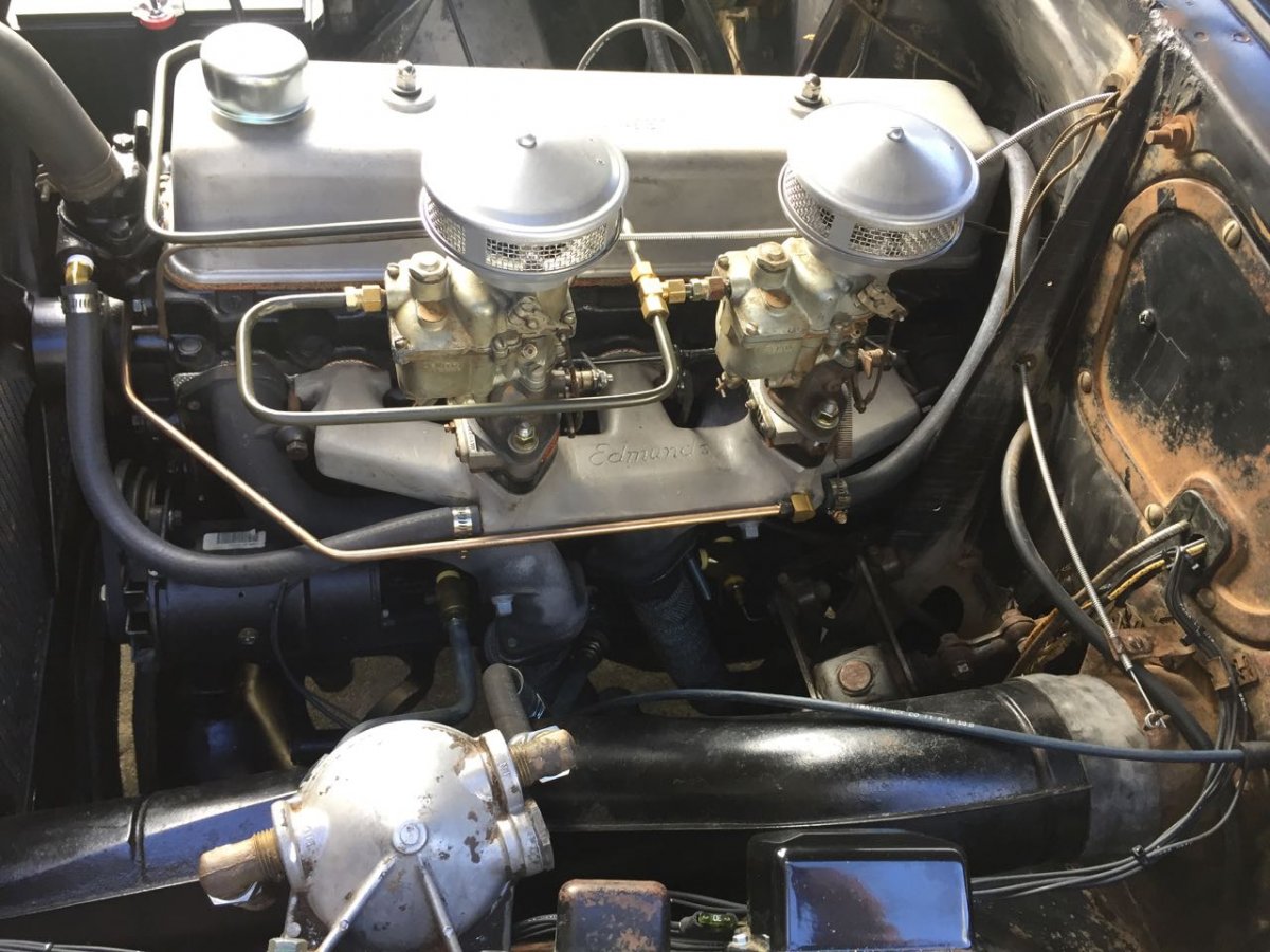

  2. Very nice! My old 52, 150 still had the 216/3 speed. 52chevy_1981.jpg
