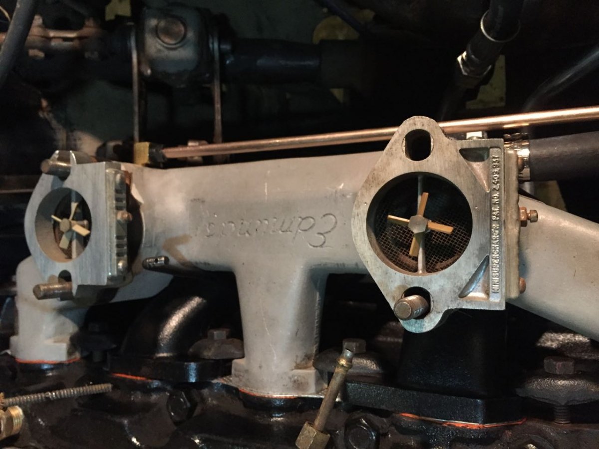

    Time for a quick update. I pulled the 216 and last weekend I got the 261 bolted in place. Its a stock full pressure 261 from a truck, circa 1958/59. I have put the car water pump on it, 12v generator, caw valve cover, edmunds intake, zenith carbs, fenton headers, reworked front plate for the 49 factory motor mounts. Still lots of work to do, build exhaust, work out remote oil filter, new pcv setup, 12V conversion, rewire engine bay, make throttle and carb linkages & fuel lines... you guys know the story :)
    Last year I busted balls to get the truckstell overdrive and interior sorted out to take it to the stray kat 500, this year I have the goal of taking it to the SK500 with the 261 powering it along.

    Hey Ricki, It's KB here! "Way To Go". Your dreams are getting fulfilled. I know it didn't just happen either. You have spent a lot of energy towards this end. It is rewarding for me to find a fellow traveler who can appreciate a "Truckstell OD". I'm happy you found a 261 for your rig, You'll soon find out what a difference 50 extra cubes will do. The torque from the longer stroke is impressive.
    You must be living right as well to score such gems as the Edmunds manifold and a pair of Zeniths. If your 261 is already drilled and tapped for a full flow filter your are double lucky. You may want to re tap and increase the line size for that oil filter if you want to use Fram spin-on adapter. With their adapter you can use an anti flow-back filter which prevents all the galleries from drain back into the pan, resulting in dry starts after setting overnight. I posted our setup on our Buick for "Devon" on his thread on HAMB. I wish I knew how to attach a link here so you can get the idea.
    You also want to fit your Edmunds with some water heat so that the fuel vapor stays in suspension for better distribution and smooth running. It makes a huge difference. I just used another loop of the heater feed using a military 302 thermostat housing that has an extra threaded outlet for a 5/8"hose bib.
    I welded a halfpipe of 1 1/2" Aluminum to the underside of the intake, capped and threaded each end for 5/8" hose bibs. If you go for water heat and can't find one of those "T" housings, PM me and I'll send you one.

    The valve cover is a cool piece. Its a "C.A.W" cover and has a small bit of writing int he middle of it. Cant remember exactly, but says C.A.W, Colorado, Patent Pending or something along those lines. Its a solid casting. Story is the guy owned a fleet of dump or garbage trucks and had these cast to quieten down the cab for his drivers. I like it as its a period piece, alloy and not ribbed, so it matches up nicely with the Edmunds intake.
    I'll search for the thread you mentioned for oiling. It already is a full flow motor and came with the external filter. (diverter pin is in, not flush). I reusing the original oil filter that I am relocating to the inner fender. It has the 1/2" npt oil ports. Right now I am building the exhaust, snaking it down and around, keeping in mind clearance or where I will route oil lines. I cannot come straight out on the rear line (oil in) as the handbrake mechanism cuts through there. It'll come out in the wash! I'll post progress pics when I get more done.

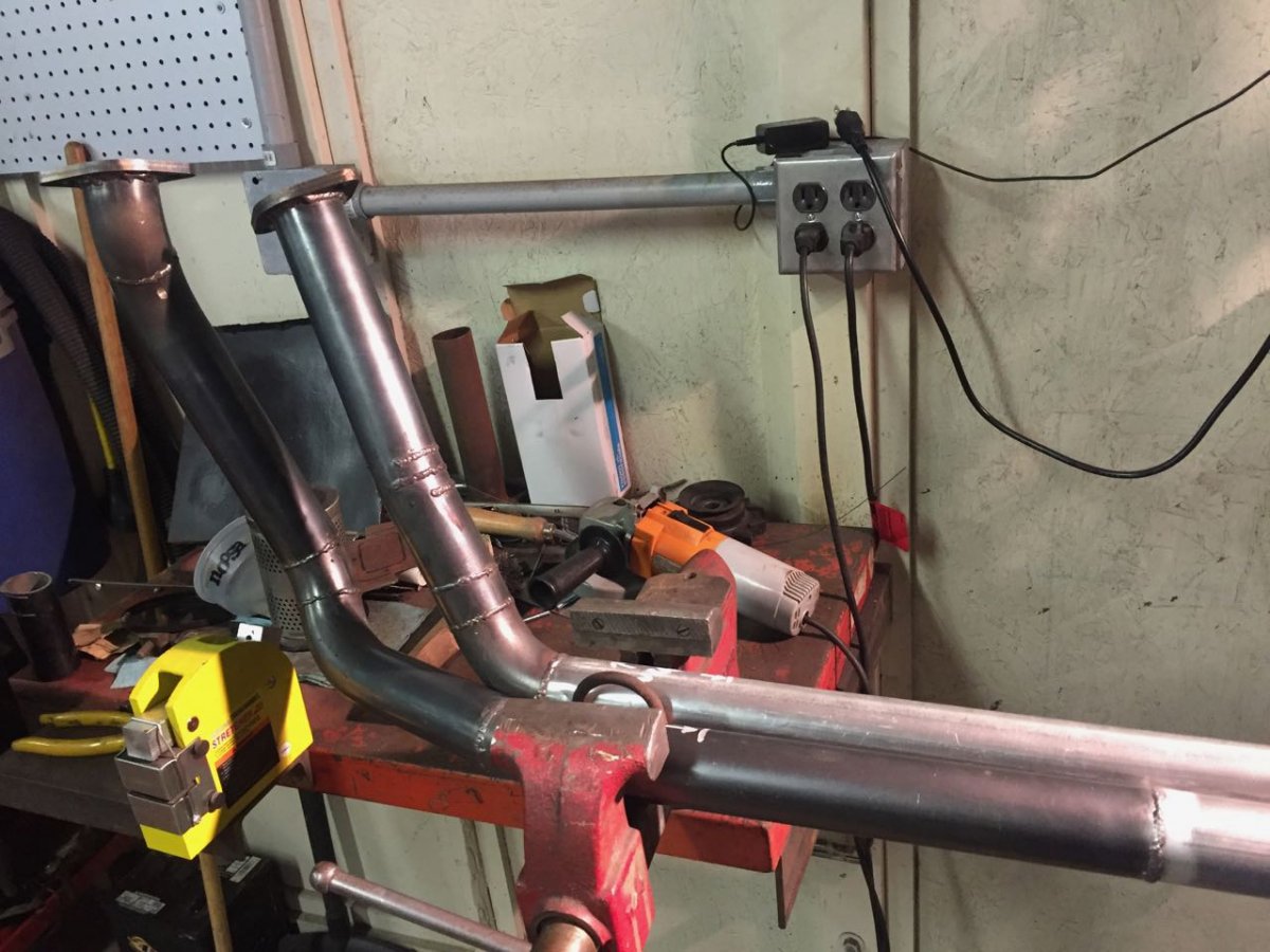

    So I missed my goal by a long shot, but not for lack of commitment and finally I did take it for its first drive in the weekend. Drove it to the Old Marais River Run in Ottawa, KS. It wasn't so much about the show, but the journey getting there!
    It took me a lot more hours than I thought as I do everything myself and I wanted to keep the 261 oil filter with the same style of hydraulic lines as they used in the factory, and also have the split exhaust, keep the 49 handbrake etc, there was a lot competing for that space and it took me days just to weld up the exhaust downpipes so they cleared everything, then days/maybe weeks to work out the oil lines and pipes, then more days to fabricate the carb linkages, fuel lines, battery tray, make up a pcv system, build more exhaust system etc etc.
    I rewired the car from the gauges forward as the old wires were fragile/brittle with too many bare patches. I used a modern fuse panel, mounting it to the back of the instrument access panel on the firewall. I converted to 12 volts and stayed with a generator and ammeter.
    I did manage to fit in dual "Mini Super Chargers" under each carb (I know they are gimmicky, but they are period and I figure they are a good talking point for the observant. At worst they must give me a small ram tube effect... right ?
    First impressions are that I really like the 261 ! It just wants to go and with the Zenith carbs having the adjustable main jets, I am dialing it in a lot quicker than the Sedan Delivery. More work to do of course, but this is good progress :) Next I will run the exhaust all the way out back, hopefully through the bumper somewhere / somehow, then finish off the interior and clock up some miles.

    Ricki, KB here, Glad to hear you got the 261 installed and running. Your Edmund and Zeniths is the perfect hopup intake setup to put on her. I like your "superchargers" too. I was intrigued with the ads for those in the back of magazines since I was a kid. I never could figure out how they could increase power unless those spinning blades help chop up fuel droplets into smaller particles. There appears to be some vents on the sides of each of those housings. Are they functional, adjustable or just for looks? I'm guessing you get a pretty good launch feeling now from the 261 with the 4.10 rear. Please be careful there, The torque of a 261 makes the tranny and the "U" joint the next week link. I hope you have the reverse gear OD cancel linkage sorted out. I have a kick down wedge, housing and cable for you if you haven't found one yet.
    You posted your next step is to run the exhaust out the rear. Are you using Fentons? Are you going for straight pipes or glasspacks?Smittys!

    Yes, fentons. I built the start of the exhaust, split into glass packs. It was a pain to thread the needle from the fentons down, around and under the car. Still need to finish off the exhaust. I would like to run the pipes thru the rear bumper, but not sure if I can pull it off. I'll attach some pics of building the exhaust and where I left off with the exhaust & car at the end of September. I had surgery in Oct so haven't been able to get back to it. Probably be March or April before this journey continues. I will email you when I do get to the kick down OD cancel. I know I have some of the linkage/mechanism, not sure if I have all of it or not. At the moment it is permanently set with a spacer.
