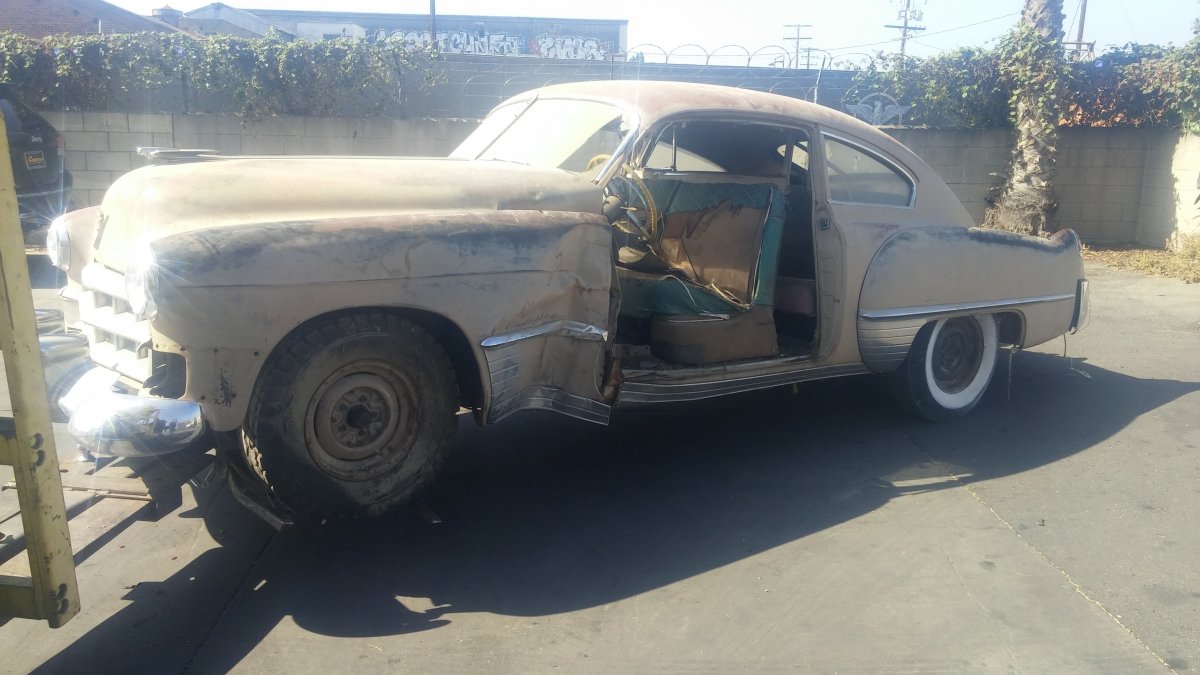

    Need any help or advice with this car. Has 16,000 original miles has not run since 1963 when it was involved in a accident or a motorcycle broadsided the driver's side. If anyone could help let me know where to start with the engine how to make sure it is not Frozen or that the transmission is still in good shape. Would love to bring this car back and see it on the road instead of it being parted out.

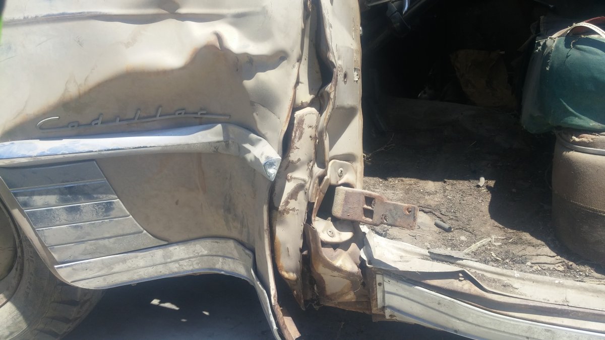

    also I'm trying to formulate a plan of fixing the driver side damage to the a-pillar I will try to include pictures on this post of the damage. The door was in no way salvageable so I bought a new driver side door Defender seems that it will be able to come back to shape but if need be I can cut out a firewall from a parts car for a couple hundred bucks. But I am just trying to get the engine going first thing

    I would highly suggest getting an experienced body man to fix or replace that A-pillar. It will be well-worth it in this end, considering how little you paid for the car you should consider the services of a true body professional to be affordable.

    Looks like the A pillar and cowl damage will be a pretty significant repair. Hopefully you can find a cheap donor car to pull parts from .
