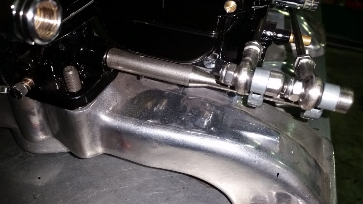

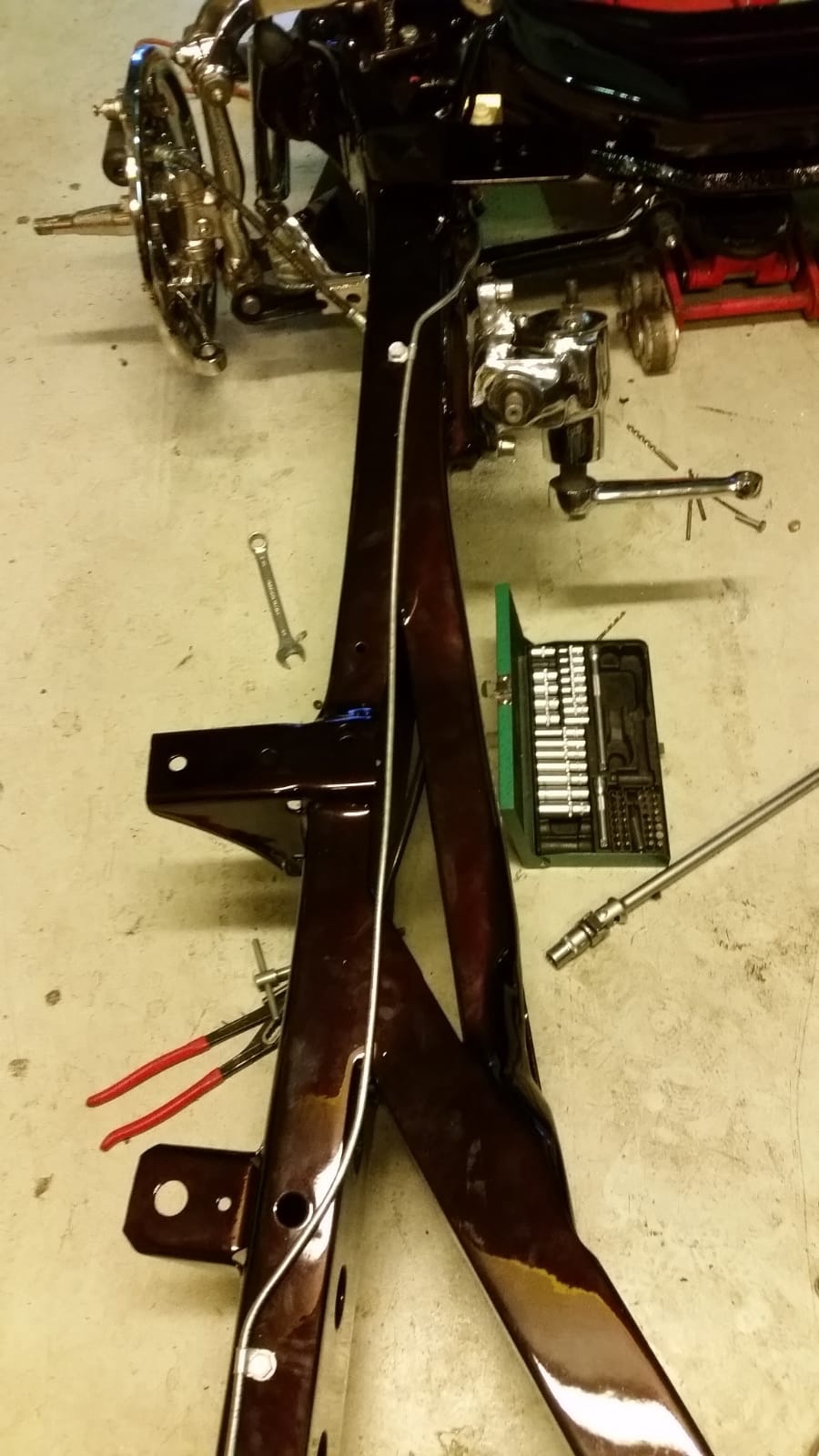

    Fuel line
    Inviato dal mio iPhone utilizzando Tapatalk

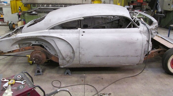

    And frame is ok

  10. Late to the Party
    Joined: Nov 16, 2015
    Posts: 870
    Late to the Party
    It's not OK, it's OUTSTANDING!

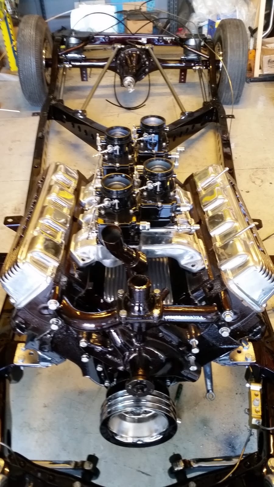

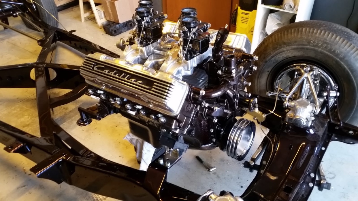

    Sone works, and this night engine on frame

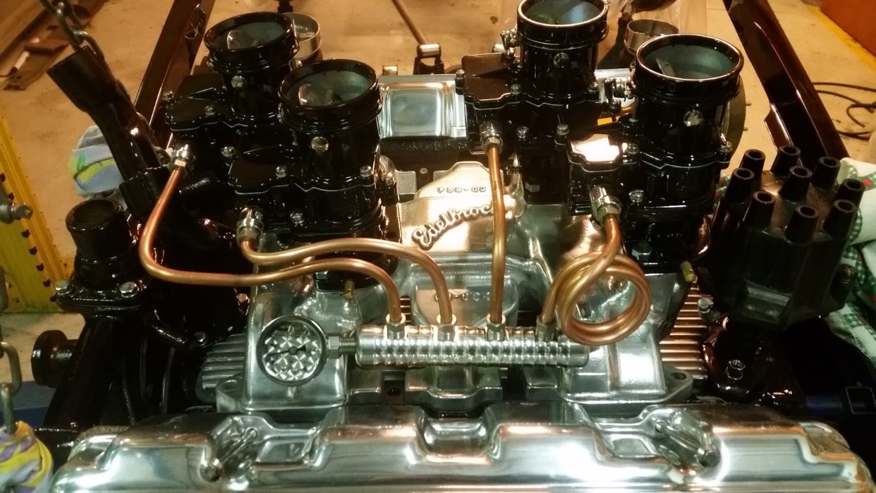

  27. martyk98
    Joined: Jun 12, 2006
    Posts: 112
    martyk98
    from washington

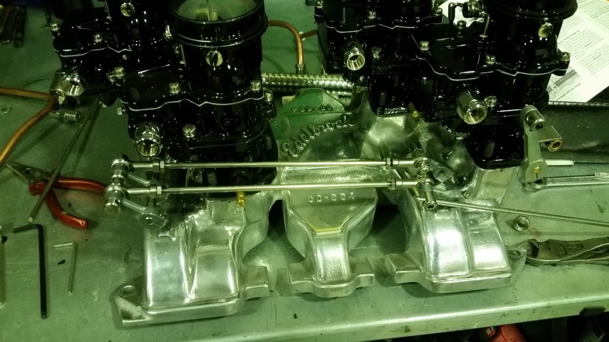

    Make sure you install a fuel pressure regulator in front of those Strombergs. Too much pressure will cause leaking gaskets.
