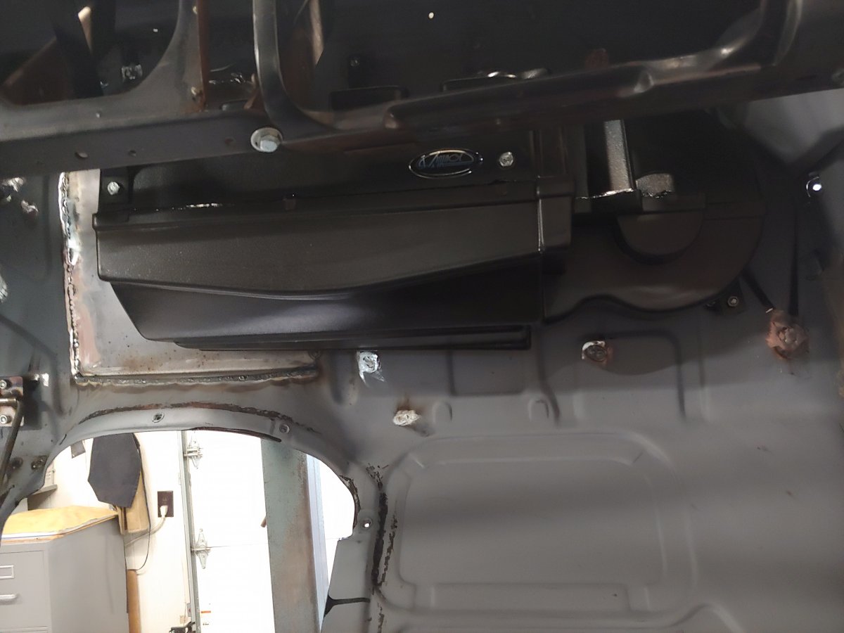

    Today, I made brackets and mocked up the SPW wiper transmissions. That turned out to be easy and this is the system you should use to replace the GM cable drives.
    Also, I've got my Vintage Air Super mockup case in place. Im glad I cut that hump underneath the dash out. It gave me lots of room. I will post pictures later.

    I bought the Vintage Air mockup case. You can lift it with one hand easily. It comes with brackets, so you can get all your mounting studs in the right place easily. Highly recommended for 55 bucks!
    As you can see, the Super fits very easily under the dash now that I made the firewall modification.

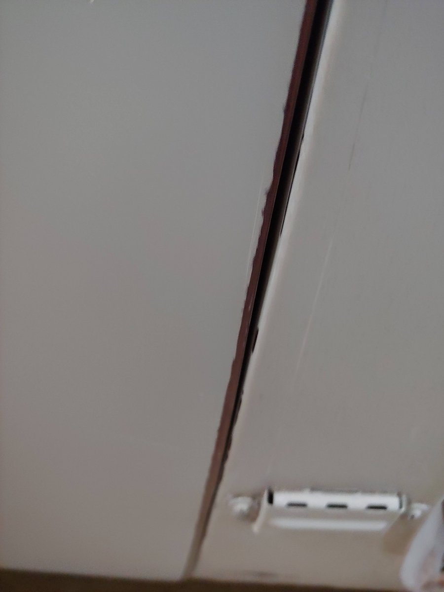

    I can't stand for bad door gaps, especially after I've put as much work into this Buick as I have. So, today I began reworking the gaps on the Driver's side door, which did not fit well at all. This door had wide spots and tight spots. We adjusted it as best we could, drilled 1/8" holes in the hinges on both ends to help relocate the door and then I set out to work to cut the tight spots down and reweld them and to weld in a 1/8" welding rod in the wide spots. Go slowly with the welding and don't get the door hot. Do a tack, move a couple of inches and do another tack, etc. As you add more, always let it cool between tacks or you risk ending up with a mess.
    Also, I used a trick my buddy Richard told me about for trimming the tight spots and cutting down the rod at the ends. I used masking tape to establish where I would like my edge to be and then I took a magic marker and marked the exposed area. I then removed the tape and ground to the bare edge of the mark. This is easier to see and won't get hot and slip. This is a LOT of work but I feel it's worth it to have a door, trunk lid, etc that fits. It's also a lot of grinding and a lot of mess. Enjoy!
    Door gap 8.jpg Door gap 7.jpg Door gap 6.jpg Door gap 5.jpg Door gap 4.jpg Door gap 3.jpg Door gap 2.jpg Door gap 1.jpg
    chryslerfan55, pwschuh, 40LUV and 5 others like this.
