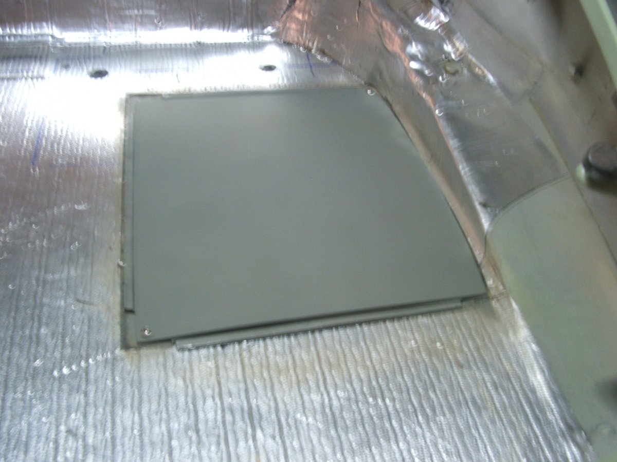

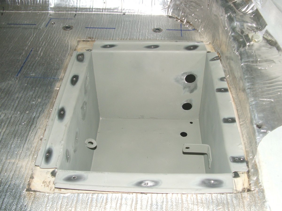

    I did get around to finishing the sunken battery box in the trunk. Actually, the hardest part was getting the insulation/sound deadening back off the trunk floor where I wanted to put the box.
    I am using a side post battery and after setting it in the old Porter Cable tool box I had a couple of inches excess height so I squared up the box and cut down into the four corners one inch. Bent the edges over and shot a coat of self etching. The rod in the picture is used to hang the box for paint. I will close off the holes I drilled when I was going to set the box above the floor later.
    I marked the trunk location for the box drop in, cut the hole 3" smaller on each side, angle cut out to the edge of the box size markings and bent each side down do I had extra support on the side. I will spot weld these to the sides of the box as well as the tabs on the box to the floor. This may seem like overkill but the battery weighs 50 lbs. so better safe than sorry.
    Drilled new cable holes in the front end of the box, dropped it in and spot welded it in place.
    Plugged the original bottom cable holes by adding two straps on the underside for added support and added another coat of primer. Then I glued a 1/2" piece of insulating rubber along the eventual terminal side to prevent arcing.
    The box had a 1/8" lip on three sides at the top so when I bent it over I had a retainer for the top I made out of 16 gauge. I thought about putting a couple of beads in the top but it seemed pretty strong so I left it. A sheet metal screw in two of the corners should hold it in place.

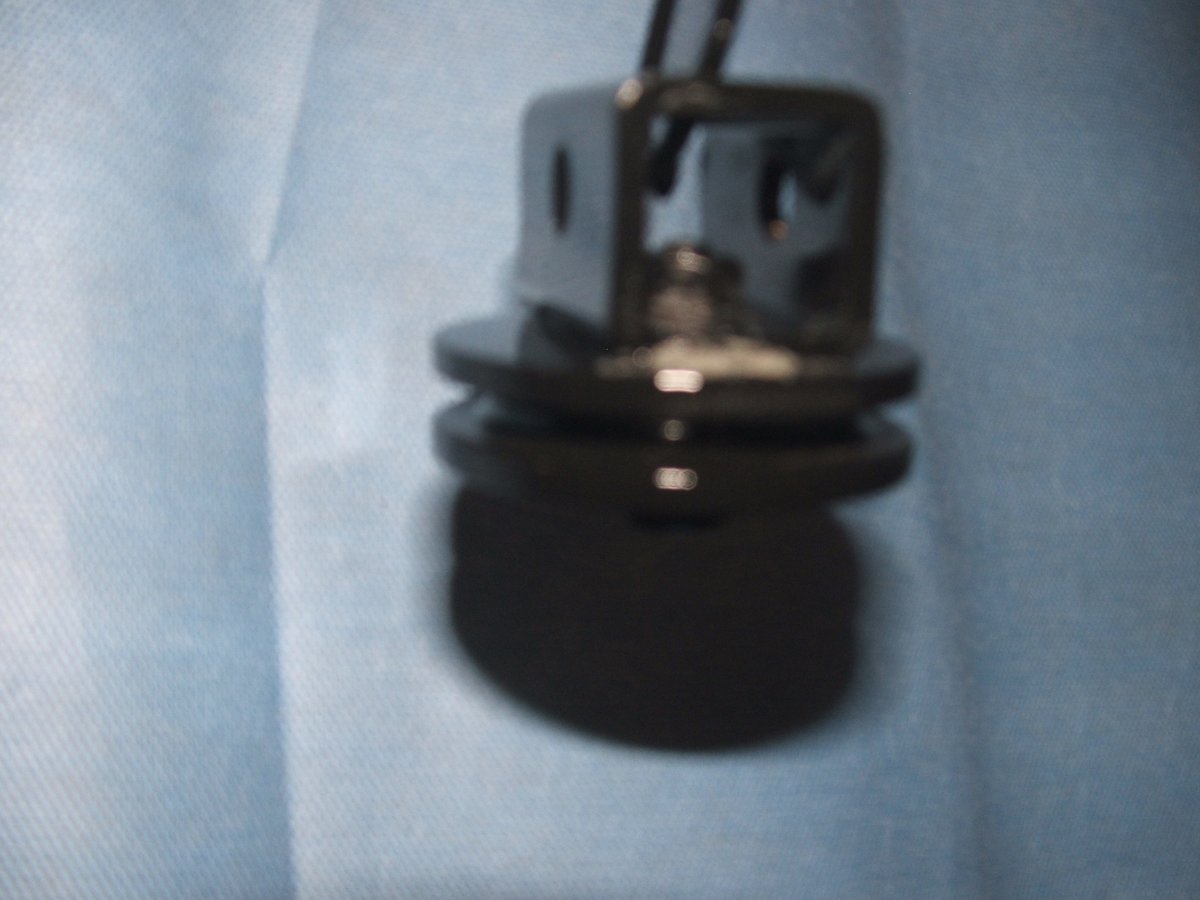

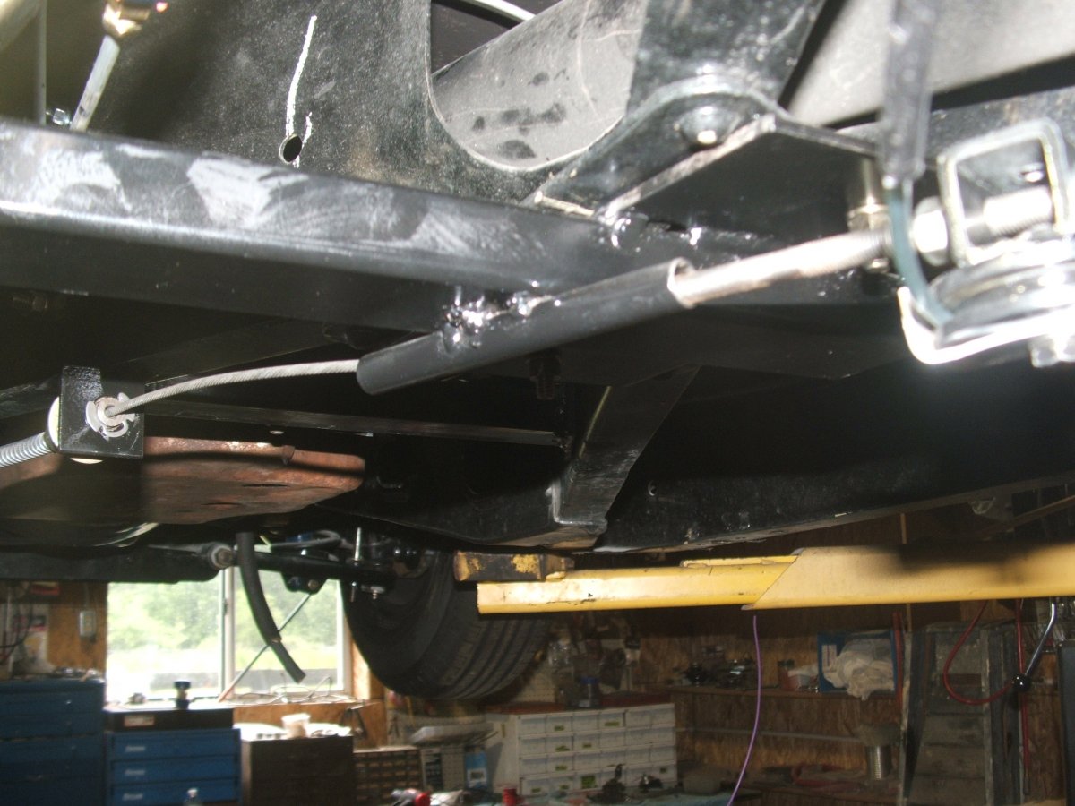

    So, after rummaging around several scrap piles and drawers I found enough parts to fashion the emergency brake set up. I think I mentioned previously that I had a late 80's early 90's Caprice rear end with drum brakes which I had rebuilt a couple of years back. I had put new emergency brake cables in at that time. I just had to figure out how to mate them to the original 49 EB foot activated cable. I found a small pulley in one pile, some angle iron, round tubing and 1" square tubing in another pile. I cut off a couple of inch and a half wide pieces from the angle iron for cable stays (I'll come back to that), a 6" piece of the round tubing for a guide for the original threaded EB cable end and a short piece of the box tubing to use with the pulley. DSCF2244.JPG
    I drilled a hole in the pieces of angle iron the same size as the cable stay ends and welded them to the X member on each side to hold the rear cable housings in place and allow for tension to be applied to the inner cable.
    Then I drilled a hole through the short piece of box tubing to run the threaded rod on the end of the original EB cable through and bolted it to the pulley. By connecting the cables from the rear drums and wrapping them around the pulley and then putting tension on the rear cables by running up the nuts on the threaded cable from the foot pedal I could adjust the EB.

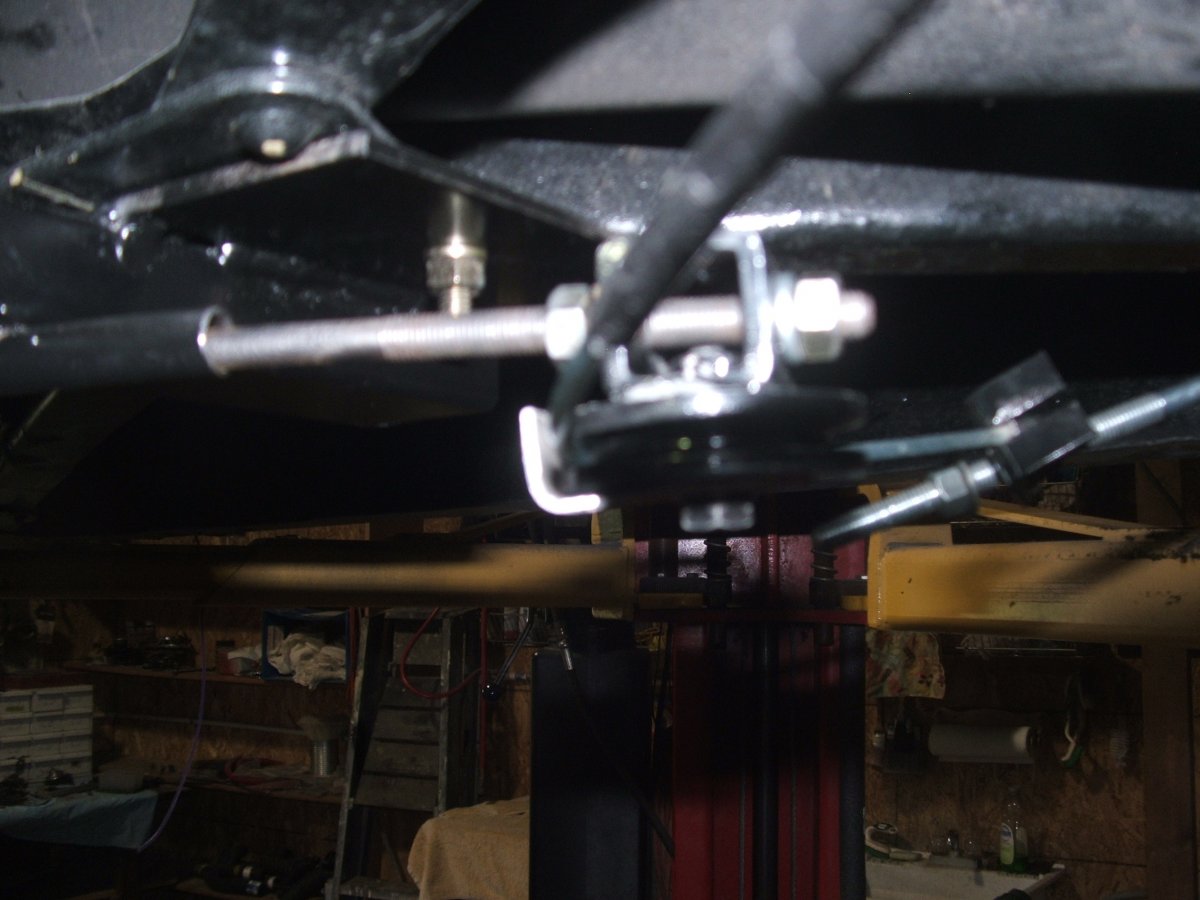

    DSCF2246.JPG I had cut another piece of angle iron to make a stay bracket for the original EB cable (you can see the push keeper that holds the cable to the bracket) and then welded (not my best work) a piece of tubing to a cross member to act as a guide for the threaded end of the EB cable that allows for adjustment in the tension. You can see the pulley and adjusting nuts at the far right.
    A little better picture of the adjuster and you can see an aluminum keeper I added to hold the rear cables to the pulley.
    Since the original EB cable that hooks to the foot petal was to long and I couldn't cut off the threaded adjuster end shown above, I had to cut the cable at the foot pedal end and make a cable stay that slides over the cable and is held there with a couple of set screws.

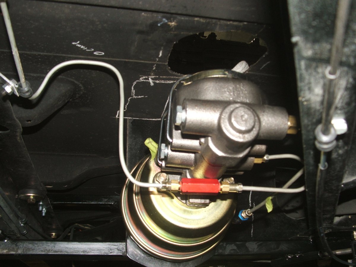

    I did get the lines run to the front disc brakes. I already had the back drum lines in place. Because of all the stuff on the left (drivers) side of the frame: gas line and return line, steering shaft, eventual exhaust pipe, and a sway bar mounted on the back side of the A-arms, I routed the line from the MC to the front brakes on the right side frame, crossing over the top of the X member and up the frame rail placing a T fitting forward of the A-arms with a line going across to the left side caliper.
    This is a view from the rear end. The line to the rear was bent to go up and over the eventual exhaust pipe on the left side. The brake pressure valve was plumbed on the line going forward to the calipers. You can see the access hole above the MC.
    This is what it looks like from the top side. Not a great picture because of the flash back from the reflective floor insulation. Remember, from earlier posts, that the MC sits back a ways so I could access it from behind the front seat.
    After a lot of bleeding and tightening the various line connections I have brakes.

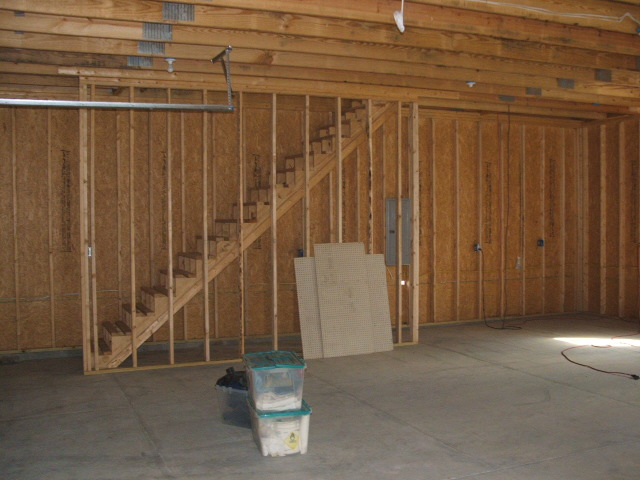

    OK, it's been a long six months since last posting. Sold our house, downsizing, move all taking time from the shop. New house didn't have a shop. Luckily buyer let me rent back majority of shop till June 1, 2020 while I build one at the new house. Picture of old shop. DSCF2032.JPG DSCF2034.JPG
    Sold the wagon, so down to three. 33 Dodge couple is running but needed to get the 50 Ford ready to move by the June 1 deadline so recent effort directed there. Spending two mornings a week working on 50 and back on the Buick wiring one morning a week. Rest of time on new house and shop build.

    As mentioned previously, most of my time now is devoted to work on new house, getting ready to build new shop and getting the 50 Ford project back together enough to move. I have been taking pictures of the 50 Ford progress and will start a different thread on that later.

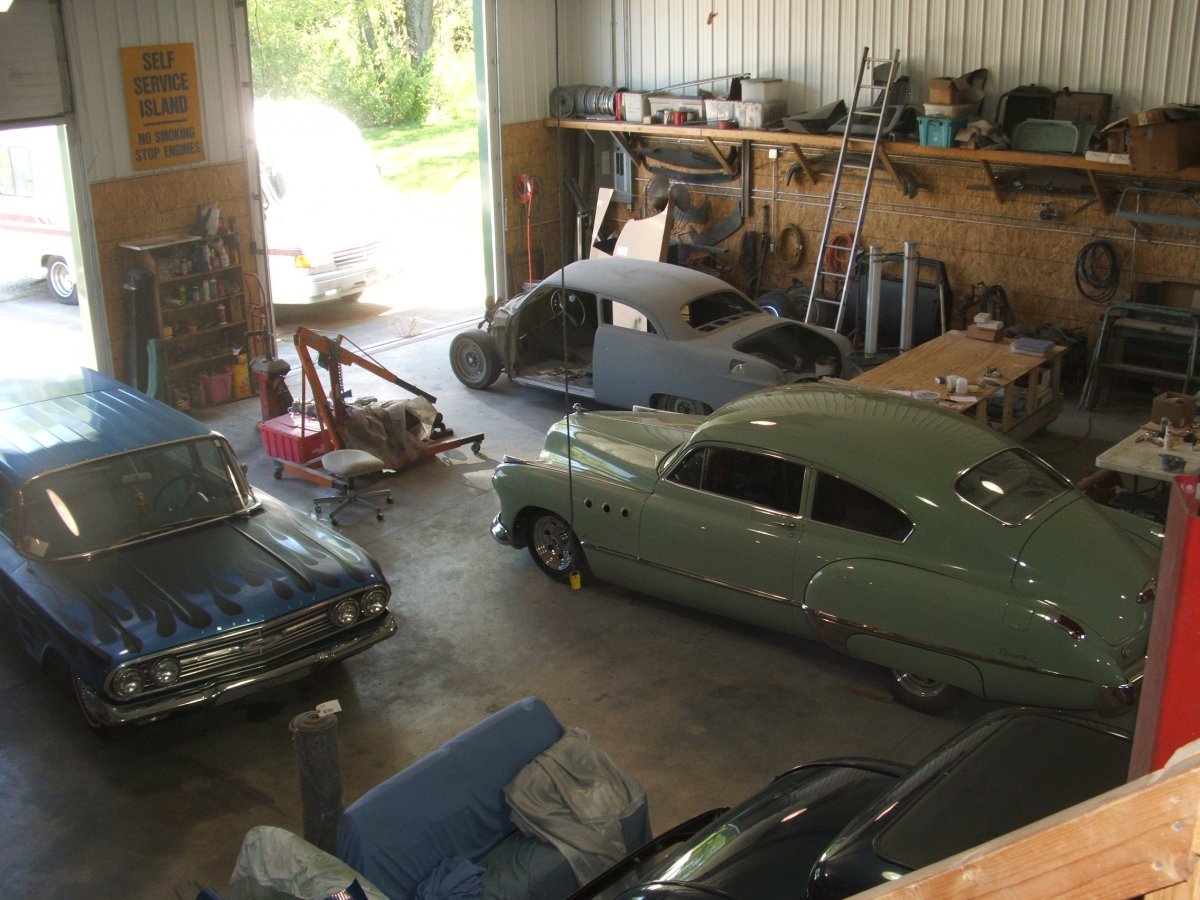

    Finally finished the wiring. As mentioned earlier it's been slow progress with the move and building a new shop.
    A lot smaller than the old one but the days of 4 or 5 projects going at the same time is probably behind me.
