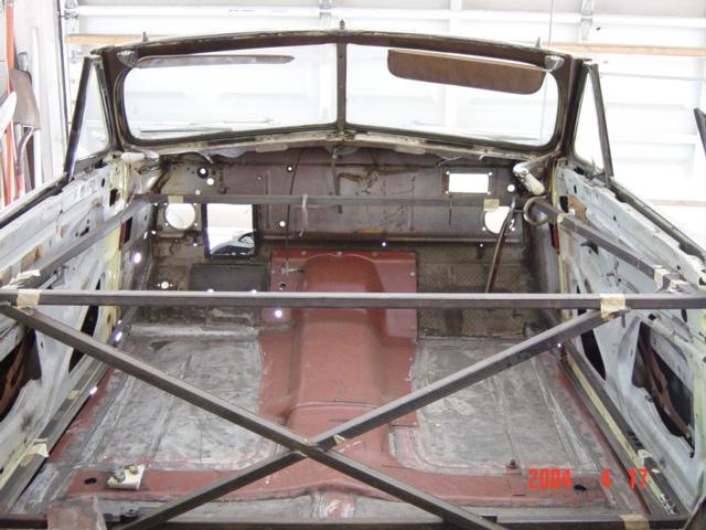

  19. Having trouble removing the dash of a 1951 Merc. Any suggestions very much appreciated.

    You have to first remove the 2 threaded bolts (one on each end of the dash) that screw into the inner metal kick side panel. Then remove the windshield garnish molding. Then remove the sheet metal screws that secure the dash to the windshield metal. Also, unscrew the speedometer cable and disconnect or remove all the E-brake cable, the vent cables and all the other little accessory cables attached to the dash. The radio can stay in, but it's heavy. Easier if you remove that first. Also, you will have to remove the steering column "U-bolt" that attaches to the bottom of the dash. It's also easier to remove the dash if you can remove the steering wheel and drop the steering column down.
    The metal bracing you see in the photos WAS NOT need in order to remove the dash.
