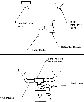

    In my car I have 2 switches that will turn on the factory installed Cabin Heater Fan and/or Defroster Fan units.
    The Defroster Vents and fan units are in under the dash, however the piping between the vents and defroster blower is missing. So far, I have not be able to find an illustration or other means to tell what this piping (or plenum) is suppose to look like?
    I plan to go the hardware store and buy a reducing Tee (2-½” to 1-1/14”) and find some king of tubing to connect it all up. (Swimming pool, sump-pump or vacuum cleaner hose possibly or some other thing.)
    I think it will work, however I would like to have the original piping? Does anyone have the info to help me replicate the original stuff or know where to get it ?

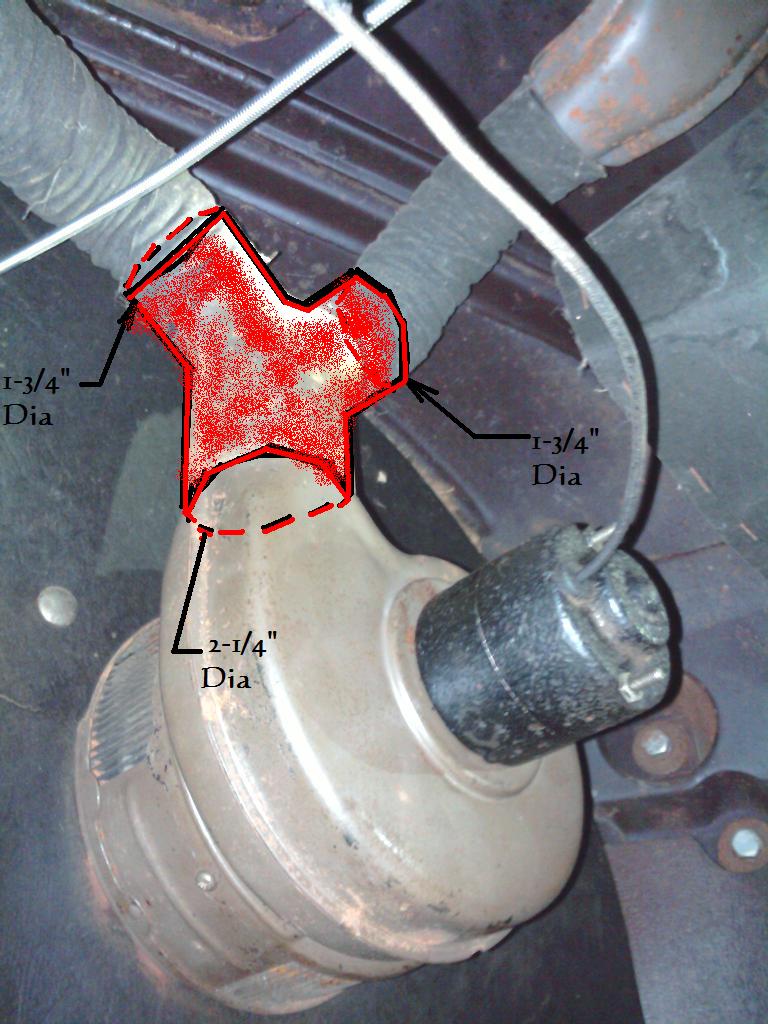

    I get a message from a fellow delivery owner and friend Monkey_Spunk and he was kind enough to climb under his dash and snap this photo for me. Outstanding!
    As he explains, the Y-pipe fits directly on the blower, and the two hoses each go to the defroster vents. No screws or fasteners, it just all slips together without an problem.
    Chevyfordman, you nailed it also, and now I can see exactly what you meant.
    Now the issue is, where can I get one?
    Thanks guys! :)

    A fellow member wrote to me asking for more detail about the fitting I need. I thought I would post my reply for inquisitive minds.
    The piece is “Y” shaped. It fits directly on the blower. (See photo I colored it red). It has two openings at the top of the “Y” that are 1-3/4” diameter. (the hosed fit on to those) The bottom of the “Y” (which fits onto the blower) is about 2-1/4” in diameter.
    Thanks! :)
