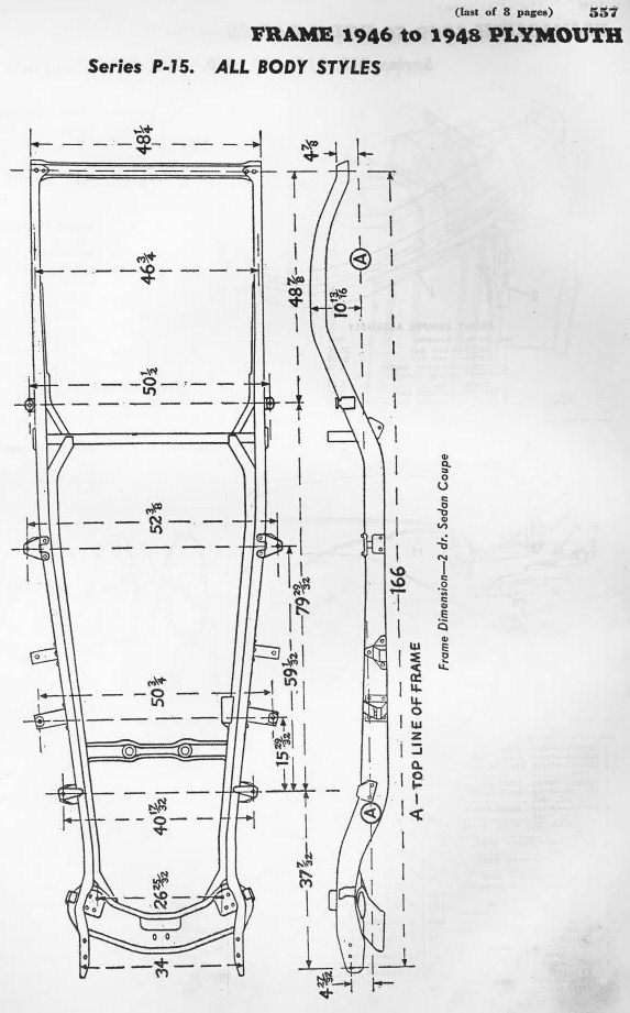

  7. MoparFinman
    Joined: Feb 6, 2011
    Posts: 333
    MoparFinman
    from Okla

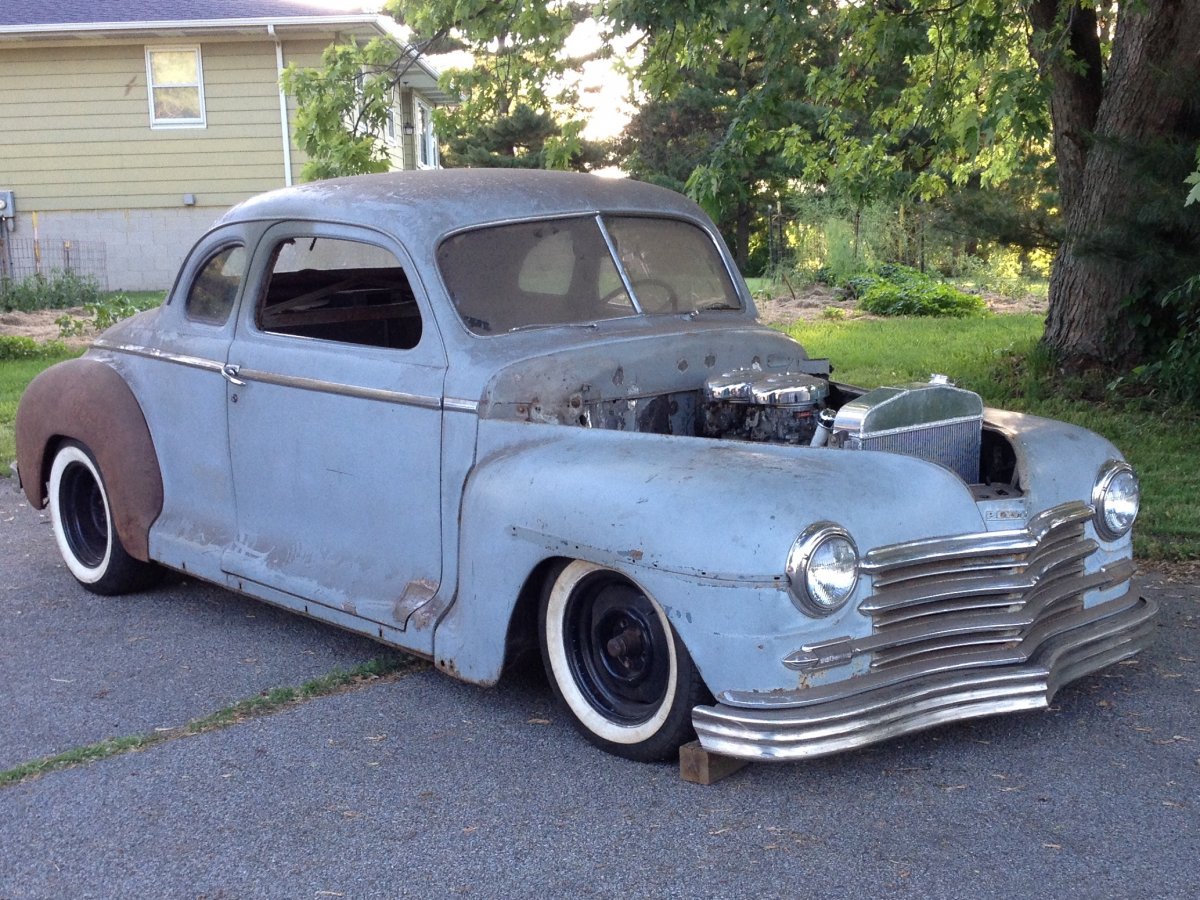

  12. Just to confuse this a little, what the hell is this?:D
    VANDENPLAS and treb11 like this.
  13. George
    Joined: Jan 1, 2005
    Posts: 7,242
    George
    appears to be a 46-8 5 window coupe.

    1946 to1948 with modified '49 Plymouth front bumper and '42 Plymouth rear fender.
    Sent from my SM-T350 using The H.A.M.B. mobile app
