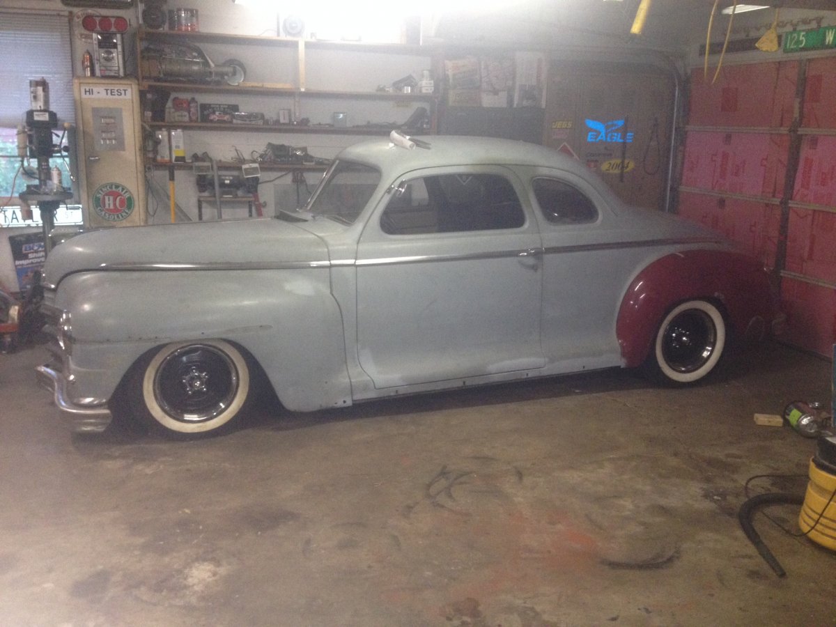

    Thanksgiving morning I purchased a '48 Plymouth club coupe. It is an older restoration, all stock except '50 Pontiac tail lights and dual exhaust. I will post my progress here, this first post will get caught up to where I am currently.
    I have 2 young sons, 5 and 1, so my goal is to have this car reliable and (reasonably) safe to take the family on cruises and to car shows so that they can grow up with good memories and productive hobbies, even if the rest of the world is on fire.
    Car runs and drives fairly well, but needs some electrical work, a thermostat and most maintenance to be done. Horns were disconnected, and sound when connected. Relay is dangling with one wire broken off where it goes into the bottom of steering box.
    Once I got it all hooked up, horns gave a few half hearted 'toots' then sputtered and stopped.
    Heater, radio and clock don't work.
    Brake light was replaced with an LED one, but never wired up. It is 12V unit, it seems the company that makes them are out of business. I installed the sedan bezel and light that came in my box of parts to find that 1. It fits terribly 2. Brake light switch is bad. I found an adequate Coupe bezel on Craigslist out of state, and a good friend of mine picked it up and shipped it to me.
    I haven't installed the switch yet, but will do it very soon, when I flush out the muddy river water that is serving as brake fluid.
    I have gathered some wiring diagrams and bakelite terminal blocks, and will be organizing the underdash wires and getting the brake lights run through the blinker switch-making my taillights also serve as stop lights.
    While I like the look of the pontiac lights, they don't leave room for the stock style reverse light. I will have to see if car is wired for one, but I would like to have something to indicate to others I am moving backwards...maybe a beeper!:lol:
    Any ideas of how to add a nice looking revers light?
    The Mopar style wire wheels with shorter radials are very nice but car also came with a set of original wheels with good radial white walls that I actually like the looks of better. I will run the aftermarket 'Lancer' style caps that came with the car.
    My box of parts also included a piece of trim to shave the hood ornament with (bolt on replacement). I guess it is a 'JC Whitney' type piece. Unfortunately it doesn't fit very well, and paint under hood ornament was never buffed and looks bad.
    I have been trying to decide if I like the fronts of these cars shaved and decked or not.
    The package shelf behind the rear seat had been covered in black vinyl when the car was restored in the mid-late '90s. Rear window gasket looks to have been replaced at the same time, but had split at the bottom middle where it had been bonded together, and leaked. This ruined the cardboard under the vinyl.
    I took it to work and was able to whip up a fresh cardboard card for it, plush it up with some sheet packing foam, and get the vinyl wrapped back around it. It seems that one of the layers was possibly the original cover, it was a light colored, woven fabric with a soft fuzzy feel to one side. I left it out, due to how deteriorated it was.
    Got it installed when I got home, and filled the gap in the rear gasket filled with some black RTV.
    Went and picked up the spare engine/trans that came with the car. Unfortunately, no overdrive other major goodies, but has a clean carb on it, all the oil filter tubing and bracket I was missing, and a very clean fuel pump. Cylinder head is cast in 1952, #1405849-10 but engine number is p15 798272, scratched into the pad. It doesn't look like the number stamping on the other engine. Engine is painted silver, but in the grime under the valve covers the block is blue, oil pan is black. After a little investigation and a chisel to the number pad, the tinfoil And Bondo came off to reveal a different number-p24*i6364i*
    A 1953 Plymouth engine. Should have stronger camshaft and 7.1 Cr head. A good core for my future 230+" build.
    While trying to fit a thermostat, I started down the " this needs fixing too" rabbit hole, finding the generator slide bracket cracked, the belt frayed, the water pump nearly
    seized, the lower generator mount missing a bolt ( no wonder it was wobbly), may as well get fresh radiator hoses, gee that radiator has some cracks....
    Most of the bits are now bead blasted clean and repainted, waiting to be installed, But...
    So, with coolant out, I should just pull the head to have it milled for compression, right? It would be nice to have the T-stat pad milled clean as well...what do y'all think?
    Risk taking apart a running engine?
    I am planning on pulling the oil pan and valve covers to dump out the sludge before installing my new old stock Purolator oil filter and switching over to detergent oil.
    Oh and late January I have a dual carb intake set-up coming, from one Mr.Asche.
    To be continued.
