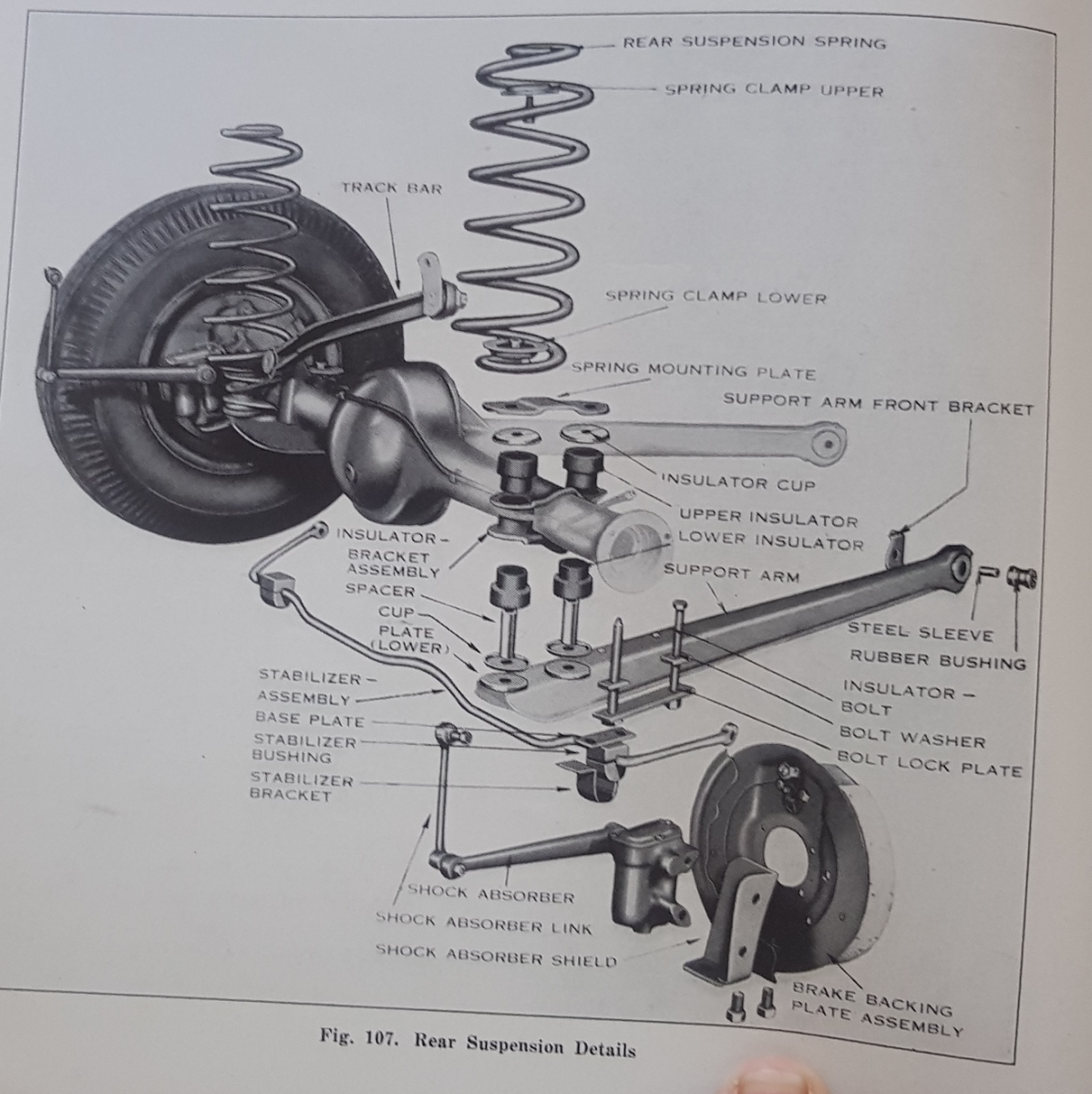

    The Olds had angled pads with large bushing (2 x each side) that bolted to trailing arms, what body is yours; A (66), B (76) or C (98)? Here's a copy from my 46 Master Parts catalogue and Shop Manual as I couldn't remember being that I pulled mine out that long ago. The coil spring is tapered top and bottom and held on by a large HD washer so you'd need to have short coils made or swap in later GM coils. I recall that when out of car they are quite tall when not compressed.

    There you go, Marty gave you the springs and the gent from down under has the nice diagram. I remember that in the mid 80's when I was teaching auto shop one student wanted to lower the rear of his car and the other wanted to jack the rear of his and I mentioned trying a spring swap and they both got what they wanted. It might be trial and error or getting into a spring catalog and checking heights but it should be reasonably simple.
