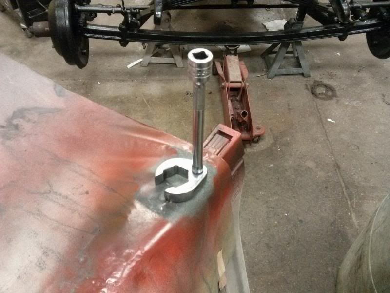

    On a separate task I've been checking all of the suspension and frame nuts and bolts to make sure they are securly fastened. My only question is how tight do the U-bolt nuts need to be? I'm assuming they need to be "good'n tight" but I have no way to use a torque wrench because either I don't have a socket deep enough or I can't access the nut with a socket. I had to use a combination wrench and got them as tight as I could by "hand" and then add my "persuader" (other wise known as a big ole pipe slipped over the wrench for added leverage) and gave the nuts a few more turns.

    Just remember, tight is tight, too tight is loose again.

    Sorry, for some reason, my dad lives in my head at times. And I am lucky enough to get that speech every time he is around and I use an extra pipe or wrench for leverage. I did just that today for his response to your post. He brought me this combination and he said "everything has a torque spec" "sometimes you need to use what you have to reach around things" "Quit hitting that wrench with a hammer!" 6 inch extention and a crows foot worked.
    Hope this helps. Again, sorry for sounding like a smartass, but it's how I grew up.
  27. No need to apologize Tantank. My dad's teachings ring in my head as well.
    I listened to my concerns over using the breaker bar and didn't take it too far. The last thing I want to do at this point is break anything.
