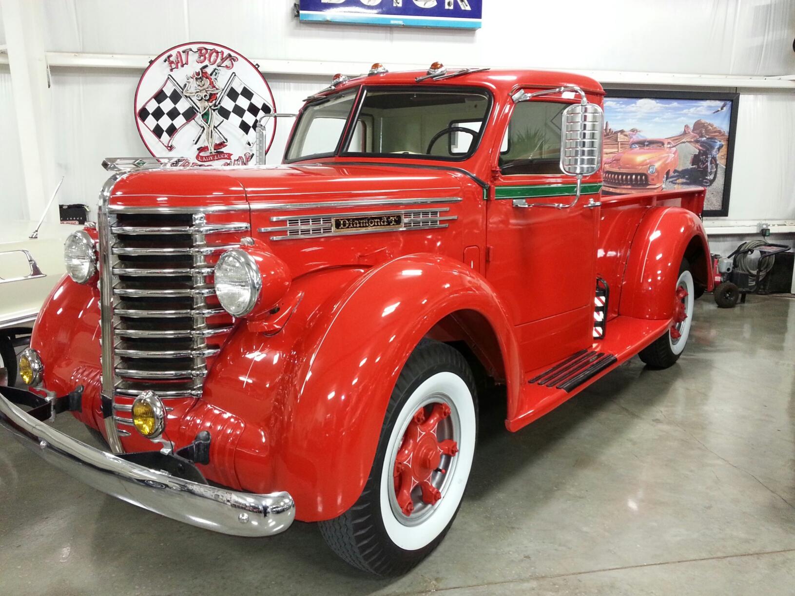

    I have a customer who has just bought a 48 Diamond T pick up that has the warner T9 tranny.
    He is having problems shifting this thing , it grinds on every shift and when you first put it in low gear when setting still.
    It will grind the first time you put it in low gear but then you can move the shifter in and out of gear with no grinding but if you cycle the clutch pedal up and down it will grind again one time.
    Now this is a up coming project so a couple questions (trying to do my home work)
    1) is this a synchronized tranny
    2)what gear oil would it use
    Now the plan when I get to it will be to
    1) double check the clutch adjustment
    2) drain and inspect gear oil then refill with proper gear oil
    But now I have been thinking that maybe its a problem with the pilot bearing,
    Any thoughts Thanks James

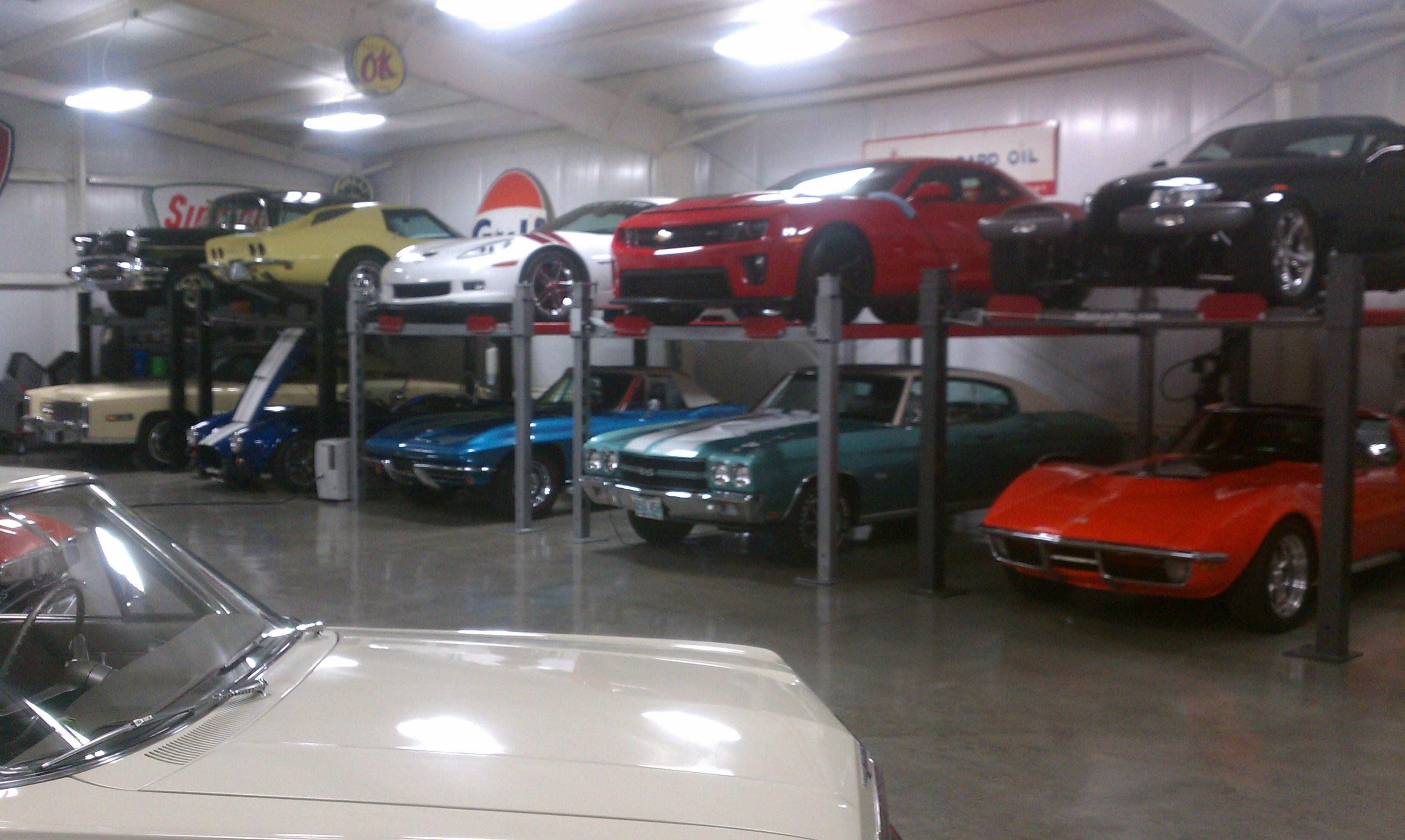

    The truck was acquired in a trade with the guys at Fast Lanes out side of St Louis.
    I have not had the much time to spend with the truck yet.
    I think he did a good trade. traded a Prowler for it.
  17. cmyhtrod
    Joined: Nov 29, 2008
    Posts: 360
    cmyhtrod
    from ct
    A Prowler?
    Yeah I'd make that trade too.
  18. flynbrian48
    Joined: Mar 10, 2008
    Posts: 8,246
    flynbrian48
    Yeah, even if he swapped 3 or 4 Prowlers for it. Those 201's, in the condition of the one you posted, are trading for 6 figures. Pretty truck.
  19. saltflats
    Joined: Aug 14, 2007
    Posts: 12,602
    saltflats
    from Missouri
    I know he paid some boot but I don't know how much but it sure help the ambiance of his car barn to that thing out of there.
