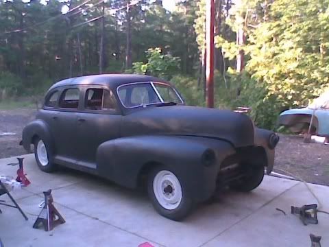

    Ive done alot of progress in the last few weeks. Ive Rebuilt the Brake system (new lines, wheel cylinders, shoes, ect) and works like a charm. Threw a coat of primer on it, and gonna get ready for a topcoat soon. but im now im trying to get the motor running smooth. Put new plugs, wires, and points, cap and rotor, and battery. Its starts up fine idols okay, but as soon you give it some gas its starts to miss bad. So i ran a compression test and 3,5,6 cylinders are 65 to 75 pounds. think if i take the plugs out and soak some Marvel Mystery Oil it may free up maybe a sticky valve?
